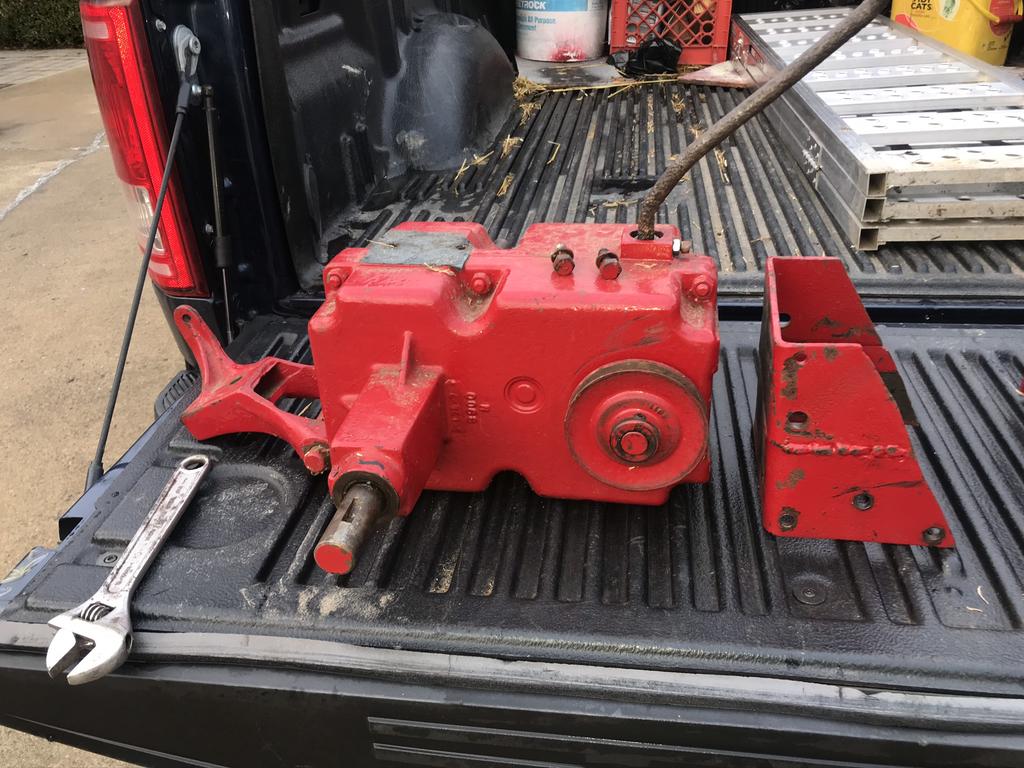

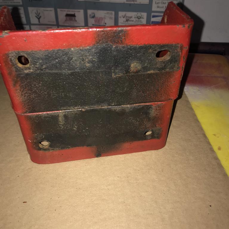

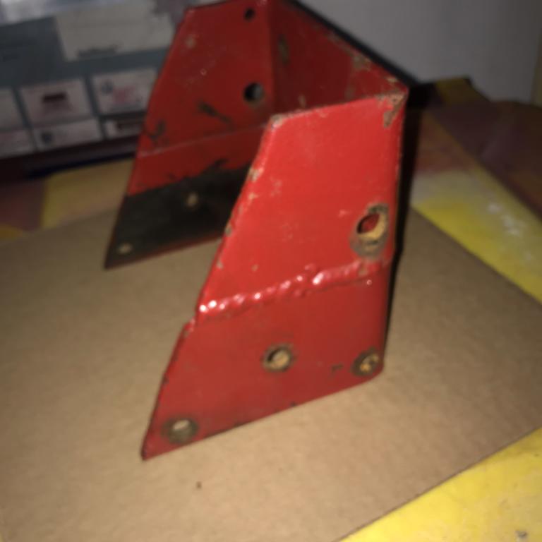

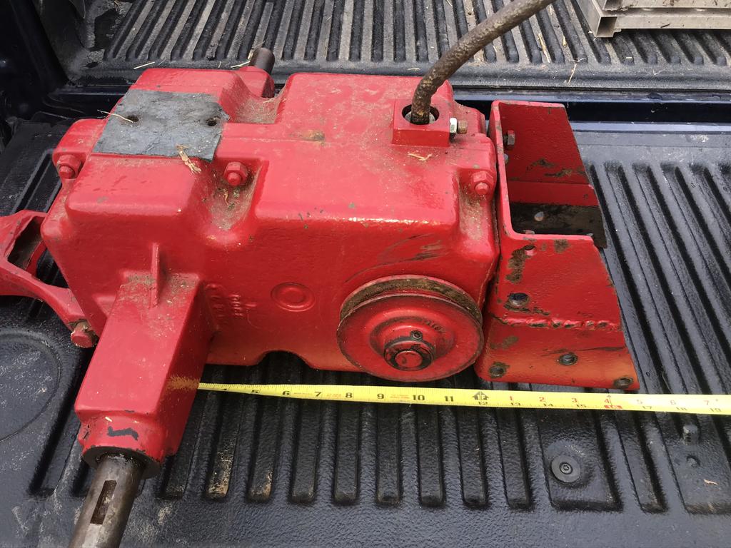

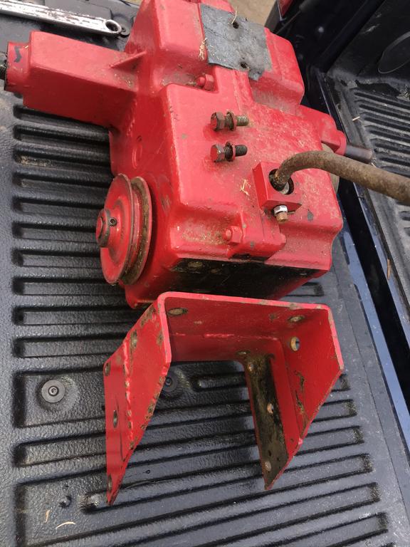

Lane Ranger 12,159 #12 Posted March 5, 2020 (edited) One thing you could do to add a different transmission to an RJ or Suburban is add a front face plate to the transmission that would mesh the two pieces to the frame. i bought two transmissions in West Virginia in January of this year and one had a plate fabricated in front to fit a two piece Wheel Horse transmission to an RJ or Suburban frame. Your clutch rod and hookup would have to be fabricated most likely to conform with the new transmission. Edited March 5, 2020 by Lane Ranger 2 Share this post Link to post Share on other sites
