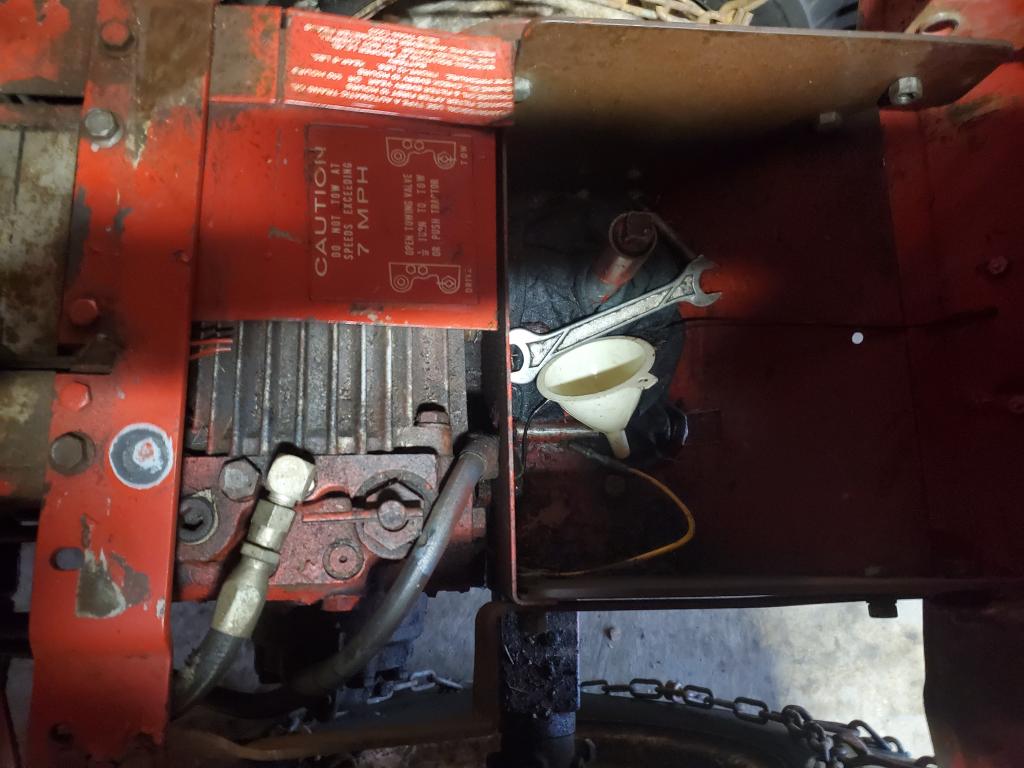

Oldskool 6,678 #152 Posted March 2, 2020 When I go to get the GT do I have to disengage the trans for it to roll? If so how would that be done? Share this post Link to post Share on other sites
12Horse Paladin 1,038 #153 Posted March 2, 2020 (edited) If it works like the auto i have, lift the seat, and youll see a little bar. Mabey the sticker is there. Its called the tow valve...turn it 180 degrees, and the wheels will turn freely. As you look towards the back of the tractor, itll be above and to the right of the filler neck where you add fluid for the tranny... Ill see if i have a pic, otherwise others will be along to explain it better. Good luck; youll be getting my 'dream' tractor, lol... Edit to add...founda pic; hopefully it helps. You can see it there, next to the gear... Edited March 2, 2020 by 12Horse Paladin Added pic 1 Share this post Link to post Share on other sites
Oldskool 6,678 #154 Posted March 2, 2020 Thanks. @12Horse Paladin I think it is coming home today. Fingers crossed 1 Share this post Link to post Share on other sites
ZXT 2,402 #155 Posted March 2, 2020 1 hour ago, Oldskool said: Thanks. @12Horse Paladin I think it is coming home today. Fingers crossed I know the transaxle in my GT is from a C-160, but if the original GT trans is like the C series, it won't be on top of the pump like above. Look at post #6 on this link 1 Share this post Link to post Share on other sites
