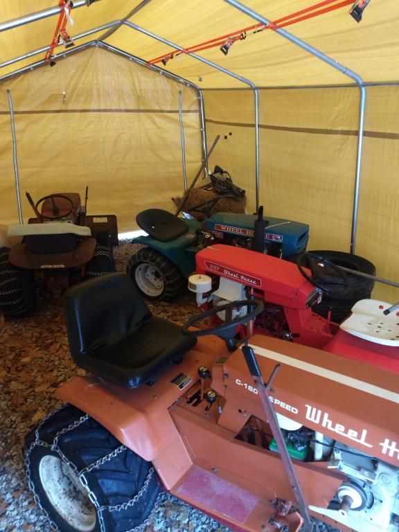

ebinmaine 80,600 #2 Posted February 27, 2020 I'm going to put in a vote for a 1974 to 1977 C Series such as C 120 or C160 hydromatic. Pictured below, in the foreground, is my Cinnamon Horse which is a c160-8 speed. Same thing but different. Plenty of power. Good ability to add weight for stability. Lots of different implements that can be used from like 1970, up. Simple. Reliable. Repairable. Maintainable. Easily modified. 5 3 Share this post Link to post Share on other sites

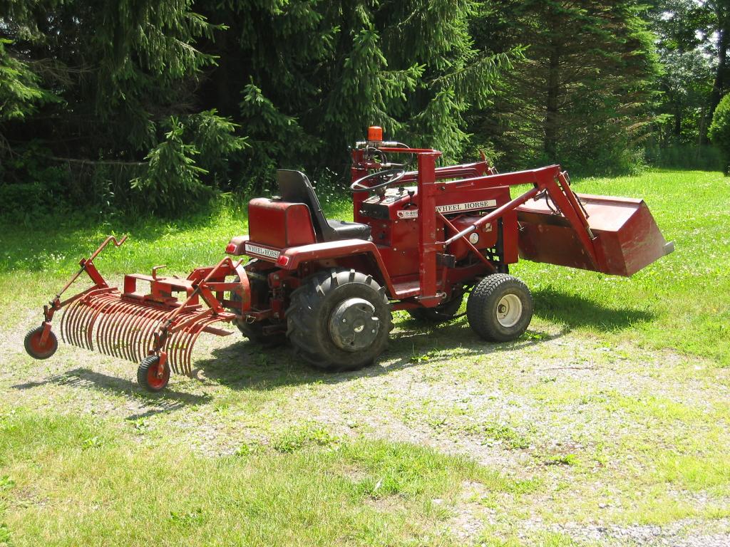

pfrederi 21,145 #15 Posted February 27, 2020 4 way plow, log splitter remotes for a york rake, gear drive and diff lock. You should consider an older small farm tractor... 4 Share this post Link to post Share on other sites
Oldskool 6,678 #16 Posted February 27, 2020 3 minutes ago, pfrederi said: 4 way plow, log splitter remotes for a york rake, gear drive and diff lock. You should consider an older small farm tractor... I have an older Ford 600 series tractor but it is a bit big for my area. As for all the things you listed most of those were examples to see what the possibilities would be. The limits of the older Wheel Horses 2 Share this post Link to post Share on other sites
pfrederi 21,145 #17 Posted February 27, 2020 Then the best match for your needs assuming you design/mount an external hydraulic pump wold be one of the C series 8 speeds like Eric's. Pick up a 10 pinion ltd slip differential and swap that into the 8 speed tranny. 1 1 Share this post Link to post Share on other sites

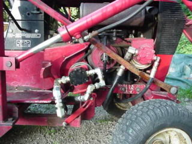

wallfish 20,576 #25 Posted February 27, 2020 Adding extra hydraulic pumps is not an issue. These 2 pumps are on a newer 416-8 but it would be the same set up for an older C series. For a log splitter, I'd have the pump on the splitter itself and power it with a belt from the tractor or easier, just attach a separate motor. The pumps for small tractor implements and cylinders are only 5-10 GPM which could be painfully slow pushing a 5" cylinder 2 Share this post Link to post Share on other sites
