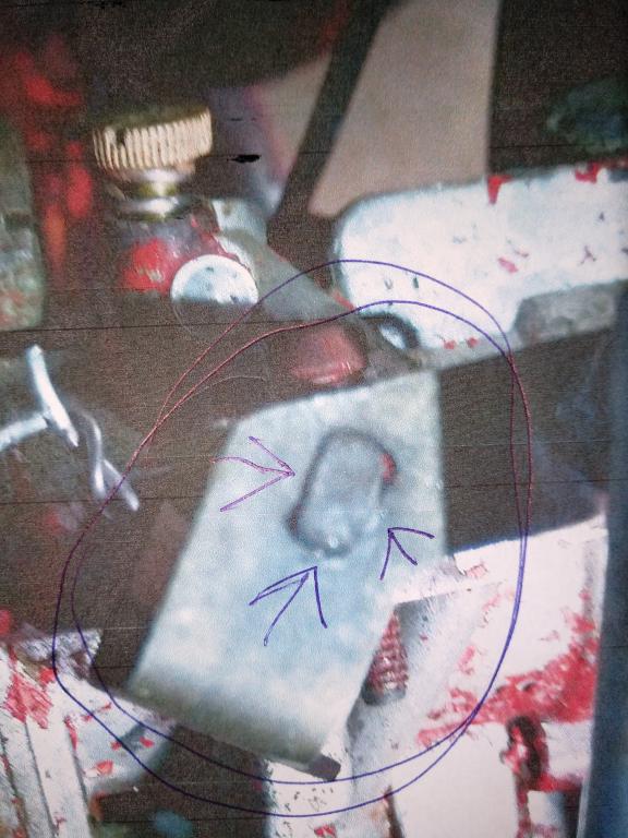

The lever that goes from the throttle shaft to govenour arm has much ware, is this repairable or is there some where to acquire the part new along with rebuild kit? The throttle shaft also has a good bit of movement in the carb body. I know Eric and a couple others have mentioned the new bushing for the throttle shaft. I have not found any where online as of yet.

If that area is loose and moving and it should not be you can probably take a very small amount of carefully placed J-B weld and repair it. Be sure to clean off the area first.

Okay I did give JB weld a thought, I also thought of trying to drop some solder in there to take up the play. Not sure if either would last long with the engine vibration. And I do have the info on the washers. The throttle shaft must available somewhere, if I purchased a new carb it would have one. Would like to save the old original carb if possible.

Soldering is a possibility but it must be done with a fair amount of guesswork and care because the steel of the shaft will heat differently from the solder itself.
I'm not sure about the vibration resistance characteristics of JB weld versus the solder.
Jim and I did solder the carb shaft in the same place on one of the ones we did but I have not installed it on the tractor yet.

Did you use any particular solder or the same type used to solder? Or the same type used to solder copper pipe? And did you use mild heat from a torch? I think the info on the washers that pfredi sent me require the hole in the carb body to be inlarged for the washers to be pressed in.
That's what I thought before I did the job but it turned out that the hole was exactly the right size for the washers that were supplied.
you may very well find exactly the same thing. They popped right in with a very light press-fit.

I would suggest using silver solder. It is stronger & will hold up better over time. If you have an Ace Hardware near by you can purchase two 7/16" od x 1/4" id  x 1/16" thick bushings. These will work to fix your sloppy throttle shaft. There should be no need to change the butterfly shaft.

It's highly unlikely you'll need a shaft.
It's almost always the bore that's worn.
That's why the washers are important.

I think you are correct EB as long as I can secure the shaft to the top lever. And I agree with Achto I believe the silver solder would be more durable. But I may order the shaft just in case I am not successful at soldering it. I am going to need the gaskets and rebuild material so may as well get it as well, probably also get the low speed idle jet and the main fuel jet. Probably not needed but needed, but after 40 years of maintaining a semi truck and trailer going the extra distance pays big dividends down the road.
