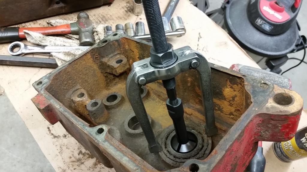

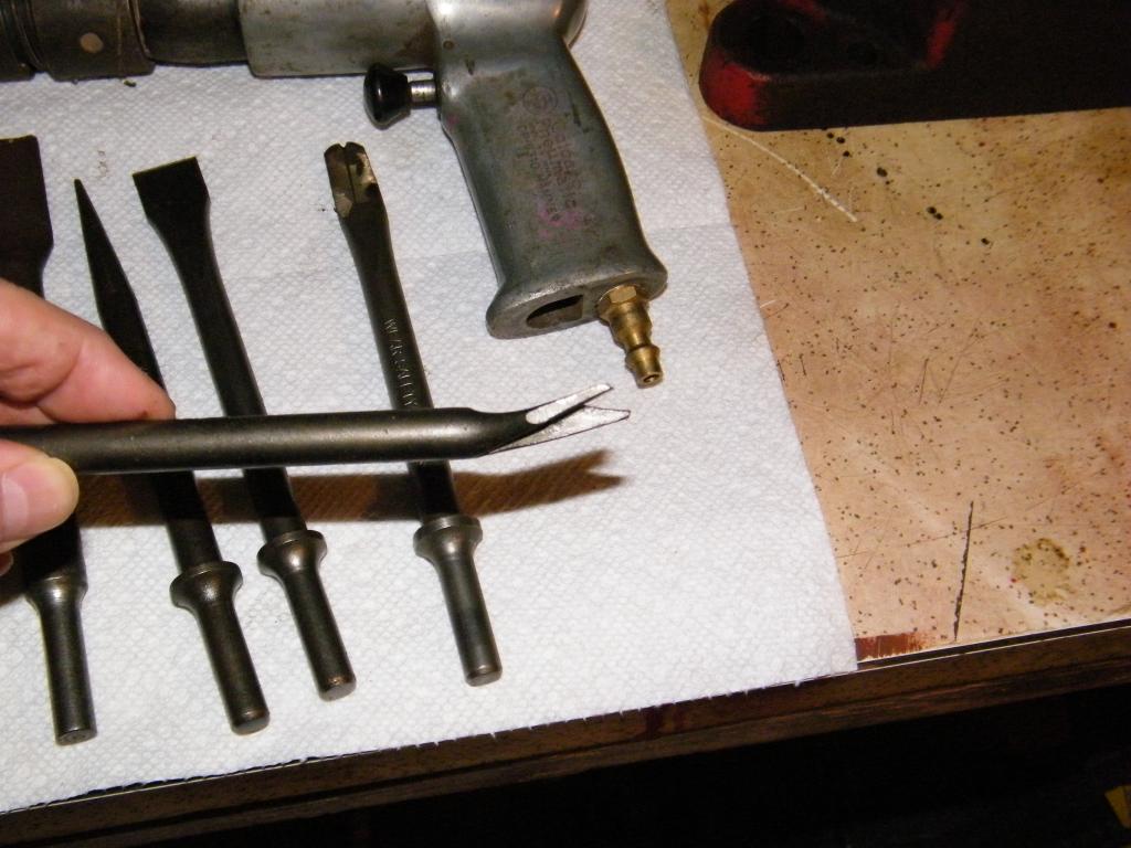

pfrederi 21,274 #7 Posted February 20, 2020 (edited) I want one of those!!! Where did you get it??? Edited February 20, 2020 by pfrederi 1 Share this post Link to post Share on other sites

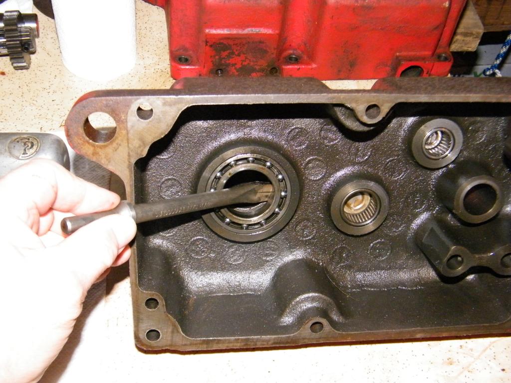

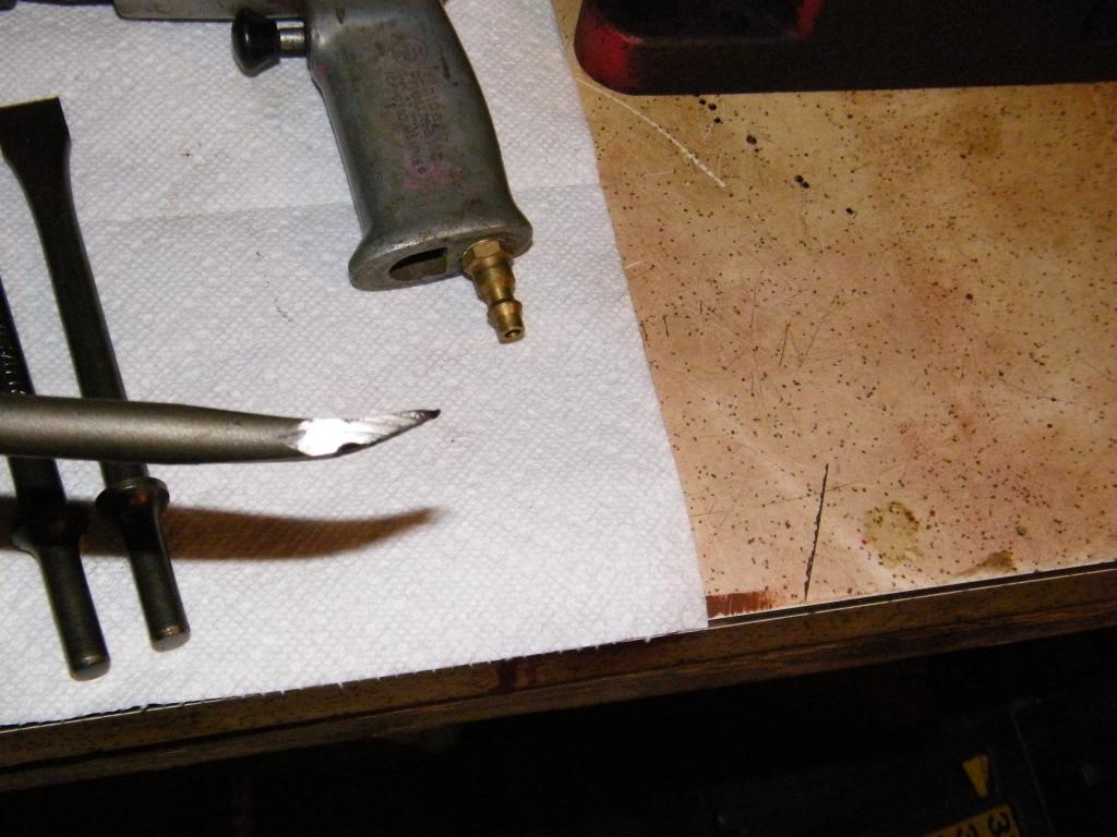

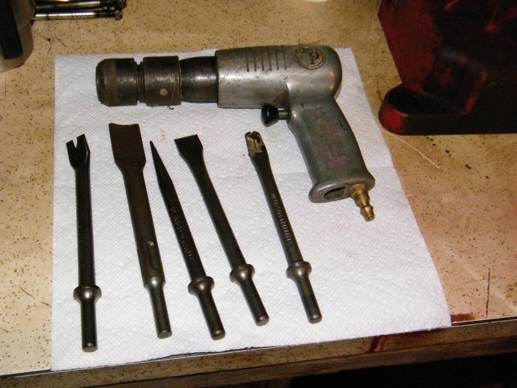

stevasaurus 23,861 #8 Posted February 20, 2020 There is almost nothing worse, then trying to get a #1533 out of the case without hurting it. In this case, it is going to be a piece of cake. Open up the broken case transmission, take the broken half and a 4" grinder...and cut the case away from the bearing. Boom-sha-ka-la-ka!! The thing about these bearings is the retainer keeping the bearing together is very thin, spring like metal. Obviously, a bearing puller is the best way to go. The brass punch is the next best, but I would also try to heat the casting around the bearing. If you use the punch method, make sure you are just tapping and attack the bearing with one tap while working around the bearing in thirds. I have had success with an air chisel and sometimes they just pop out. 1 1 Share this post Link to post Share on other sites

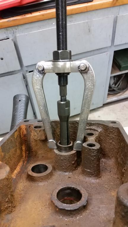

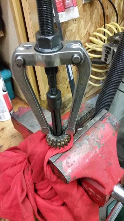

WHX?? 58,324 #9 Posted February 20, 2020 22 minutes ago, pfrederi said: Where did you get it??? Not what I would call top quality tools Paul but way good enough for us hobbyists.... dirt cheap too. Just make sure you keep things greased and they work pretty well. I got them for doing a three piece since I couldn't find Steve's ground down carriage bolt I made for bearing puller. I think I might have paid less than 40 off flea bay... search blind hole bearing puller... https://www.amazon.com/Bearing-Puller-Internal-Extractor-Remove/dp/B017XDLDDY/ref=sr_1_5?crid=3KK9U86S0YPRL&keywords=blind+hole+bearing+puller&qid=1582220646&sprefix=blind+hole+bearing%2Caps%2C185&sr=8-5 2 Share this post Link to post Share on other sites
oldlineman 1,817 #10 Posted February 20, 2020 I would say a little heat on the case would be very beneficial. 1 Share this post Link to post Share on other sites
pfrederi 21,274 #11 Posted February 20, 2020 15 minutes ago, WHX24 said: Not what I would call top quality tools Paul but way good enough for us hobbyists.... dirt cheap too. Just make sure you keep things greased and they work pretty well. I got them for doing a three piece since I couldn't find Steve's ground down carriage bolt I made for bearing puller. I think I might have paid less than 40 off flea bay... search blind hole bearing puller... https://www.amazon.com/Bearing-Puller-Internal-Extractor-Remove/dp/B017XDLDDY/ref=sr_1_5?crid=3KK9U86S0YPRL&keywords=blind+hole+bearing+puller&qid=1582220646&sprefix=blind+hole+bearing%2Caps%2C185&sr=8-5 Jim Thank you !! i have a small one that will pull pilot bearings etc but not big ones like the 1533. 1 Share this post Link to post Share on other sites
