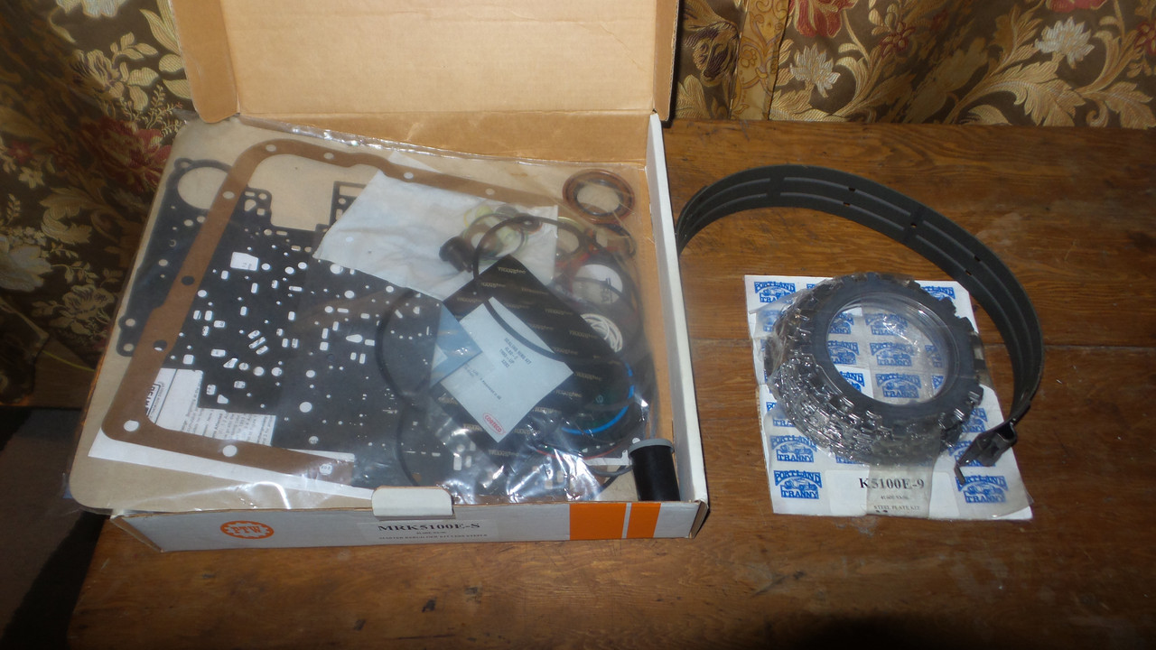

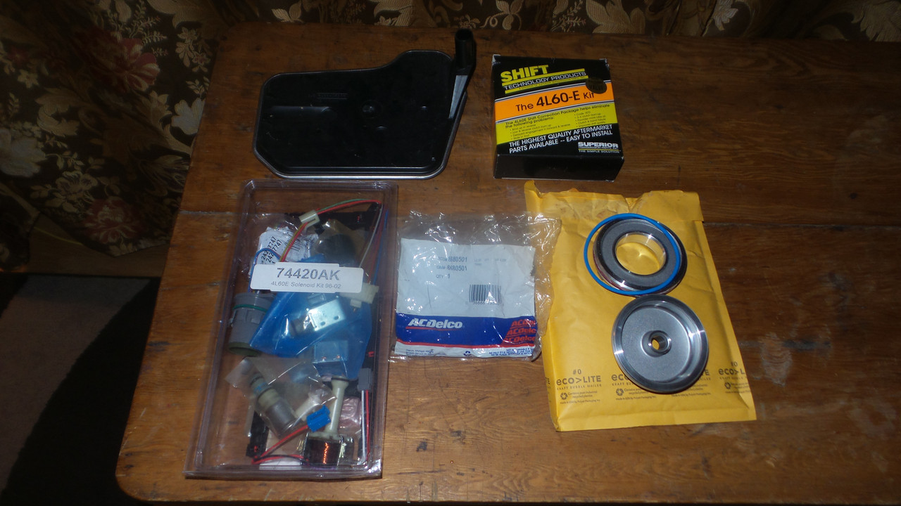

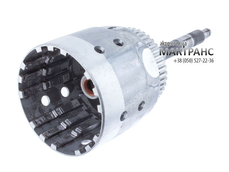

bc.gold 3,406 #1 Posted February 18, 2020 (edited) Transmission kaput, still have first and reverse. The 2 / 3 clutch pack is worn out, this is a common problem with the GM 4L60-E transmission, as soon as the snow is gone I'll be pulling the transmission out for a rebuild. The first image new filter, upgrade to Corvette servo, shift kit and all new solenoids. The shift kit will lesson the time it takes for a clutch pack to fully engage, this will keep the transmission running much cooler and probably give a slight increase in fuel mileage. It's advisable to install new solenoids even if the old ones were still working, as the transmission clutch packs began to slip the trans would have been operating at critical temperatures causing the plastic insulation on the wire leads to become brittle. Second image new steels, in the old days would just sand the surfaces to de-glaze then if any had severe heat spots would replace those with new ones. Last image frictions being soaked in ATF fluid, this will pre-lubricate in addition to swell them up so that proper clearances maybe observed. Clutch pack clearances maybe adjusted buy using thinner or thicker steels. It's always advisable to hang onto the old steels until the job is completed as I've often found after market steels thicker than OEM. There are plenty of youtube videos out there showing the complete rebuild, the only difference is than I have made a few simple jigs and a spring compressor needed to remove a snap ring to access one of the clutch pack pistons to replace the seals. If there's interest I'll post picture when I have this transmission on the bench. The friction ,material bonded to the plates is made from paper. Edited February 18, 2020 by bcgold 3 Share this post Link to post Share on other sites

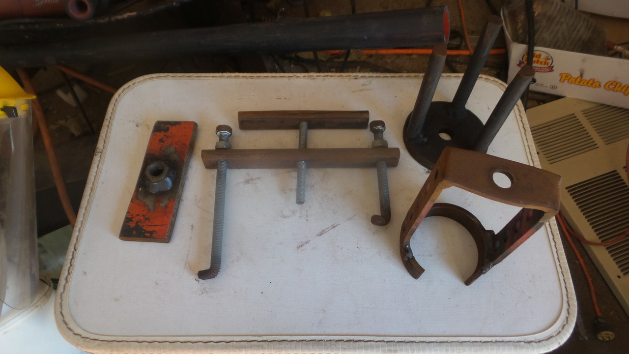

bc.gold 3,406 #19 Posted February 18, 2020 Some tools I made, the center one with the grab hooks fit into the holes on the input drum, missing from the image is the cup which is placed on top of the spring pack, that needs to be compressed in order to remove a snap ring. The spring pack returns the piston to rest when it's no longer required for this clutch pack to be applied. Don't ask what gear is being applied as I do not know. I'm just replacing the parts which show obvious wear and the cause for their failure which is heat hardened seals. The jig front right will be used to compress a spring pack located inside the rear of the transmission case, threaded ready rod inserted from the rear of the case will do the compression. The jig with the three prongs was used to compress an 800 psi spring used on the Dodge overdrive package using the bench press. 1 Share this post Link to post Share on other sites

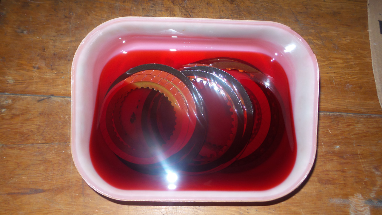

bc.gold 3,406 #20 Posted February 18, 2020 (edited) I remember when I could purchase a full rebuild kit for $35.00 and did bench builds for $225.00. My buddy's son James brought me a transmission to rebuild, then about six months later he had another one, only this time I told him to come early in the day as it was he who would be doing the rebuild. That was 50 years ago, I've never seen another transmission from James as he was building his own. My first transmission was the Ford FMX and could not figure out how it all came apart then when an opportunity came about I offered to work for free at a newly opened Mr. Transmission shop which was short on cash and needed to extra hand. The first six months was with out pay. Edited February 18, 2020 by bcgold 1 Share this post Link to post Share on other sites

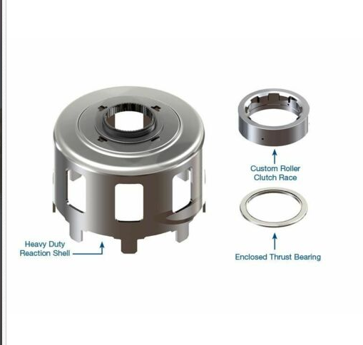

ZXT 2,402 #21 Posted February 19, 2020 I'll be following along! I have a 4l60E that stripped the reaction sun shell. I've been inside of 3 Chrysler 727 transmissions, but never a Chevy. Are you replacing the sun shell on yours? If you aren't, I would - that's a huge failure point on 60's. You lose 2nd, 4th and reverse when it goes, IIRC. 12 hours ago, ProfessorBurden753 said: I thought the same thing of the 99 F250 i had with those oddball 7 lug wheels on it as well Exactly what they were, especially since they used the half ton body! I believe all of the 3/4 ton vans of the period were 7 lug as well. 11 hours ago, ProfessorBurden753 said: tags for my 98 2500 and Krystal's 94 F150 both run me $27.50 a year... Down here, registration for my 95 Ram 2500 V10, which has an 8800 GVW, is $79. Inspection is $7 now since it's 25 years old. Inspection would otherwise be $30ish. Sounds like y'all are getting a better deal until you remember you have a silly state income tax! 10 hours ago, pfrederi said: Auto tranny failure...Goodbye truck At that point what dies next.... Jeez, a bit harsh to toss something because it needs repair, don't you think? I can imagine that's how so many of our WH's got to be in their neglected states. Rather than fix it, they sent it out to pasture. You might be surprised how much life his truck has left in it. It's a SBC I assume, so with regular maintenance it will probably last another 150k miles before a major failure. After he's done, he'll have a couple hundred dollars in the transmission max, and the truck will definitely increase in value more than his investment. If a vehicle has been good to me, I'll definitely put an engine and/or trans in it when the time comes. My current work truck has 230k on it. Neither the engine or trans have ever been out of it - and It has the transmission model that gave Dodge the reputation for having "bad" transmissions in their Diesel trucks. Mine isn't a diesel, but the V10 had 135HP and 50 Ft lbs of torque on the Cummins. I did pick up a spare engine with 93k miles on it a few weeks ago for $100. Don't need it now, but for that price.. 2 Share this post Link to post Share on other sites
bc.gold 3,406 #22 Posted February 19, 2020 (edited) ZXT thanks for bringing this to my attention, the truck previously belonged to my other half used primarily as a grocery getter. She recently gifted the truck to me along with the transmission parts previously purchased. Now that I'll be using the truck I'm going to take your suggestion to replace the sun shell. Here's an image of the sun shell ZXT is referring to, they're infamous reputation is having the internal spline strip out. Anyone interested in down loading the shop manual, this link is live for the next 30 days there's two files in this offline folder. https://tinyurl.com/vxvzxs2 Edited February 19, 2020 by bcgold 2 Share this post Link to post Share on other sites

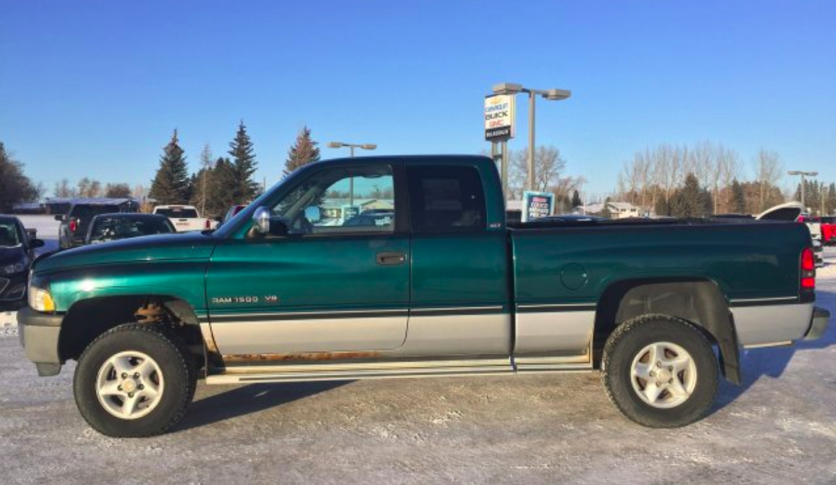

bc.gold 3,406 #25 Posted February 21, 2020 Since the rebuilt kit has already been purchased I'll continue with the overhaul, maybe get lucky and find a buyer. I've decided not to go through all the necessary work to have this truck safetyed. Instead I've purchased a 97 Ram 4X4 Auto with the V8 Magnum, decent tires, sprayed in box liner and very little rust for $1,000.00 Canadian. 2 Share this post Link to post Share on other sites
