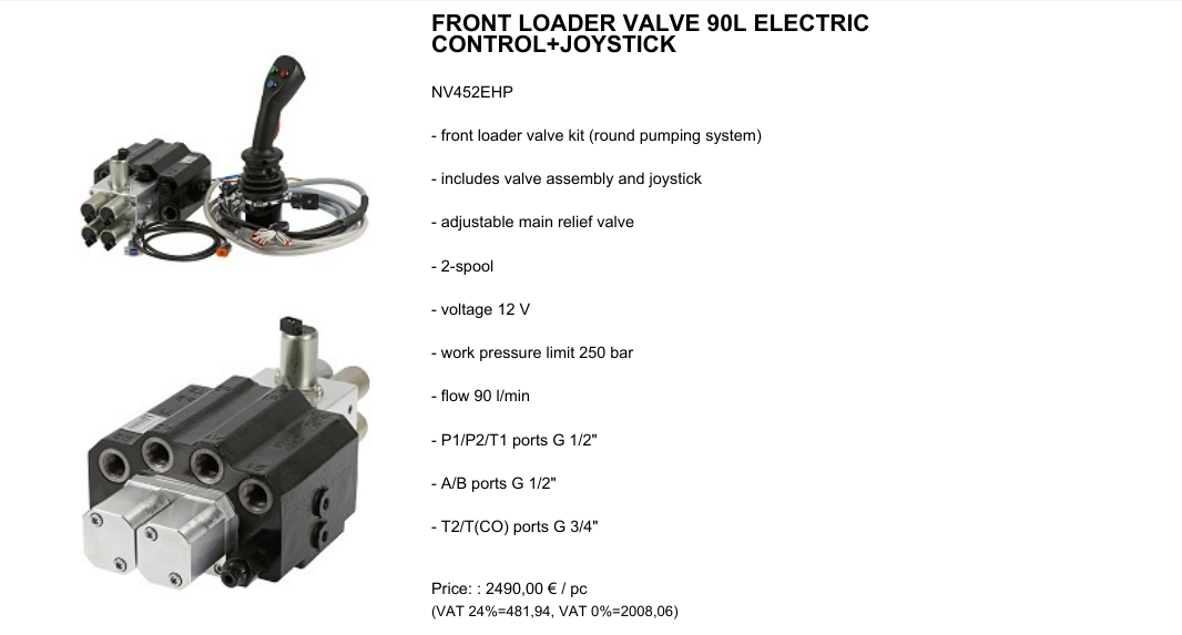

bc.gold 3,406 #2 Posted February 12, 2020 This one at 90 liters a minute would be excessive for an ARC loader. 1 Share this post Link to post Share on other sites
