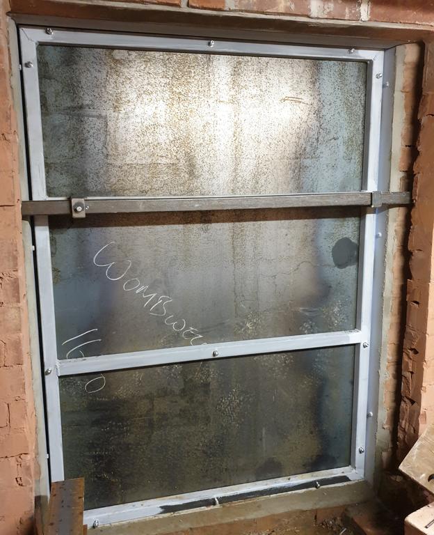

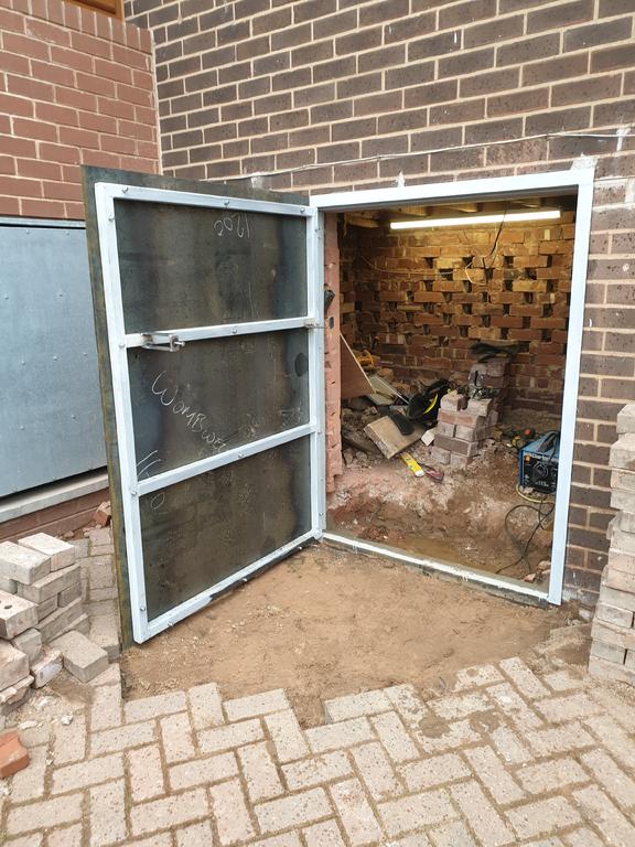

Mickwhitt 5,259 #76 Posted March 9, 2020 Hi Norm, I have left quite gap all the way round so I hope it wont bind when it gets warm. My steel gates cause problems when it gets really hot, not closing properly till they cool down. I've put the door skin on with coach bolts for now and will weld it from the inside when we have a better day. Next job is to fit the universalbeam to support the floor and take out the sleeper wall. Then the structural stuff is done and I can relax a bit to complete it. Mick 4 Share this post Link to post Share on other sites
Mickwhitt 5,259 #77 Posted March 9, 2020 I had to knock up a quick locking device for the door so I plumped for a simple box section bar which slides into carriers welded to the door and is held behind the outer leaf brickwork. A jack screw on the opening side allows me to pull the door in tight to seal it. 4 Share this post Link to post Share on other sites
Mickwhitt 5,259 #78 Posted March 9, 2020 This is the door closed and bar in place. Works pretty well for something I thought up in minutes. I will make another one tomorrow to go on the lower horizontal member, should be enough to see off the average burglar. Mick 5 Share this post Link to post Share on other sites
Stormin 9,988 #80 Posted March 9, 2020 39 minutes ago, Mickwhitt said: This is the door closed and bar in place. Works pretty well for something I thought up in minutes. I will make another one tomorrow to go on the lower horizontal member, should be enough to see off the average burglar. Mick I would think that would be enough, Mick. 2 Share this post Link to post Share on other sites
ebinmaine 79,570 #81 Posted March 9, 2020 16 minutes ago, Stormin said: I would think that would be enough, Mick. I'd say so too .. You get a thief with enough ambition to go breaking through an iron door and you should just give him half of your possessions as a prize for great extended effort. 1 Share this post Link to post Share on other sites
rjg854 13,167 #82 Posted March 10, 2020 Agreed, I find it hard to believe anyone is getting through that door. Share this post Link to post Share on other sites

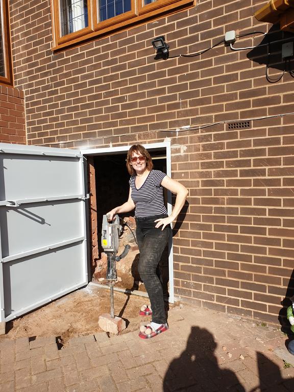

Mickwhitt 5,259 #85 Posted March 11, 2020 Hi all, Demolition day, took out the sleeper wall and put the I beam in ready to be packed in place. Mrs whitts with her de mo lition hammer. She is good at knocking things down. Tired now, need to rest up a bit before I start the next phase. Mick 4 Share this post Link to post Share on other sites
ebinmaine 79,570 #86 Posted March 11, 2020 Anytime you find yourself a girl that is willing to use heavy-duty tools you hang right on Share this post Link to post Share on other sites
Mickwhitt 5,259 #87 Posted March 11, 2020 I wont be letting her go anytime soon. She has asked me to point out she was not working in her slippers. I know you guys like health and safety She had just popped in to make a brew and I called her to take a photo. She helped me lift the 3.5 m girder in too this afternoon. Beautiful and not scared to get stuck in. I'm blessed with her 1 1 Share this post Link to post Share on other sites
ebinmaine 79,570 #88 Posted March 11, 2020 Mick, don't sweat the slippers. You check out some of the photos that Trina is in and you'll see multiple pairs of socks. Share this post Link to post Share on other sites
Stormin 9,988 #89 Posted March 11, 2020 22 minutes ago, Mickwhitt said: She has asked me to point out she was not working in her slippers. I know you guys like health and safety She had just popped in to make a brew and I called her to take a photo. That's my forth coming witty comment shot down in flames. 2 Share this post Link to post Share on other sites
Mickwhitt 5,259 #90 Posted March 11, 2020 Honest she was wearing trainer boots when we were working! It's amazing what she can do in a pair of slippers, these ones are a bit old fashioned with the pom poms lol Share this post Link to post Share on other sites

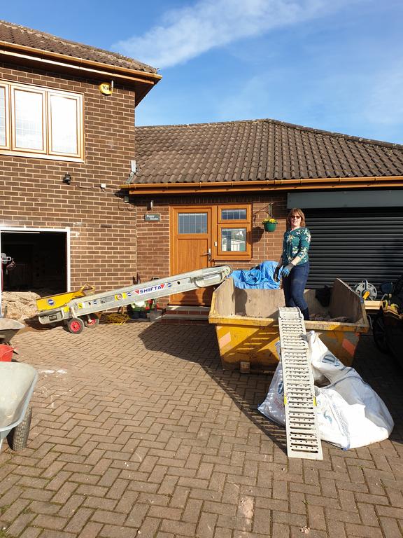

Mickwhitt 5,259 #91 Posted March 13, 2020 Ok, so a tough day today. Skip arrived and only just managed to get through the drive gates. Decided to hire a conveyor to load the skip rather than handball the concrete oversite into the skip. Used the demolition hammer to break up the concrete and then loaded up the skip. Sandra helped out again, distributing the rubble in the skip and generally being there to support me. It's now down to digging out the clay soil to a depth where I am comfortable to lay 3 inches of concrete to make a floor. I will lose the soil on our community project refilling our raised beds. 4 1 2 Share this post Link to post Share on other sites

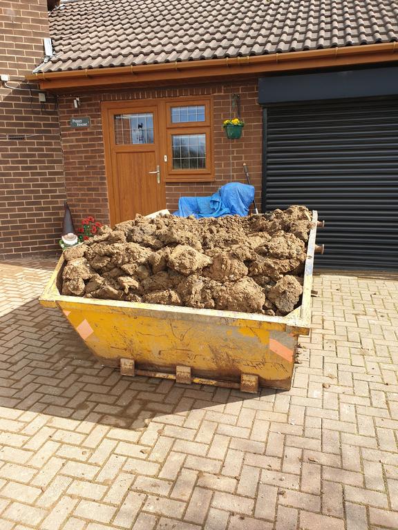

Mickwhitt 5,259 #92 Posted March 14, 2020 Blimey, bit of another tough day. Managed to cut out all the clay capping layer which was real donkey work. Filled the skip and a different driver arrived to collect it, but couldn't get thru the gate. Same size truck, same size gate. I guess there are drivers and drivers. so between us we filled a 4 ton skip in one working day, plus digging the stuff out. Cant wait to get back to normal work lol. Things are getting quiet though with people cancelling their holidays and so not having us look after their pets. Tighten the old belt and carry on. Mick 3 Share this post Link to post Share on other sites
