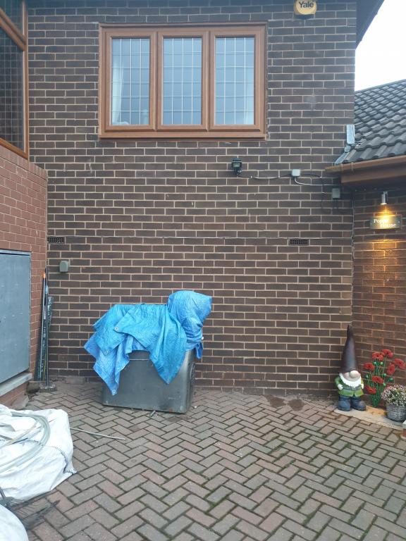

Mickwhitt 5,259 #8 Posted February 9, 2020 The photo shows the front wall I am looking at opening a doorway in. The two air bricks are at the height of the floor joists for our bedroom above. The room would be about 3.5 x 3.5 m which is plenty for parking mowers in. 4 Share this post Link to post Share on other sites
Mickwhitt 5,259 #9 Posted February 9, 2020 If I dug out to give myself headroom I would lift the block paving and lower the drive a little. But only a 4 foot door would lessen the amount of work outdoors. The silver door on the left goes into a space beneath the balcony which is ok for some tools but only about four foot high so no good for mowers. Door is also too narrow. Hope our buildings control guy has had a good weekend lol. 2 Share this post Link to post Share on other sites
Mickwhitt 5,259 #10 Posted February 9, 2020 The blue tarp is concealing a Smart and Brown capstan lathe which I have no room for at present. Share this post Link to post Share on other sites

Pullstart 71,332 #14 Posted February 10, 2020 I see your guard keeps a nice beard. Share this post Link to post Share on other sites
Mickwhitt 5,259 #15 Posted February 10, 2020 Yep the gnome looks after us. Building control coming out tomorrow for a free inspection and advice visit. Hoping he will point me in the right direction regarding this. It would certainly give me some secure storage for Fred and the other mowers. Mick 1 1 Share this post Link to post Share on other sites
