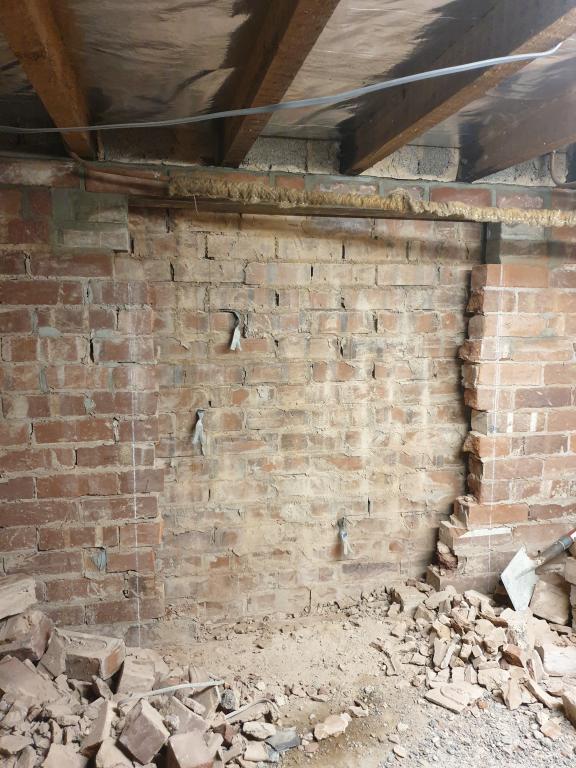

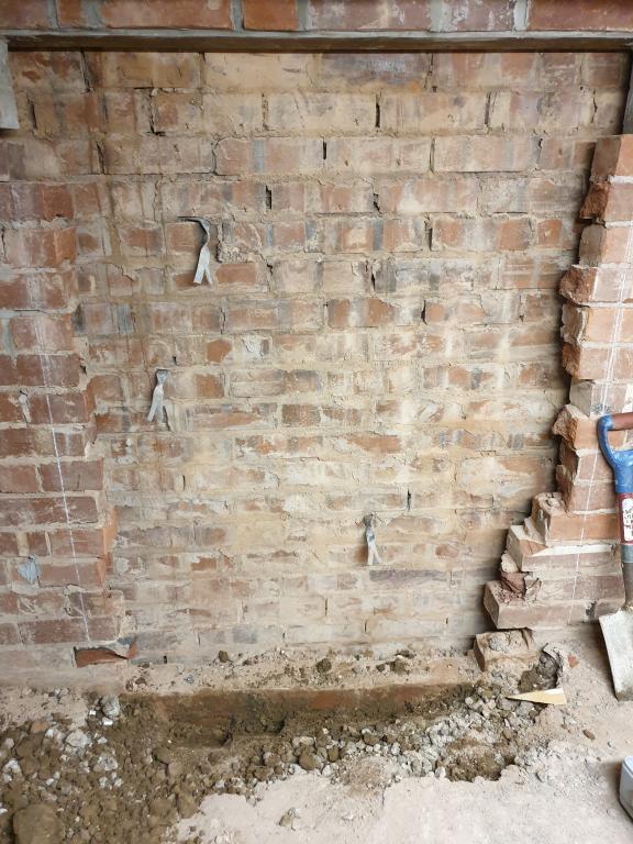

Mickwhitt 5,259 #59 Posted February 21, 2020 so there we are, inner leaf removed to reveal the inside of the outer wall. With luck my new brick brace gadget will be here monday so we can start on the outside. Yes Eric the dust is a problem, but once I break through to outdoors it should be less so. Then it will be designing and building a steel security door for it. Mick 2 Share this post Link to post Share on other sites

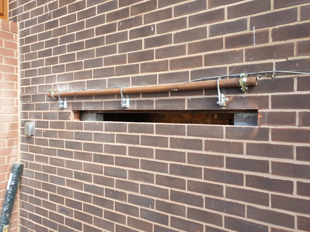

Mickwhitt 5,259 #61 Posted February 24, 2020 Well, the brick brace tools arrived and it looks straightforward to use them. Basically lock them into the vertical joints and hook over a scaffold tube bolted to the brickwork above. Self supporting rather than using props from below. Busy with meetings tomorrow so wednesday looks like D-day for doing the cutting for the lintel. I've had a chop at the concrete floor and it is just "oversite" which was spread on the soil to prevent weed growth during building. It breaks up easily and will be no problem to lift up ready to excavate a bit more depth. All looking good so far... Mick 2 1 Share this post Link to post Share on other sites

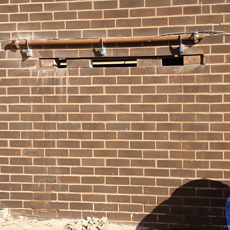

Mickwhitt 5,259 #62 Posted February 26, 2020 Ok been busy again, managed to fit the brick brace and cut out the slot for the steel lintel to go in. The brace tool was fairly easy to set up and it held the course of brick in place without the need for props which get in the way. I put in the pad stones for the steel to sit on and tomorrow I will point the steel in ready to remove the support system. Mick 2 Share this post Link to post Share on other sites

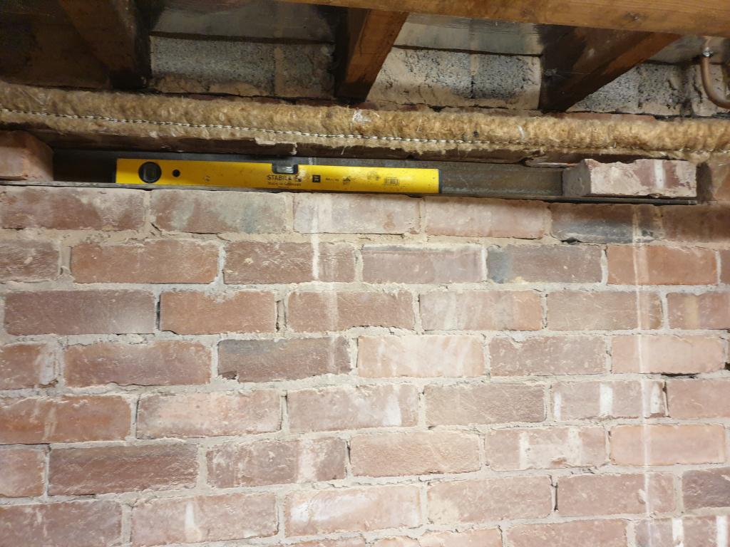

Mickwhitt 5,259 #63 Posted February 26, 2020 Couple of support bricks holding the steel lintel up while the pad stones are setting in place. My builder was not available so I decided to just get on with it and see how things turn out. So far so good. Mick 2 1 Share this post Link to post Share on other sites
Stormin 9,988 #64 Posted February 26, 2020 (edited) I'm just a little puzzled there, Mick. Is that lintel flat, angle or H section going in there? Edited February 26, 2020 by Stormin Share this post Link to post Share on other sites
Mickwhitt 5,259 #65 Posted February 27, 2020 Hi Norm, It's a length of 100mm x 100mm equal angle 8mm thick webs. Or rather two lengths, one inside leaf one outside. The upstand of each goes up into the cavity. So each leaf of the wall is supported independently. Both leaves have to be tied together when I cut out the doorway to replace the three wall ties that were in the centre section. I will be fabricating a steel door frame that will also offer some support. Building regulations officer coming out to see it next week. Mick 1 1 Share this post Link to post Share on other sites

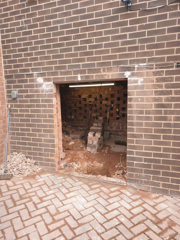

Mickwhitt 5,259 #67 Posted March 3, 2020 Houston we have a doorway! Not too bad a job to saw the brick out. Took longer to drive to the hire shop than to do the job. Made a gash wooden door to keep out the weather while I can measure up for the steel door. I'll order the steel to be delivered later in the week so I can make a start on it. Just thinking about the best design for security. Mick 1 2 Share this post Link to post Share on other sites

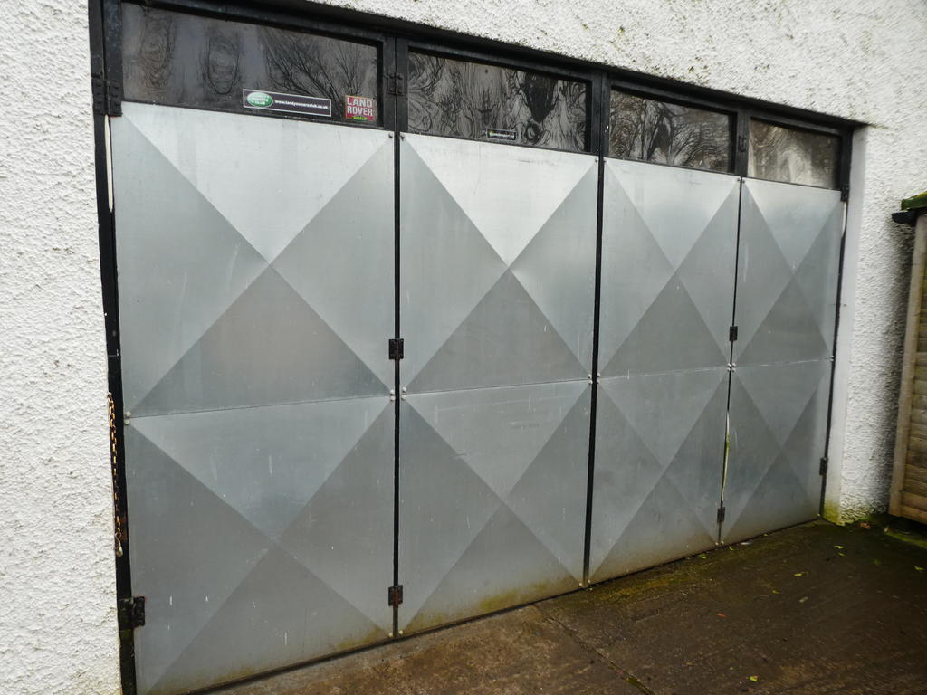

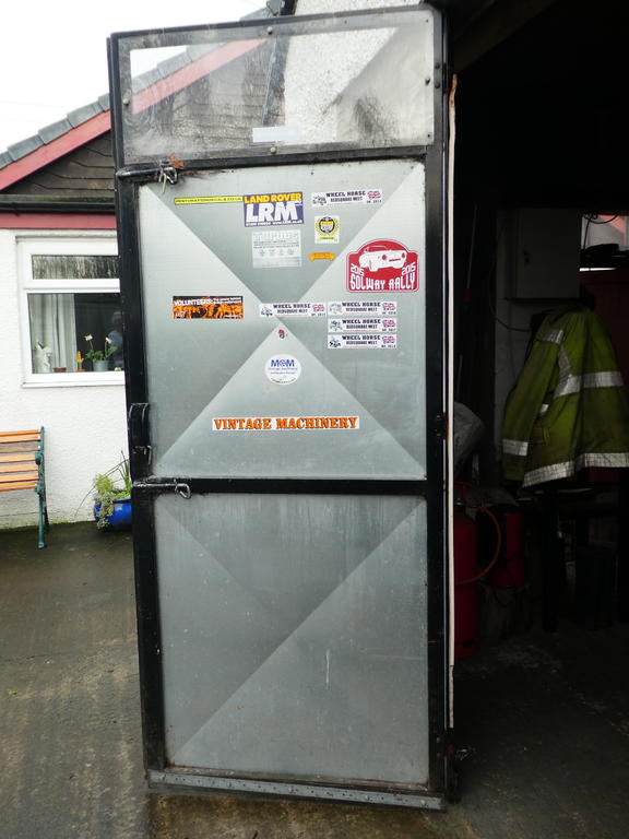

Stormin 9,988 #68 Posted March 3, 2020 I used 2x2 for the frame and 1x2 box section for the doors, Mick. Then ganv sheet to finish. I'll take a photo or two tomorrow. Share this post Link to post Share on other sites
Stormin 9,988 #69 Posted March 4, 2020 Here's my doors, Mick. Bigger than you require, but may give you an idea or two. 1 Share this post Link to post Share on other sites
Mickwhitt 5,259 #70 Posted March 4, 2020 Hi Norm. Looks very well done. On going to collect the steel tomorrow and build the frame first before I start on the door. Got some steel weld on bullet hinges already and I will look at a decent locking system. I'm thinking of making it lockable from indoors only so there is no lock to attack. Once I'm secure I can start to dig out for the new floor level. Just a thin concrete base as there will be no real weight on it. Mick Share this post Link to post Share on other sites
Stormin 9,988 #71 Posted March 4, 2020 For security there are bolts on the inside, non on outside. Those you can see are ideal. I just put a hook through where a padlock would go. One day I'll make a new service door. This time a steel one and wire it to the mains. 1 2 Share this post Link to post Share on other sites
Mickwhitt 5,259 #72 Posted March 5, 2020 Lol, the mains electrickery looks inviting. I do have a couple of 12 bore perimeter mines I'm considering fitting! All steel bought today so I'm off to fabricate ne a door. Mick Share this post Link to post Share on other sites

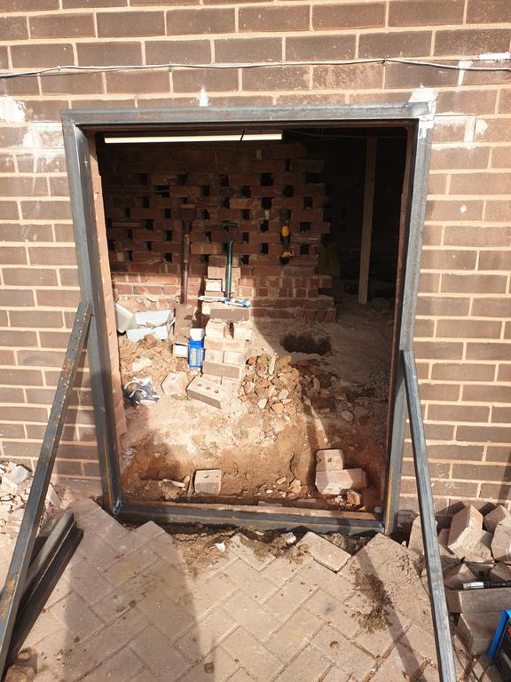

Mickwhitt 5,259 #73 Posted March 5, 2020 I got the door frame welded up this afternoon in a rare window of fine, warm weather. I will fabricate the door tomorrow and then decide on a covering for it. I'm leaning towards 3mm steel plate rather than thin galvanized sheet. There will be less noise from it flexing in the wind and it will be more secure. Mick 4 Share this post Link to post Share on other sites

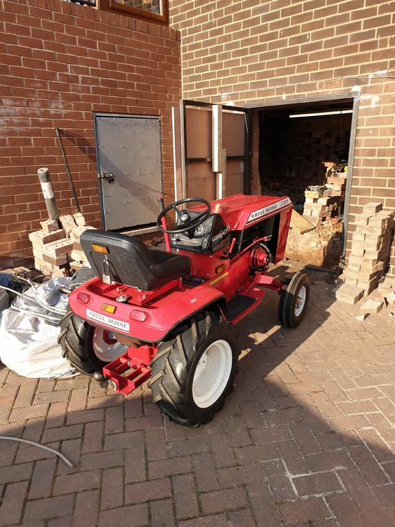

Mickwhitt 5,259 #74 Posted March 6, 2020 Door made today and the hinges set so it actually works lol. Ordered the steel plate for the door and that will arrive next week. Just got to sort out some locking bars for it now. Fred is champing at the bit to get in there. Mick 2 2 Share this post Link to post Share on other sites
Stormin 9,988 #75 Posted March 9, 2020 (edited) I see the sun is shining on the doorway. Hope you've allowed for expansion. Mine don't get any sun, unless they are open during the afternoon. In summer I hade to let them cool or they wouldn't shut. Edited March 9, 2020 by Stormin Share this post Link to post Share on other sites
