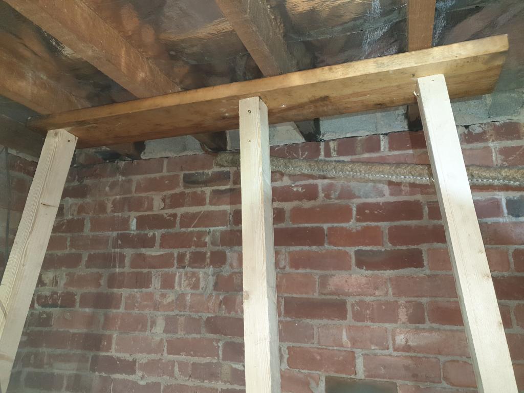

Mickwhitt 5,259 #29 Posted February 15, 2020 Ok, made a small start on the project. propped the floor joists ready to remove the course of brick that will allow the steel lintel to go in. Widened the hole in the sleeper wall and carted all my tools in. The concrete floor is just the waste from when it was built so I can dig it out and get some headroom. Storm Dennis approacheth so indoor work is good, just done two hours litter picking in the wind and rain. Mick 4 Share this post Link to post Share on other sites
ebinmaine 80,131 #30 Posted February 15, 2020 6 minutes ago, Mickwhitt said: dig it out and get some headroom Have you officially figured your after build ceiling height? Share this post Link to post Share on other sites
Mickwhitt 5,259 #31 Posted February 15, 2020 Hi, No I've not done that, depends on how much material I have to remove I suppose. I would like it to be high enough to stand up in I.e. 6 foot but I'm not too bothered if it's a bit less. Obviously a 4 inch concrete floor will have to go in so there will be a good bit of digging to do. Mick 2 Share this post Link to post Share on other sites

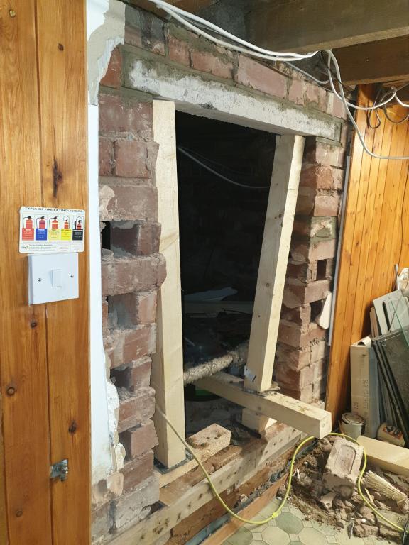

Mickwhitt 5,259 #34 Posted February 16, 2020 ok so I walked the dogs and then set about putting the lintel in place. Its propped until the mortar sets. I did support the floor joists before I cut out the brick work to fit the lintel. Mick 4 1 Share this post Link to post Share on other sites
ebinmaine 80,131 #35 Posted February 16, 2020 What's that made of? Looks like a hunk of concrete? Or stone? Share this post Link to post Share on other sites
Mickwhitt 5,259 #36 Posted February 16, 2020 It's a pre stressed concrete lintel, steel reinforced and up to the job apparently. Mick 2 Share this post Link to post Share on other sites
Mickwhitt 5,259 #37 Posted February 16, 2020 all supports removed and bricks cut out to floor level. Not bad for a non builder like me. Mick 3 Share this post Link to post Share on other sites
Mickwhitt 5,259 #38 Posted February 16, 2020 all supports removed and bricks cut out to floor level. Not bad for a non builder like me. Mick 1 Share this post Link to post Share on other sites
Stormin 9,988 #39 Posted February 16, 2020 2 hours ago, Mickwhitt said: Not bad for a non builder like me. Mick Just be carefull you don't trip over that pipe. 3 Share this post Link to post Share on other sites
Mickwhitt 5,259 #40 Posted February 16, 2020 I never thought about that, thanks for the heads up. central heating pipes feed, I'll move it and pipe a radiator in while I'm at it. Couple of power sockets and lighting, I may move in lol. If I buy another mower I may have to move in..... Mick 1 1 4 Share this post Link to post Share on other sites
