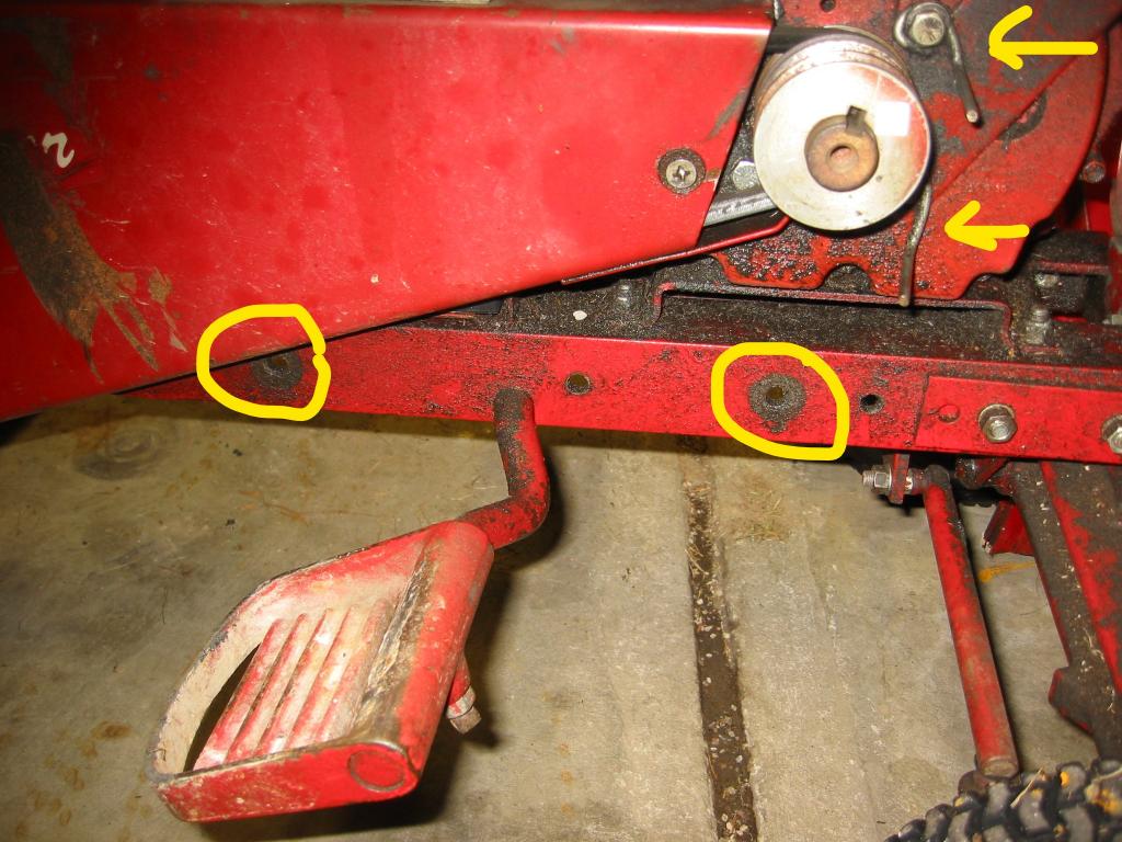

pfrederi 21,225 #17 Posted February 5, 2020 The four arms on your 115 deck bolt directly to the tractor frame. The holes circled in yellow are 9-1/2" on center the front one below the engine crankshaft. My short frame tractors are in winter sleep. so I cannot measure to see if they have the same holes as a Lawn ranger. but I would guess they do or you could drill a couple. Does your deck have a couple springs and a belt shield on it? Also you will need a wire guide at the enginen drive pulley to keep the belt in place. WH # 4930 It is similar to the ones in my picture but back over the pulley (I haven't had my deck mount d in years. The guides on mine were for a snow thrower. Share this post Link to post Share on other sites

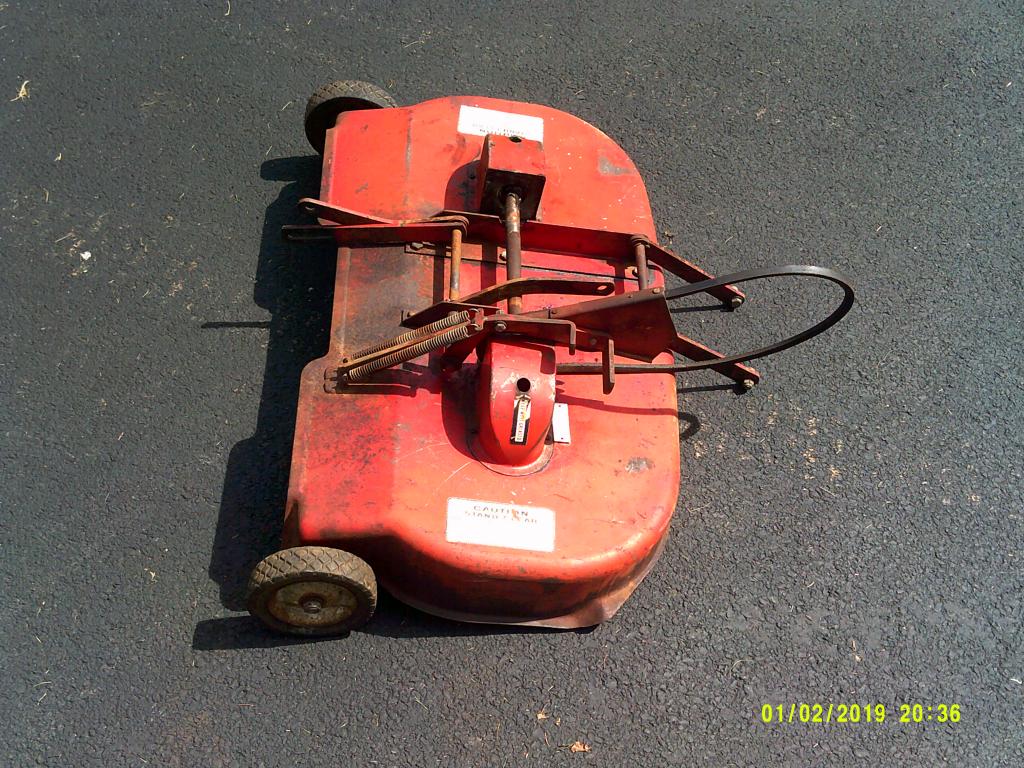

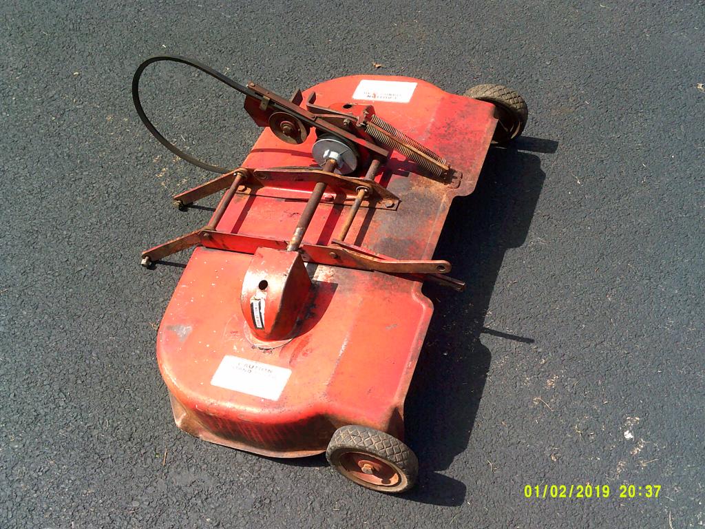

Robert Greene 0 #20 Posted February 21, 2020 Finically got around to taking a few pics and trying to attach them. This is my RM-115 deck that I may try to retrofit to my 857 mower. Share this post Link to post Share on other sites
pfrederi 21,225 #21 Posted February 21, 2020 That is a lawn Ranger deck, Going to take significant work to put it on an 857 Share this post Link to post Share on other sites
