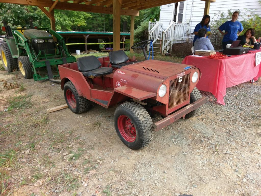

wallfish 19,738 #1 Posted February 5, 2020 Found a couple of Roof 60 tractors. They aren't the Jeep style Palomino but they are still very cool tractors. And go up to 22 mph! woo hoo The two I found do not have engines and they connect the hydro trans to the engine with a drive shaft onto the flywheel side. I have a 20 HP Kohler but will need a flywheel. So I know JDs connect with a shaft but just not sure of the bolt spacing on those flywheels from a JD. Hope they would fit this tractor as this is kind of the only thing holding me up from pulling the trigger on them. I do have an Onan B43 from a JD but spacing on the flywheel holes is too small although I believe it can still work if required to drill new holes on the drive shaft plate. Any advice or help is appreciated For the curious, they look like this. The 2 I'm looking at aren't as nice but making 1 outta 2 ain't bad 4 3 3 Share this post Link to post Share on other sites

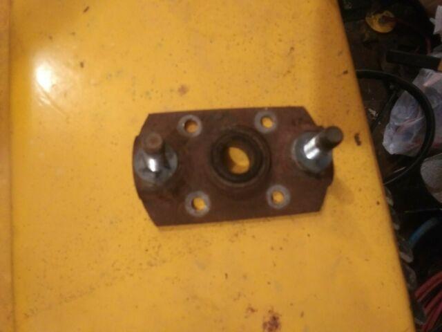

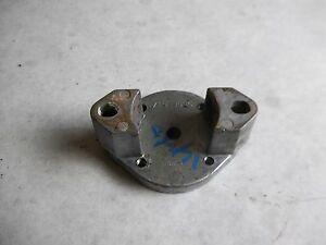

Achto 31,552 #5 Posted February 5, 2020 Great find John!! I'm not sure how Roof made their fly wheel to drive shaft connection, but here is my knowledge on how Cub Cadet did theirs. If nothing else it may give you some ideas. They made an adapter that bolted to the engines factory holes in the fly wheel. If you had a CC with a Briggs & you wanted to install a Kohler then you would need the adapter that was made for the Kohler. The adapter for the Kohler's is actually more plentiful than the Briggs adapter, I did a Kohler to Briggs swap & ended up making an adapter for the Briggs engine. For CC this plate would bolt to the fly wheel, then it would be connected to the drive shaft using a rubber flex washer. Adapter Pick up plate from adapter to drive shaft. Assembly. 1 Share this post Link to post Share on other sites

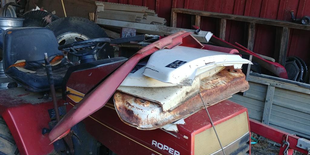

WVHillbilly520H 10,378 #8 Posted February 5, 2020 (edited) Some of the big AYP (Roper/Craftsman) were set up very similar with flywheel to driveshaft ... Like you see buried under my CC collection Edited February 5, 2020 by WVHillbilly520H Share this post Link to post Share on other sites

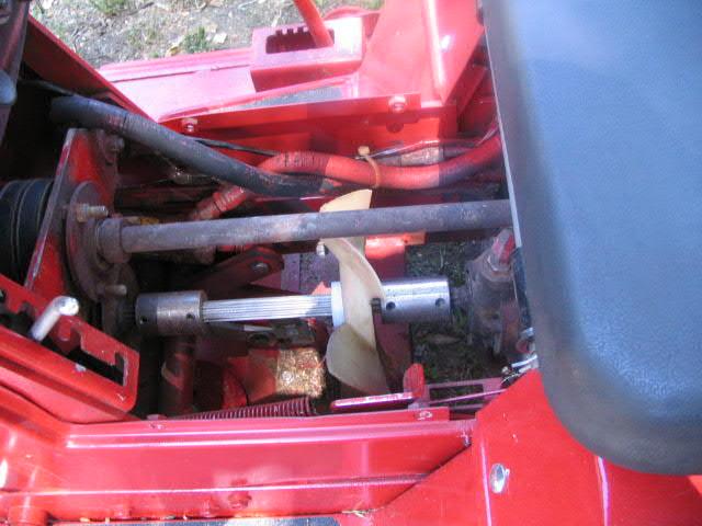

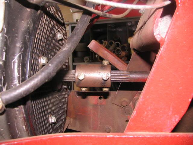

pacer 3,179 #9 Posted February 5, 2020 Some of the Massey Ferguson GT's had this type set-up - driven off the flywheel to a splined shaft. (these pics are of my 1650) Works great ---- except they made the spline 3/4x11 and that makes it almost impossible to find, and of course they get sloppy loose after time. These 2 pics are where I did find Surplus Center had couplers (no shaft) in that size (3/4"x11) and while the new couplers took up a bit of slack it still had a good bit of slack so I added the set screws to the coupler. Again this took a bit more slack out but I just could not get it all tight. It at least should last a good few more yrs. 1 Share this post Link to post Share on other sites
