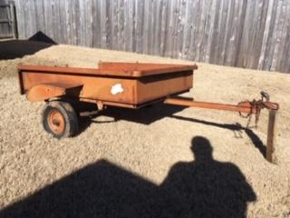

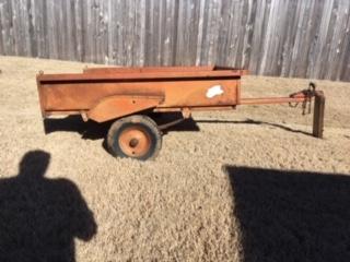

oilwell1415 563 #1 Posted February 3, 2020 A little over a week ago this little trailer popped up on Facebook Marketplace and after about 5 minutes of debate I decided to pick it up. I figure it will be perfect to haul my 552 around and then pull behind the 552 if I go to a show or something. When I picked it up it had air in the tires and seemed OK. That changed when I got about a mile away from the guy's house and the thing started getting squirrely as the air pressure dropped. I ended up being able to go about 20 mph on flat tires all the way home in 50 mph zones. Fun stuff. At least traffic was light. 8 1 Share this post Link to post Share on other sites

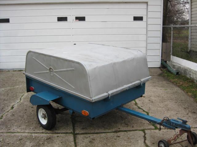

oilwell1415 563 #2 Posted February 3, 2020 I did some research online and found out that it was originally a camping trailer sold as an accessory for Volkswagons. This is a pic of what it originally looked like. The ad said it had high speed tires and a 1-7/8" hitch and was meant for highway use. Maybe in the 50s or 60s when it was built and the speed limit was 55 it was good on the highway, but even with good tires on it I don't think I would want to go down the highway with it. It had 8" wheels on it and I feel like those have to spin way too fast on the highway. 3 Share this post Link to post Share on other sites

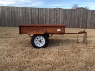

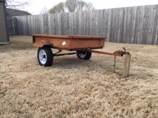

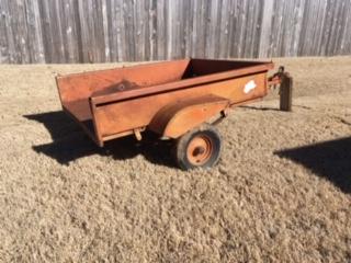

oilwell1415 563 #3 Posted February 3, 2020 Knowing I wanted to haul my tractor on this I knew it would need an axle upgrade and I knew it was getting 12" wheels and tires. Another factor in upgrading the wheels and tires was that the wheels that came on it are spindle mount and that means flat tires are a pain to deal with. A move to hubs with lugs studs and nuts was in order. I wanted the radius of the tires to measure the same as the radius of the fenders, so the first thing I did was measure it and found that it was nearly identical to a 5.30-12. I ordered the wheels, tires and an axle kit online. My goal today was to get the axle welded up and ready to mount, but that went better than I expected and I ended up getting a lot more done than I planned on. Here it is with the axle, wheels and tires installed. Based on the measurements I had originally taken of the tires that came on it, I was thinking that I may have to mount the axle above the leaf springs instead of below it like the original to keep it from being too tall. I ended up not having to do that. The board holding the tongue up in the pics is pretty close to the height of the hitch on our lowest truck that would ever likely pull this, so you can see in the first post that the trailer really needed to be higher so it would ride level. It's almost perfectly level with the new axle and rolling stock. 4 5 Share this post Link to post Share on other sites

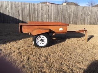

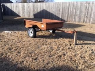

oilwell1415 563 #5 Posted February 3, 2020 (edited) And I still had some daylight left, so I did the thing that really sold me on this trailer. After I looked at the ad a few times I realized that I could swap the fenders side to side and change their angle a little bit and they would look like airplane wings. Once that thought hit me I knew it was a done deal. I've still got to add some more bracing, but I really like the look. After I bought it I actually found that some were installed like this at the factory. Edited February 3, 2020 by oilwell1415 5 4 1 Share this post Link to post Share on other sites

SylvanLakeWH 32,703 #10 Posted February 3, 2020 20 minutes ago, oilwell1415 said: I realized that I could swap the fenders side to side and change their angle a little bit and they would look like airplane wings. I like it!!! Looks much better in my opinion... Very retro... Nice job! 1 1 Share this post Link to post Share on other sites
Pullstart 71,367 #11 Posted February 3, 2020 1 hour ago, oilwell1415 said: And I still had some daylight left, so I did the thing that really sold me on this trailer. After I looked at the ad a few times I realized that I could swap the fenders side to side and change their angle a little bit and they would look like airplane wings. Once that thought hit me I knew it was a done deal. I've still got to add some more bracing, but I really like the look. After I bought it I actually found that some were installed like this at the factory. So much better looking! Nice work saving this cool little VW camper thing! Share this post Link to post Share on other sites
