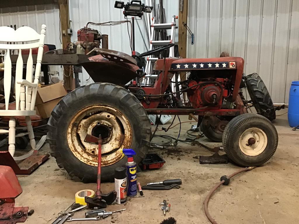

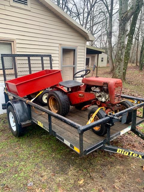

Greentored 3,220 #1 Posted January 31, 2020 (edited) (apologies and moderator feel free to move if this should be in 'engines') Jumping the gun by a few hours due to excitement, but by the time most of you see this thread, a 'field fresh' 654 will be on the trailer and headed to the stable. The catch- no deck and no engine. I'd like to set this one up to do occasional yard work, but for the most part, have an extra pulley and belt and use it as a trail toy/cruiser, maybe even attend a local tractor pull and hook it to a sled for the hell of it. So, for conversation's sake- I need some engine opinions. Find a correct Tecumseh? Look for a Kohler? Or- 1. I have a mildly modified 6.5hp 212cc Predator 'honda clone' off a kart I used to race. It was a Christmas gift from my girlfriend our first year together so its 'kinda' sedimental. 2. Theres a HIGHLY modified 5hp Briggs under the work bench, also off a kart. Wiseco piston, billet rod, billet lifters, BIG cam, set up for alcohol. I'd put it on gas as the carb and fuel tank would need to come off anyhow due to where the engine sits in these. 3. Way back in the archives in the back room, theres a 11hp, 340cc OHV on a McCulloch generator with a broken crank snout. It doesnt have 20 hours on it, and non-tapered cranks are available. Im aware that the OHV stuff would need to be moved rearward due to clearance issues in stock location. Im also aware that this being a tractor, I should be concentrating on torque, not horsepower and rpms, although that Briggs with its lumpy idle and 7000rpm redline would make one helluva head turner. So what should I do? What would YOU do? How beefy are these 3 speeds? Haha PS- those 212 Predators are one HELL of a good engine by the way, especially for 99 bucks at harbor freight. We would pull the governors, change the air filter, pipe, main jet, valve springs, bump the ignition timing, and turn them 5500-5800rpms all day long! The only guys who blew them up were the ones who didnt keep the oil changed, and when they let loose at those rpms, they got picked up with a broom and dust pan Edited January 31, 2020 by Greentored 1 1 Share this post Link to post Share on other sites
ebinmaine 77,325 #2 Posted January 31, 2020 22 minutes ago, Greentored said: HIGHLY modified 5hp Briggs If it's only for a cruiser..... You can (in a way) calm it down by changing the pulleys to adjust the speed as you well know. Horse transmissions are pretty stout... But maybe not made to turn to awful fast.... This could be interesting................ Share this post Link to post Share on other sites
Achto 30,992 #3 Posted January 31, 2020 My first choice would be an 8hp Kohler, hard working engine, easy to get parts. My second choice would be a Predator 212, good engine, very little modifications to make it work. 2 Share this post Link to post Share on other sites
oliver2-44 11,212 #4 Posted January 31, 2020 34 minutes ago, Achto said: My first choice would be an 8hp Kohler, hard working engine, easy to get parts. My second choice would be a Predator 212, good engine, very little modifications to make it work. 1 Share this post Link to post Share on other sites
JoeM 9,618 #5 Posted January 31, 2020 4 hours ago, Greentored said: have a mildly modified 6.5hp 212cc Predator 'honda clone' off a kart I used to race. It was a Christmas gift from my girlfriend our first year together so its 'kinda' sedimental. Good fit and might score you some points! 1 Share this post Link to post Share on other sites
Pullstart 68,878 #6 Posted January 31, 2020 Awesome score! The clone engine will need to be moved back to clear the hood. If you’re prepared to make or modify the belt guard, I’d say that might be the ticket. Is the Briggs in a vertical piston layout like a Kohler or Tecky? Fitment wise, that might be the best candidate. The 11 horse sounds fun too! Share this post Link to post Share on other sites
WHX?? 54,958 #7 Posted January 31, 2020 I can't decide... how bout stretch the frame and all three! 2 3 Share this post Link to post Share on other sites
stevasaurus 23,617 #8 Posted January 31, 2020 I'd say it is OK to post this thread here. The only way I would put an original Tecumseh back on it, is if I had one in the shop. It is getting impossible to find parts for them and the price for parts is through the roof. 8hsp Kohler would be great for trails. 2 Share this post Link to post Share on other sites
Greentored 3,220 #9 Posted February 1, 2020 Thanks guys! She's home, and as an added bonus, he threw the Tecumseh in with it. That would make the decision easy, but I was not aware the parts are getting hard to find for them, and this one needs points, flywheel (tossed a magnet) and carb. Might go on the shelf. Glad to hear a OHV clone is not blasphemy haha. Might peek around for a Kohler 8hp that some of you mentioned. The wagon was the real score! Needed one for yard work and didnt even realize it was a Wheel Horse til I got there. Pristine, stored indoors, 50 beans. Did I do ok? 6 Share this post Link to post Share on other sites

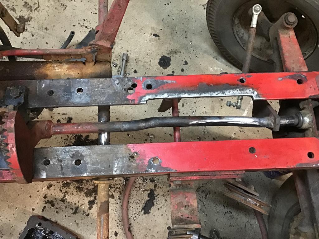

Greentored 3,220 #14 Posted February 6, 2020 (edited) Ok fellas, Im having a moral dilemna here and keep thinking the ol girl needs flathead power, peferably Kohler, and I could unload the Briggs and 11hp OHV and pay for one, or close. The word of the day is torque, which means big displacement, big compression. Can anyone toss me an overall height measurement on their Kohler K's? Sure would be cool to shoehorn a 12-16hp in it, but cutting the hood is not an option. Regardless, it will not be factory stock. I have the skills and equipment to do about anything with these little one lung'rs- wherever the cards fall, it will be mildly ported, relieved, have big compression, and preferably be governed to a connecting rod safe RPM. Edited February 6, 2020 by Greentored Share this post Link to post Share on other sites
ebinmaine 77,325 #15 Posted February 6, 2020 1 hour ago, Greentored said: mildly ported, relieved, have big compression, and preferably be governed to a connecting rod safe RPM Can't help with sizing til later today. Someone will help you sooner. Keep it below 3600 and put the squeeze to it. @VinsRJ did a build on his YouTube channel. I like the idea you have... 1 Share this post Link to post Share on other sites
oliver2-44 11,212 #16 Posted February 6, 2020 A 16hp k341 measures 17-3/4 to to of spark plug. You can reduce that roughly an 1” by going to a low profile oil pan and cutting the connecting rod dipper shorter. There is a thread pinned at the top of the Engine section about blocks and oil pans. Ive talked to one of the puller engine rebuilders about building a stronger worker engine and this is what he said: 1.relieving the top of the block between the valves and cylinder gets the biggest improvement. 2.porting the block intake to match the carb dia. 3 use a bolted on exhaust and match pipe ID to block ID 3 weld up spark plug hole and relocate to center of cylinder 4 remove casting flash from intake and exhaust, but polishing them gets minimal improvement so do the above items first 5 billet rods and cranks are not needed until you exceed 3600 RPM,s 1 Share this post Link to post Share on other sites
ebinmaine 77,325 #17 Posted February 6, 2020 1 hour ago, oliver2-44 said: A 16hp k341 measures 17-3/4 to to of spark plug. You can reduce that roughly an 1” by going to a low profile oil pan and cutting the connecting rod dipper shorter. There is a thread pinned at the top of the Engine section about blocks and oil pans. Ive talked to one of the puller engine rebuilders about building a stronger worker engine and this is what he said: 1.relieving the top of the block between the valves and cylinder gets the biggest improvement. 2.porting the block intake to match the carb dia. 3 use a bolted on exhaust and match pipe ID to block ID 3 weld up spark plug hole and relocate to center of cylinder 4 remove casting flash from intake and exhaust, but polishing them gets minimal improvement so do the above items first 5 billet rods and cranks are not needed until you exceed 3600 RPM,s Any discussion of how much extra horsepower or torque that offers? Relieving the block is a new one to me. I'll have to look up and see how that's done. Share this post Link to post Share on other sites
Pullstart 68,878 #18 Posted February 6, 2020 5 hours ago, Greentored said: Ok fellas, Im having a moral dilemna here and keep thinking the ol girl needs flathead power, peferably Kohler, and I could unload the Briggs and 11hp OHV and pay for one, or close. The word of the day is torque, which means big displacement, big compression. Can anyone toss me an overall height measurement on their Kohler K's? Sure would be cool to shoehorn a 12-16hp in it, but cutting the hood is not an option. Regardless, it will not be factory stock. I have the skills and equipment to do about anything with these little one lung'rs- wherever the cards fall, it will be mildly ported, relieved, have big compression, and preferably be governed to a connecting rod safe RPM. It’ll take quite a bit of work to fit a big block UNDER the hood of a 654. Not exactly the same body, but Frank is a 753 hood and it’s raised up about 3” to clear, plus I modified the steering shaft very heavily to shoehorn the short pan 10 horse in there after notching the frame too. Share this post Link to post Share on other sites
