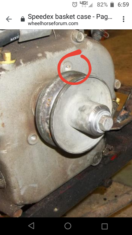

ebinmaine 79,828 #31 Posted January 28, 2020 2 minutes ago, Oldskool said: No it doesn't. Not sure what I will do there You could make up one or two out of 1/8 inch wire that would go in the hole I circled and or maybe one at the lower front if there is one? I'm sure you're well aware of the function of the belt guard being its own guide. I struggled with this quite a lot on the mongrel 1267 that I was trying to build a while back. I changed the size of the engine pulley and I don't think it had the correct belt guard on it. Biggest issue as I see it on your machine is to stop the belt from sagging when you press the clutch. That will force the belt forward on the engine thereby letting it slip around the engine pulley. Share this post Link to post Share on other sites
Oldskool 6,678 #32 Posted January 28, 2020 @ebinmaine I have been trying to find a pic of the underside of the guard to see the guide. With the engine sliding to tighten the belt I think the guide on the engine has to be quite close to the belt 1 Share this post Link to post Share on other sites
ebinmaine 79,828 #33 Posted January 28, 2020 7 minutes ago, Oldskool said: @ebinmaine I have been trying to find a pic of the underside of the guard to see the guide. With the engine sliding to tighten the belt I think the guide on the engine has to be quite close to the belt Agreed. Trina's Pony tractor which is her 657 used to have a Tecumseh engine. I've adapted a Briggs in its place and that was another one I had to make some concessions on, so to speak. The wire belt guides that are on the engine are... maybe 1/16" off the pulley? Share this post Link to post Share on other sites

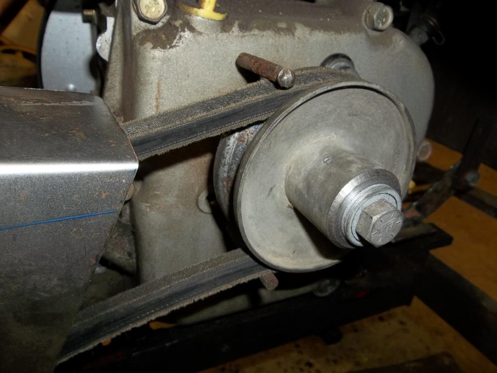

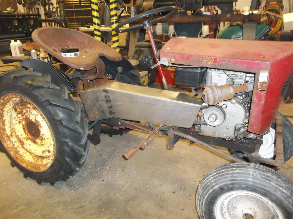

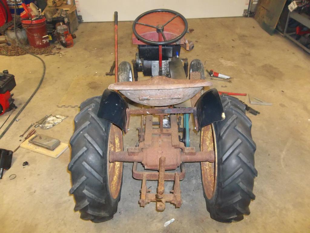

Oldskool 6,678 #45 Posted January 28, 2020 Not much headway today. I did whip up some fenders for the heck of it. Also changed the belt guard a bit. Added some belt guides on the engine 2 Share this post Link to post Share on other sites
ebinmaine 79,828 #46 Posted January 28, 2020 7 minutes ago, Oldskool said: whip up some fenders You mean like in a mixing bowl or something? Those look good. How did those come to be? Share this post Link to post Share on other sites
Oldskool 6,678 #47 Posted January 28, 2020 1 minute ago, ebinmaine said: You mean like in a mixing bowl or something? Those look good. How did those come to be? Thanks. Well you are not far off. They are cut from the top of Weber grill. Waste not want not lol 2 Share this post Link to post Share on other sites

ebinmaine 79,828 #49 Posted January 28, 2020 That is awesome Just showed your barbecue grill fenders to Trina. She says "good job. That is pretty awesome!" Share this post Link to post Share on other sites
Oldskool 6,678 #50 Posted January 28, 2020 4 minutes ago, ebinmaine said: That is awesome Just showed your barbecue grill fenders to Trina. She says "good job. That is pretty awesome!" LOL Tell Trina thank you, and thank you as well 1 Share this post Link to post Share on other sites
