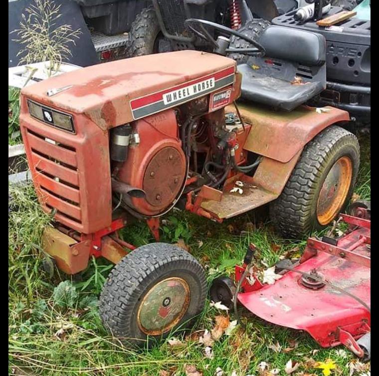

troutbum70 858 #6 Posted January 23, 2020 Here is a picture of the elctro 12. 1 Share this post Link to post Share on other sites

Ed Kennell 47,824 #12 Posted January 23, 2020 If you can get it running and driving with a new battery and starter fluid, chain it to your vehicle and see if the tranny will spin the tires. If it won't, you should be able to negotiate the price down. As stated above, it has parts worth the asking price. lift cyl and valve $100 hub caps $200 electric PTO $100 Seat $100 2 Share this post Link to post Share on other sites

Stepney 2,356 #14 Posted January 23, 2020 I also notice this one has a factory front implement hitch add on. That's a big bonus for running anything built from 1973 to 2006.. so your running newer decks. More easily available and less breakable linkage than the original design. If I could find an E12 here for that price I'd be all over it. Share this post Link to post Share on other sites

ZXT 2,402 #16 Posted January 25, 2020 On 1/23/2020 at 3:48 PM, troutbum63 said: Yes my old commando 800 has the newer mule drive also, I have decided not to grab it. It's been for sale since last fall I thought by now he might take a little less, but so far he has not budged. So I guess he has some knowledge of what he has, and if it's a good one I don't blame him for standing his ground. He isn't budging any because it's worth what he's asking. The seat and caps are worth a good chunk. From the pictures, the tires look like they're holding air - which means it doesn't need tires. If anything, it needs $50 worth of tubes put in. Also hints that it hasn't been sitting all that long. I don't see how you could get hurt on it. I'm saying this as I'm debating on whether or not to buy a $50 D200 that popped up on FB marketplace.. I sent the lady a message but no response as of yet. Share this post Link to post Share on other sites
