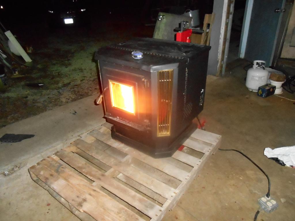

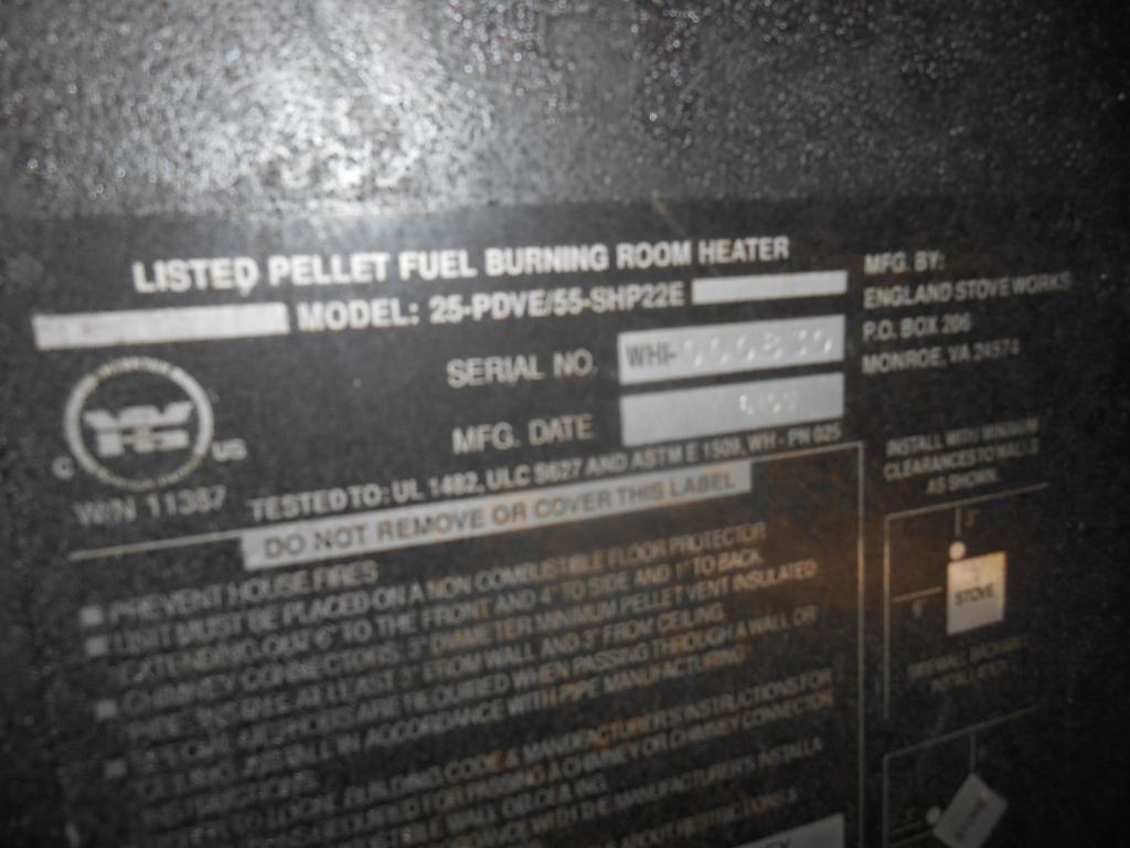

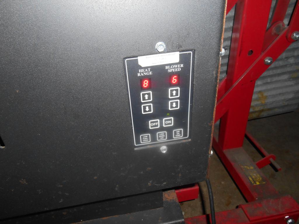

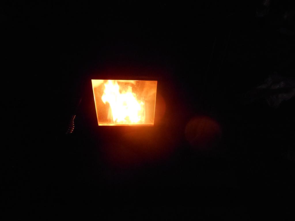

ohiofarmer 3,523 #8 Posted January 22, 2020 Here are the pics. The unit is a 25 series of Englander with nice options like electronic speed controls. I fired it up last night in the open bay and there was no visible smoke at any time. It puts out plenty of heat after a half hour from a cold start with the unit. After reading the manual and observing the lack of any smoky scent in the exhaust smell, I have determined that this stove will not be run indoors until and unless a CO detector is present. After research, I found that it is rated for 2200 Sq ft. My insulated shop is 1350 or so.. This stove is rated with direct contact at the base with the only concern being sparks during clean out. It only needs 6" of clearance at the back and 3" at the sides. Glad i have the motorcycle lift/ pallet jack [shown in one pic] that can lift it 30". I am thinking about running the exhaust through a heat saver.. at 25 degrees. 2 3 Share this post Link to post Share on other sites
