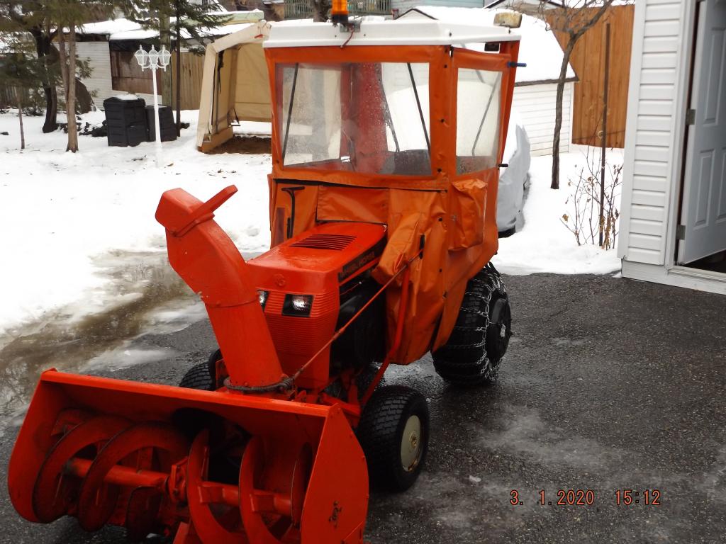

Denis L Goulet 22 #1 Posted January 12, 2020 (edited) hi can someone tell me the chain routing on a 1996 44 inch, 2stage,79361 snow thrower, from pictures I cant see if chain goes around tension block or not. or does the block lean on chain to take the slack. Edited January 12, 2020 by Denis L Goulet spelling mistake 1 Share this post Link to post Share on other sites
