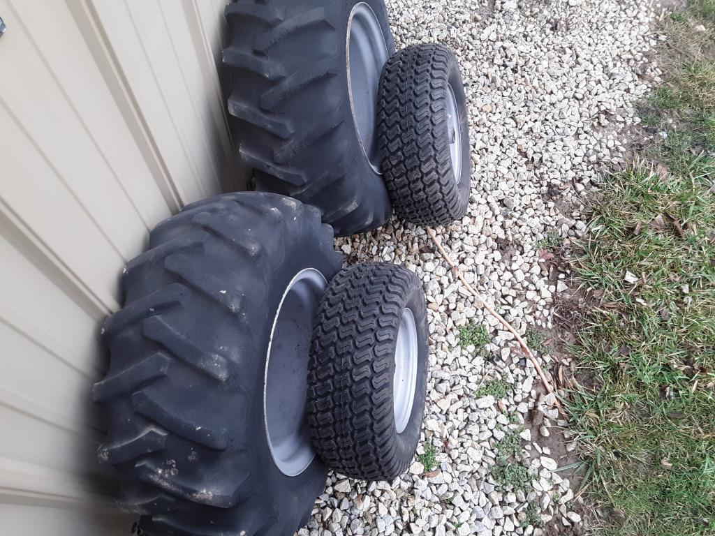

briankd 833 #6 Posted January 12, 2020 finished up blasting today i mounted new tires up on the fronts got theses tires last summer from a vendor at a show i was at last summer. they are 8 by 6.50 thought they would look at little wider after i mounted them theses rims about the same as my 857 has.the front end was damaged sometime in the past it has a newer spindle on one side which has cotter pin and other has a bolt holding wheel on and one rim is a little diff. than the other. the rears on this here must be original i never knew WH had this option talking to my dealer and he sold this tractor new with this rear tire option and i found the original owners name on this when tearing it down and i actually know the guy went to school with his son from k- 12 grade . I bought tubes and putting them in theses rears they have some dry rot but still hold air this was sold new in late 1975 with 48 inch side discharge deck which i have and a rear mount tiller which don't know what happened to it so that why it has bar tires instead turfs this is my other tractor i restored about 12 yrs ago and been working it ever since and when done with this one will be using to to mow with and maybe get rid of my green one 6 1 Share this post Link to post Share on other sites
