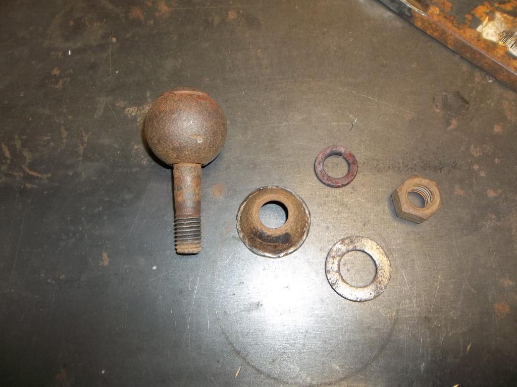

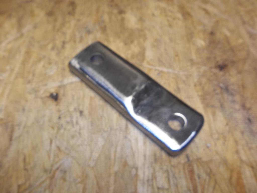

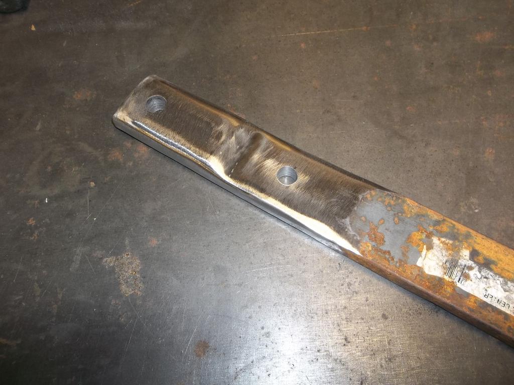

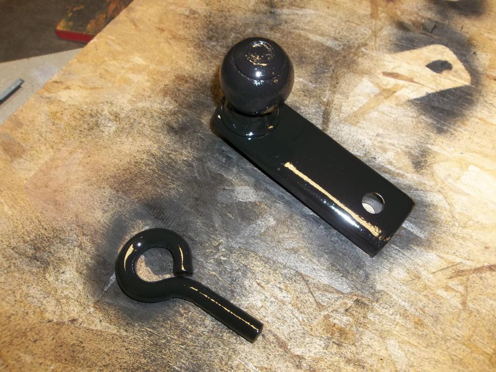

Oldskool 6,678 #108 Posted January 22, 2020 Had some spare time before supper so I thought I would make a hitch for the tractor. What good is a tractor without a hitch right? 3 Share this post Link to post Share on other sites
Oldskool 6,678 #109 Posted January 22, 2020 I was lucky enough to find a vintage trailer ball and it was 1 7/8. Matches all our trailer couplers 2 Share this post Link to post Share on other sites
Oldskool 6,678 #111 Posted January 22, 2020 (edited) Painted with VHT wrinkle paint. I have had good luck with it not wearing off as easy Edited January 22, 2020 by Oldskool 2 1 Share this post Link to post Share on other sites
ebinmaine 80,325 #112 Posted January 23, 2020 Nice work there mr skool Share this post Link to post Share on other sites

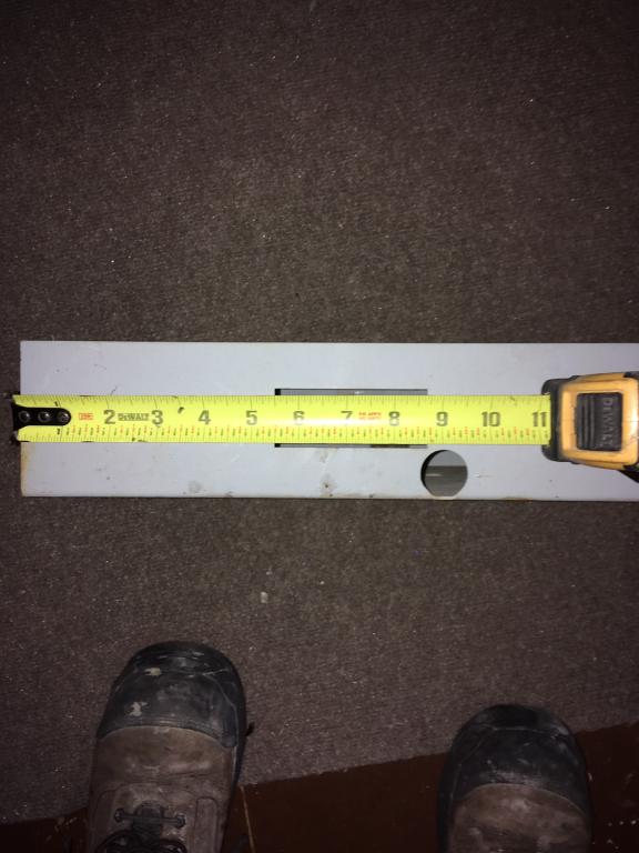

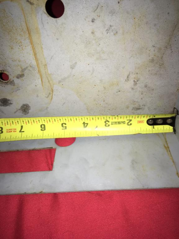

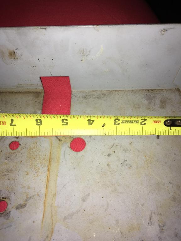

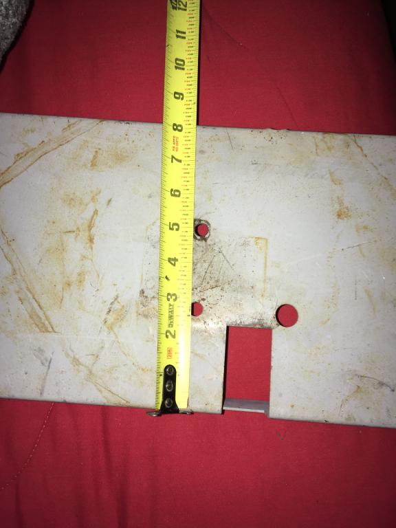

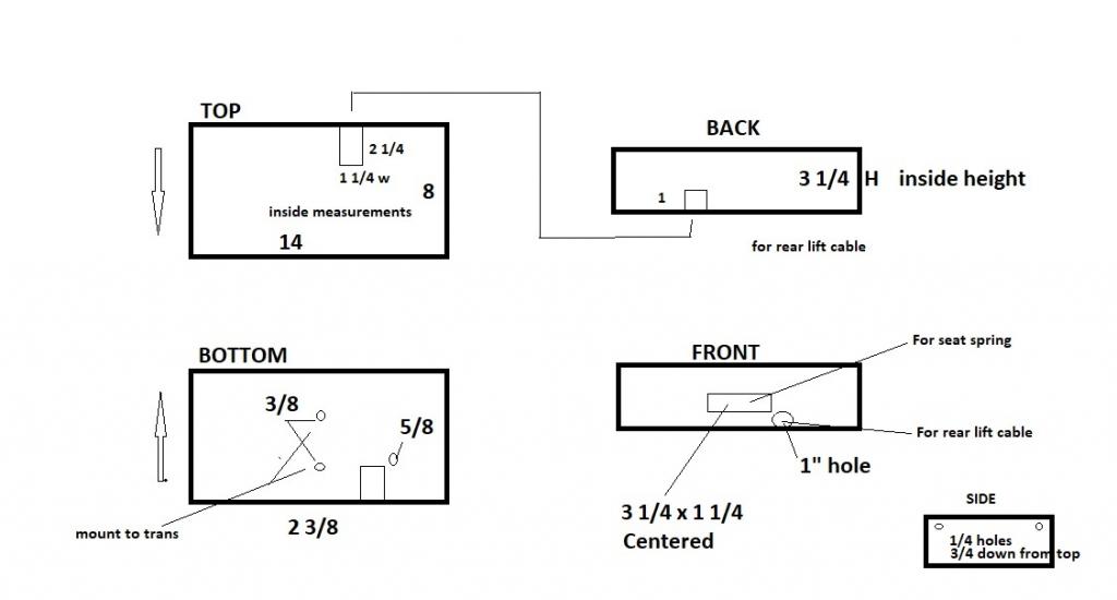

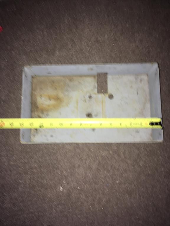

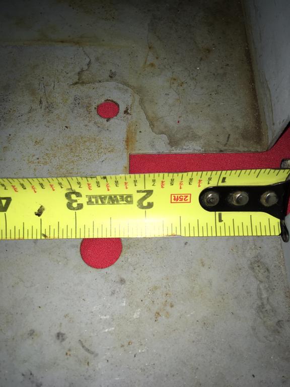

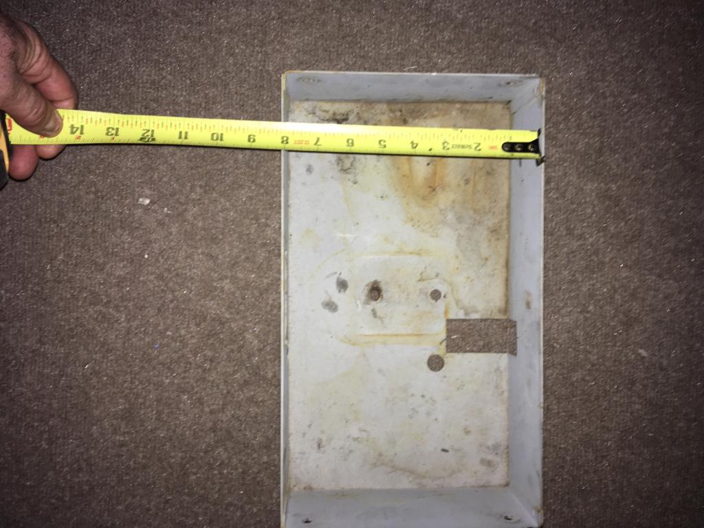

wallfish 20,510 #122 Posted January 25, 2020 Found the box. If this doesn't work, I can just send you the box and you can send it back. The measurements were taken from the inside so it can be laid out on the flat piece and marked for bending. 1 Share this post Link to post Share on other sites
