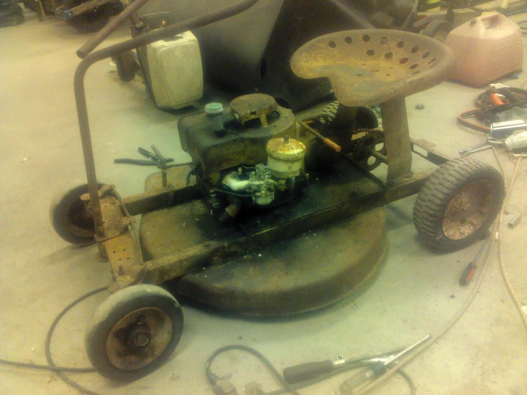

Oldskool 6,678 #36 Posted January 12, 2020 Also gathered up this little gem. Don't know what it is, but thought it needed a new home. Might gather up "what I believe to be a Speedex s23 tractor basket case". Still on the fence on that one 3 Share this post Link to post Share on other sites

ZXT 2,402 #39 Posted January 12, 2020 17 minutes ago, Oldskool said: Also gathered up this little gem. Don't know what it is, but thought it needed a new home. Might gather up "what I believe to be a Speedex s23 tractor basket case". Still on the fence on that one That seat bracket makes me want to say Mowett, but I've never seen one with that style of steering. 1 Share this post Link to post Share on other sites

ebinmaine 80,345 #42 Posted January 12, 2020 9 hours ago, Oldskool said: Also gathered up this little gem. Don't know what it is, but thought it needed a new home. Might gather up "what I believe to be a Speedex s23 tractor basket case". Still on the fence on that one Cute little thing isn't it?? Tiller steer is interesting. @Stepney Spenser check this out... The Speedex.... I'd love one... 1 Share this post Link to post Share on other sites
Oldskool 6,678 #43 Posted January 12, 2020 58 minutes ago, ebinmaine said: Cute little thing isn't it?? Tiller steer is interesting. @Stepney Spenser check this out... The Speedex.... I'd love one... The Speedex.. Its a basket case but its for sale Share this post Link to post Share on other sites

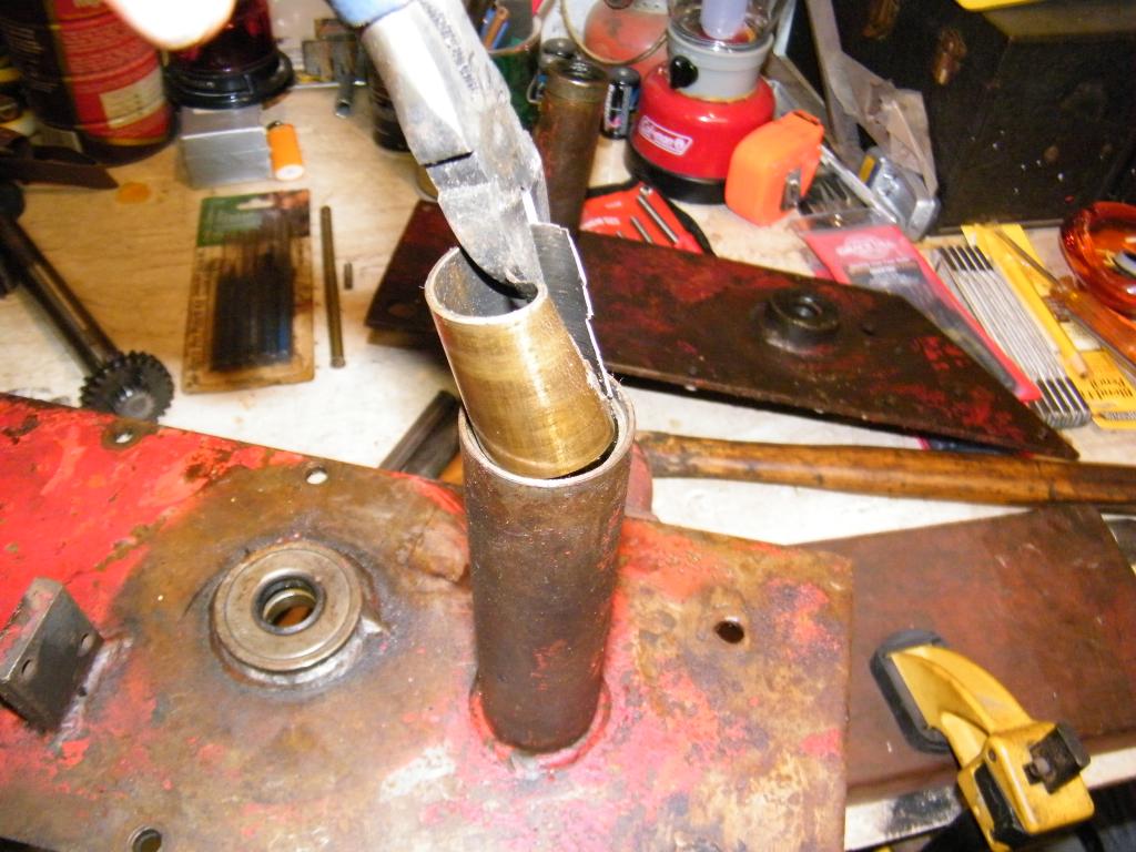

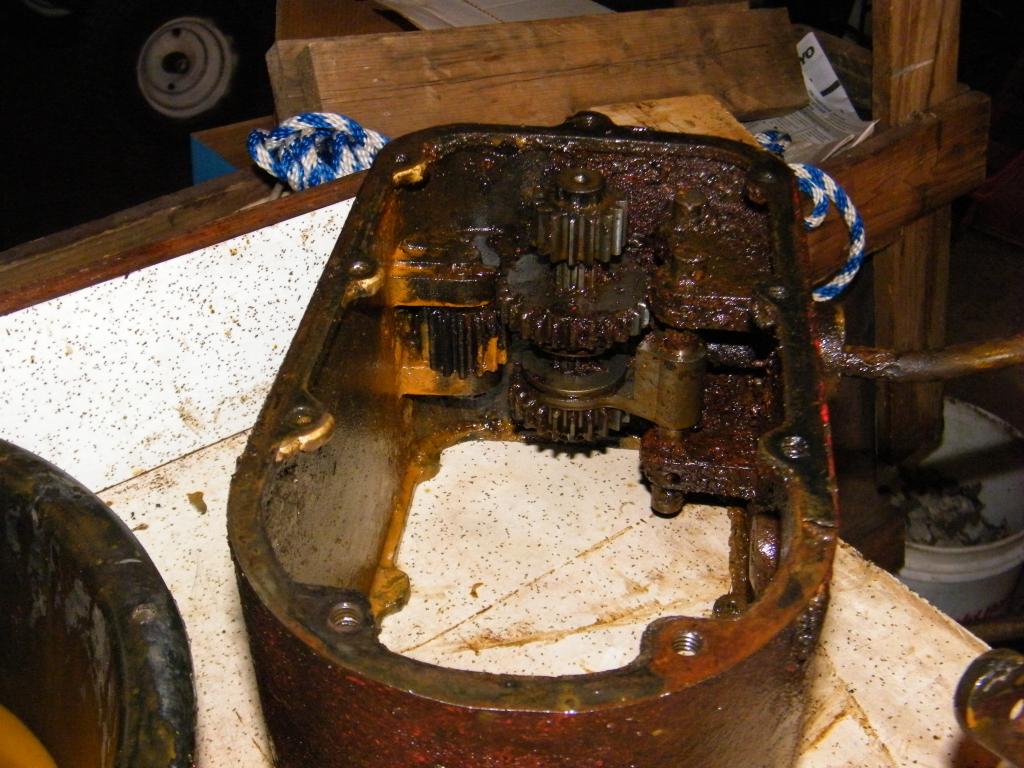

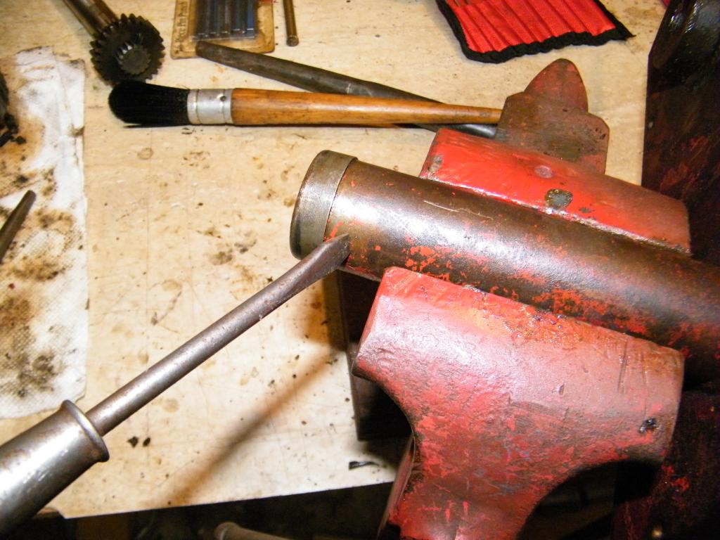

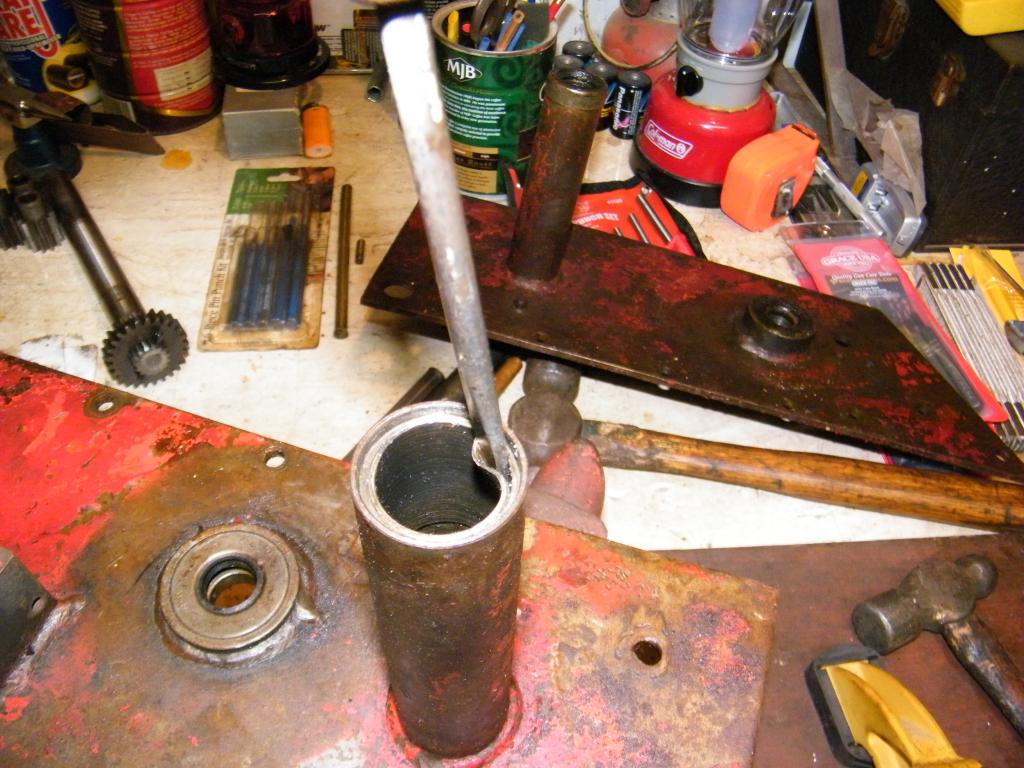

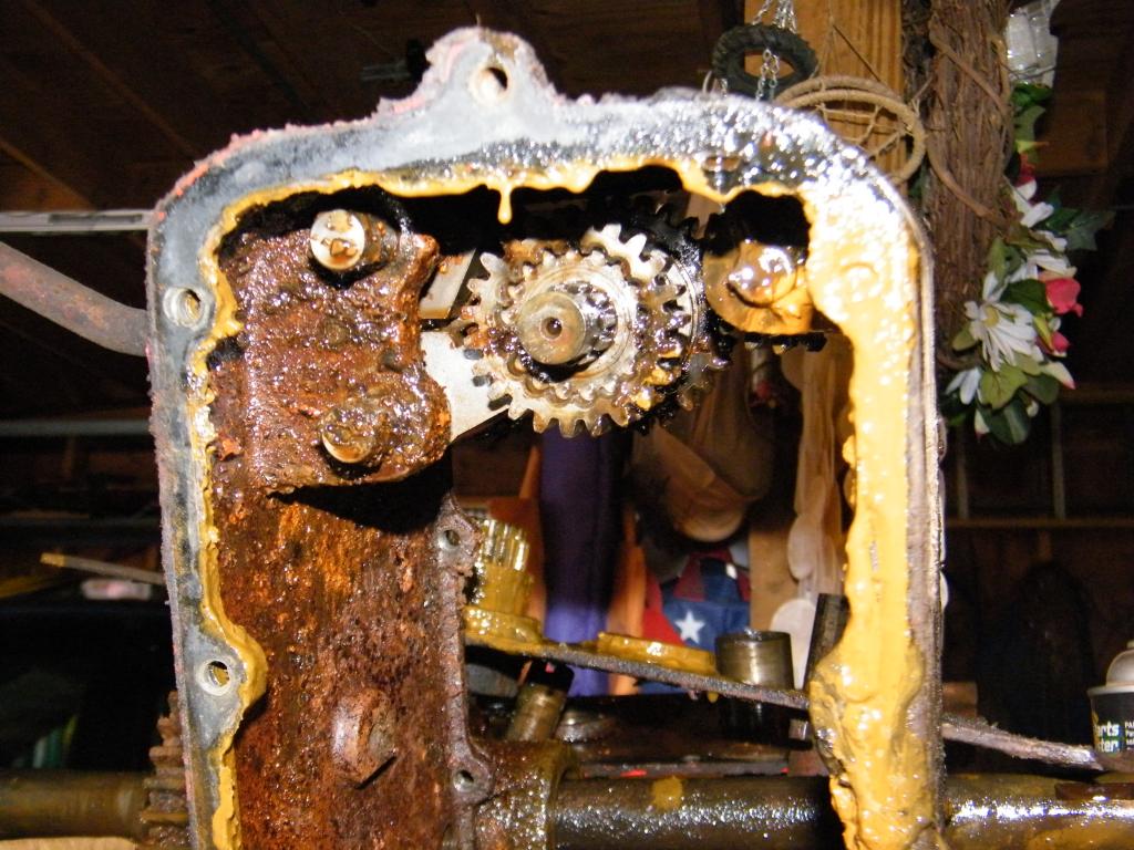

wallfish 20,511 #46 Posted January 12, 2020 12 hours ago, Oldskool said: It looks like they were leaking for a while. Just more so now with the diesel. Unfortunately the "bearings" inside the trans are actually bronze bushings. They're typically worn after 60+ years of use and the axle shaft wobbles in the hole. New seals won't seal that condition. BUT fortunately, you can get all the parts and follow the video tutorial by @stevasaurus to rebuild that trans and fix it properly. 1 Share this post Link to post Share on other sites
stevasaurus 23,805 #47 Posted January 12, 2020 Welcome to Red Square. That RJ sure is a nice find. If you are leaking by the rear axle bushings, you will want to replace them. You have to open the transmission to do that. Another reason to open the transmission...you stated that it was 1/2 full of water for quite a while. Pull out the shifter (loosen the lock nut and back out the 1/8" Allen Head set screw) then lift the shifter out. Keep transmission in neutral. Loosen and take the 2 bolts out of the spring holding it to the transmission. Look down the 3 holes with a good flashlight. If you see anything like this...all the flushing in the world is not going to clean all that out. You should also pull the hubs off and carefully tap off the seals (they are already leaking anyway), then you can see the end of the axle bushing. You are looking to see if the bronze is equal in thickness all the way around the axle. Move the axle up and down and side to side to see any play. Play should be little to none. Tap off seal Bad bushing...see how thin it is near the bottom? How to pull out bushing. 2 4 Share this post Link to post Share on other sites
wallfish 20,511 #48 Posted January 12, 2020 @Oldskool You're gonna get skooled on that tranny now! Once I tagged Steve about the trans in the above post, he's gonna be all over this like Oprah on baked ham! Follow his direction and it'll end up good as new. 1 4 Share this post Link to post Share on other sites
