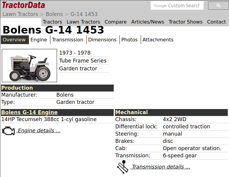

bc.gold 3,406 #6 Posted January 11, 2020 If I got the right Bolens model from tractor data, says that tractor has a tube frame you might want to give special attention to while looking the tractor over. Also appears that the Tecumseh has a modified oil pan which is proprietary to the tube frame tractor, you might look at an early cub cadet narrow frame tractor that had a Kohler engine as a swap over candidate as they used a similar oil pan. Share this post Link to post Share on other sites

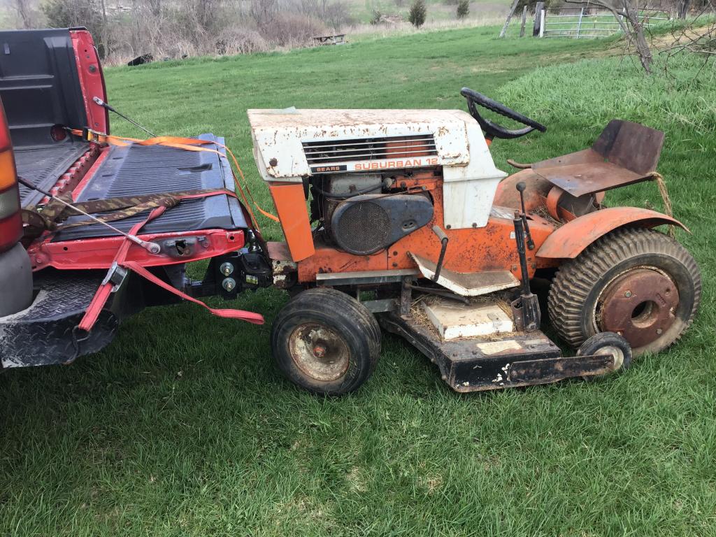

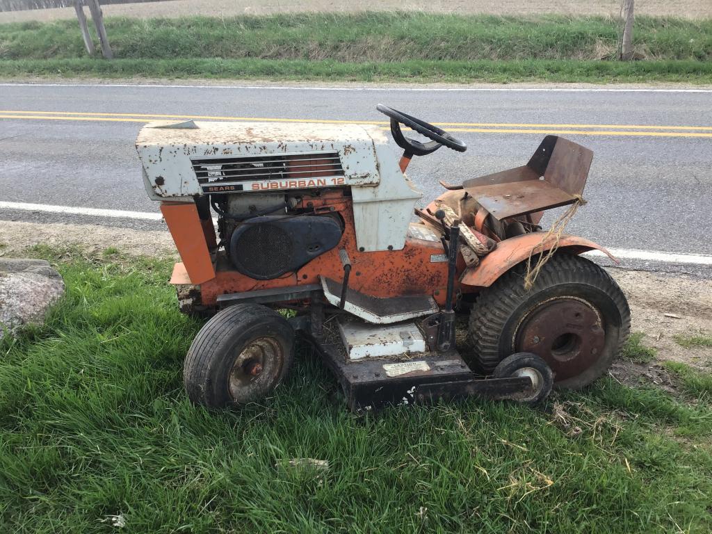

Pullstart 70,909 #11 Posted January 12, 2020 Last summer I found laying waste at the roadside a Sears Suburban 12 with two sets of stacked weights. It’s funny how that works, I’d been looking for wheel weights too and couldn’t justify the going rate to buy a set. Then they plopped into my lap! Share this post Link to post Share on other sites
