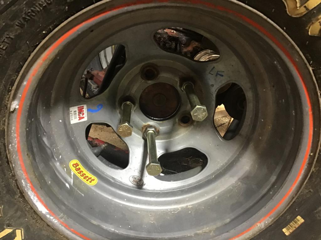

Pullstart 71,259 #177 Posted January 26, 2020 18 minutes ago, Tractorhead said: Have you verified you markings with a circle ? as far as i see on the pics, it is just one mark de-centered. But anyhow, good job 👍 Just verified by eyeball, but if they are off by just a bit I bet nobody will notice. I plan on using NASCAR style 5/8”-11 lug nuts, they’ll hold everything on just fine. I’ll probably toss a nut on the back side of the bolts holding the adapters to the hub as well. 1 Share this post Link to post Share on other sites

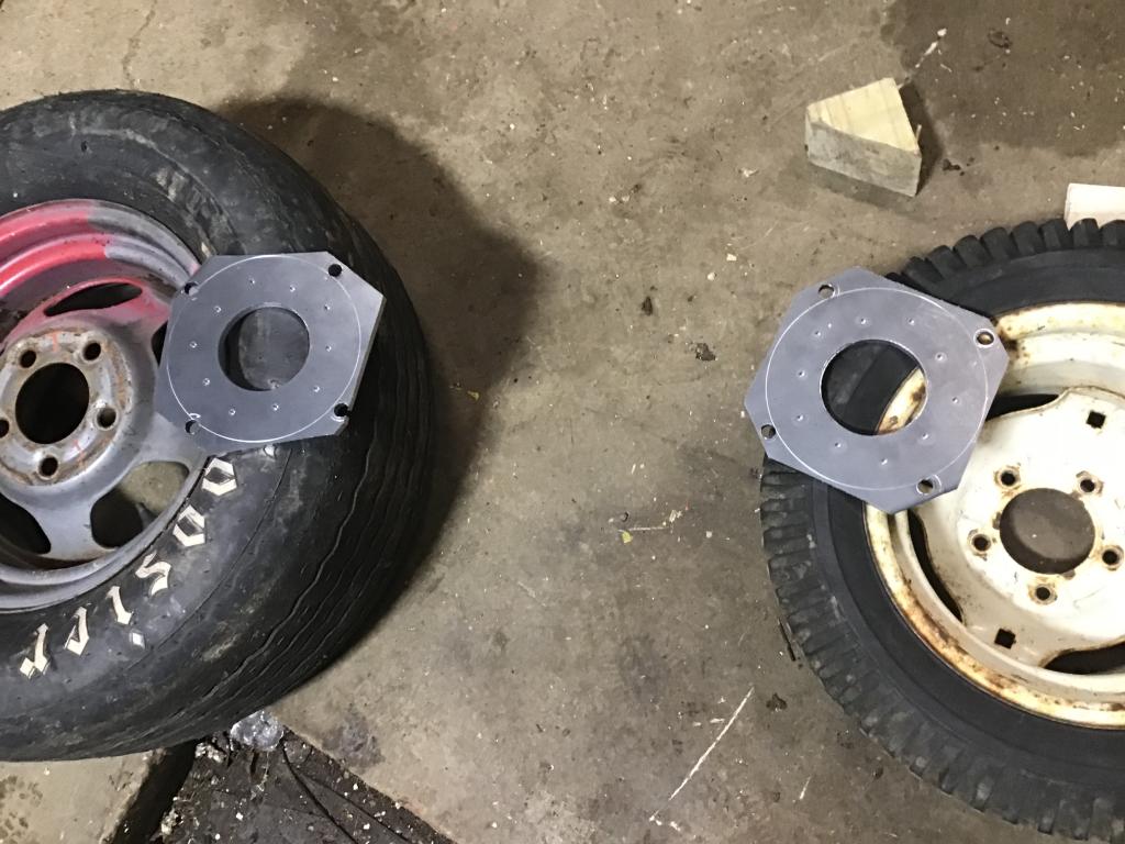

Pullstart 71,259 #183 Posted January 26, 2020 1 minute ago, wallfish said: Just changing the rims, probably order the adapters and get on with something else. It’s more on the idea that I might be able to pull these off. I’m by no means getting into the adapter business 3 minutes ago, oilwell1415 said: That’s awesome that you’ve got a connection to the Petty family. I’m a life long Richard Petty fan and was crushed when Adam died. One of my other hobbies is collecting Petty memorabilia. Most of our house is decorated in 43 stuff. I’ve got one room fully dedicated to it and it appears in most of the others at least a little bit. Personally I have no connection, but I wish I was around back then! We have pictures of Dave and Adam hanging out in pits. My wife and Adam had an agreement that if she wasn’t married by such a date, they would get hitched Here’s one of Dave’s ASA autograph cards with the Spree sponsorship on the hood. Spree was Adam’s main sponsor. 1 Share this post Link to post Share on other sites

Pullstart 71,259 #189 Posted January 26, 2020 Good decision or not, this feels really good. Obviously, I’m lacking proper hardware. It’ll arrive soon. 5 1 Share this post Link to post Share on other sites

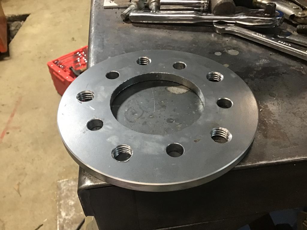

Pullstart 71,259 #192 Posted January 26, 2020 Other than chamfers for the flat head screws and a little clean up work, this one’s finished. I’ll pop the other one off and clean up the rough edges too. 4 1 Share this post Link to post Share on other sites

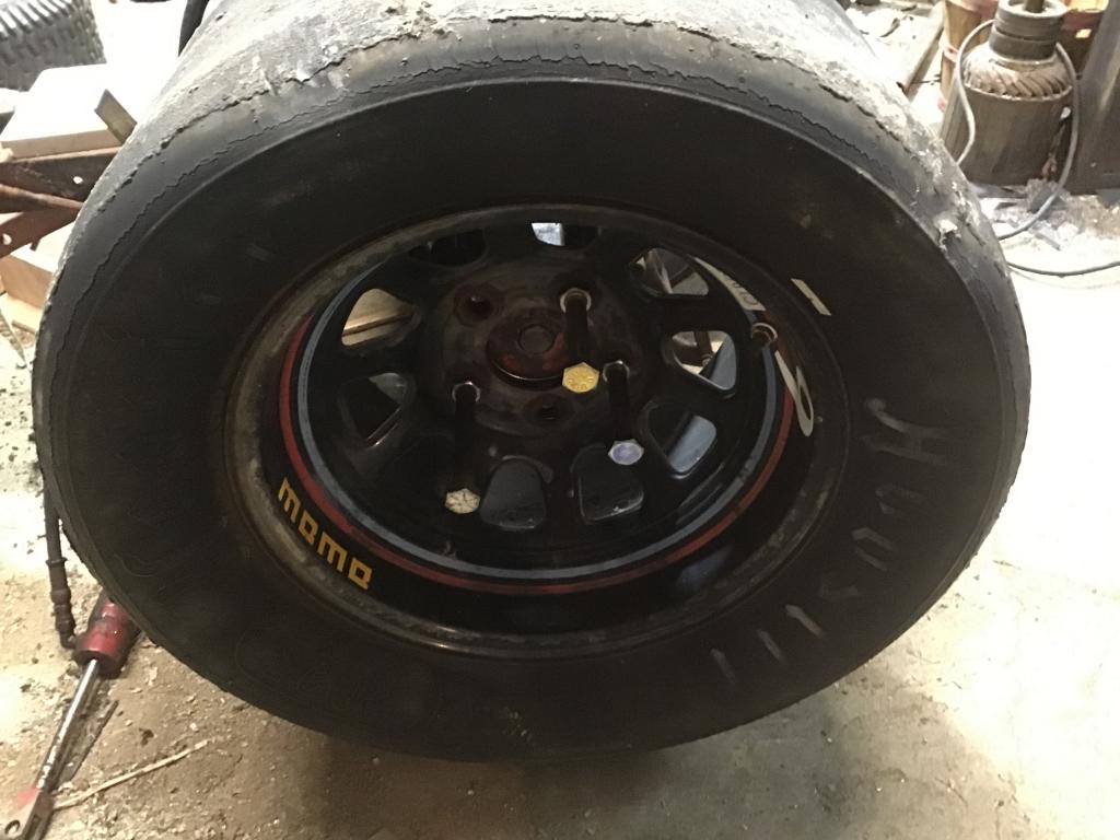

Pullstart 71,259 #194 Posted January 26, 2020 Second one spun.. 1 1 Share this post Link to post Share on other sites

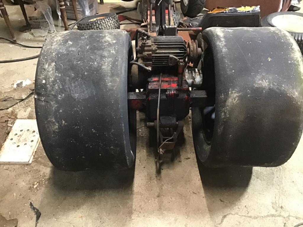

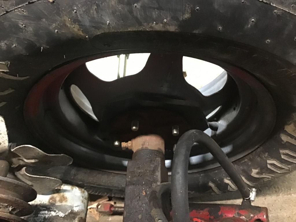

Pullstart 71,259 #196 Posted January 26, 2020 Bad news / different news. I was right last night. The adapter didn’t fit a wheel. The wheels are different. out with the 8” wheels, in with the 10” ASA wheels! Once I swap the treaded tires, I think I’ll clear the fan. If not, I’ll get a single pulley or look for a cast one with an integrated fan. 1 2 1 1 Share this post Link to post Share on other sites
8ntruck 9,305 #197 Posted January 26, 2020 (edited) Or make the adaptors thicker to increase the track and make more room between the wheels. Wide wheels/tires and a wider track will increase the load on the axle and axle bearings - the distance between the tire loads is wider, creating a longer distance the axle has to 'bridge'. I'm not sure the relatively low weight of the tractor will make this something to worry about, though. Edited January 27, 2020 by 8ntruck 1 1 Share this post Link to post Share on other sites
ebinmaine 80,746 #198 Posted January 27, 2020 13 minutes ago, 8ntruck said: creating a longer distance the axle has to 'bridge'. I'm not sure the relatively low weight of the tractor will make this something to worry about, though Good observation. IMHO.... Concern of overloading bearings would be based on potential load of dump area. Horse transmissions are built well and hold a load well. 1 Share this post Link to post Share on other sites
Pullstart 71,259 #199 Posted January 27, 2020 38 minutes ago, 8ntruck said: Or make the adaptors thicker to increase the track and make more room between the wheels. Wide wheels/tires and a wider track will increase the load on the axle and axle bearings - the distance between the tire loads is wider, creating a longer distance the axle has to 'bridge'. I'm not sure the relatively low weight of the tractor will make this something to worry about, though. If I have to space the wheels out I will, otherwise the lesser offset of the 10” wheels I’d imagine would ease the stress on the bearings? I’m heading out to swap the tires and see how it all stacks up. Either way, this trans will receive new bearings and seals before final assembly. 1 Share this post Link to post Share on other sites
953 nut 69,377 #200 Posted January 27, 2020 38 minutes ago, 8ntruck said: Or make the adaptors thicker to increase the track and make more room between the wheels. Wide wheels/tires and a wider track will increase the load on the axle and axle bearings - the distance between the tire loads is wider, creating a longer distance the axle has to 'bridge'. I'm not sure the relatively low weight of the tractor will make this something to worry about, though. As wide as those tires are the load center the bearings feel will be about the same as a stock 12" wheel and tire. Besides, that is such a COOL LOOK! @pullstart should build a dragster rather than a dump truck. 2 1 1 Share this post Link to post Share on other sites
