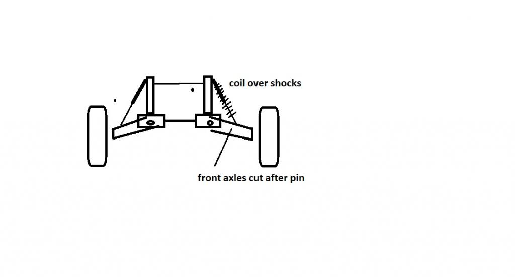

Pullstart 71,259 #76 Posted January 9, 2020 2 hours ago, wallfish said: I can probably find some but it was offset with a couple of sprockets and a chain. Just a quick thought for something more "heavy duty" is to use a couple of universal joints in the shaft and maybe in the steering wheel shaft too. A Ross type of steering mechanism would be easy to offset and give reliability. Or, if your ambitious enough, a plan I have for a build is use two frames welded side by side, cut one side off of two front axles after the axle pin and use coil over shocks from a frame to the front axles for front suspension. Now the frame will be wide enough to easily offset the steering with different length tie rods That is a pretty awesome idea! I was thinking. If I do use two frames for the stretch, I could flip the rear frame to weld them together. It would look like a Z’d frame and add a lot of welding space! I’m unsure of the total length needed, so I might just have to play mock up for a while with basic shapes until I get where I’d like to be. Share this post Link to post Share on other sites

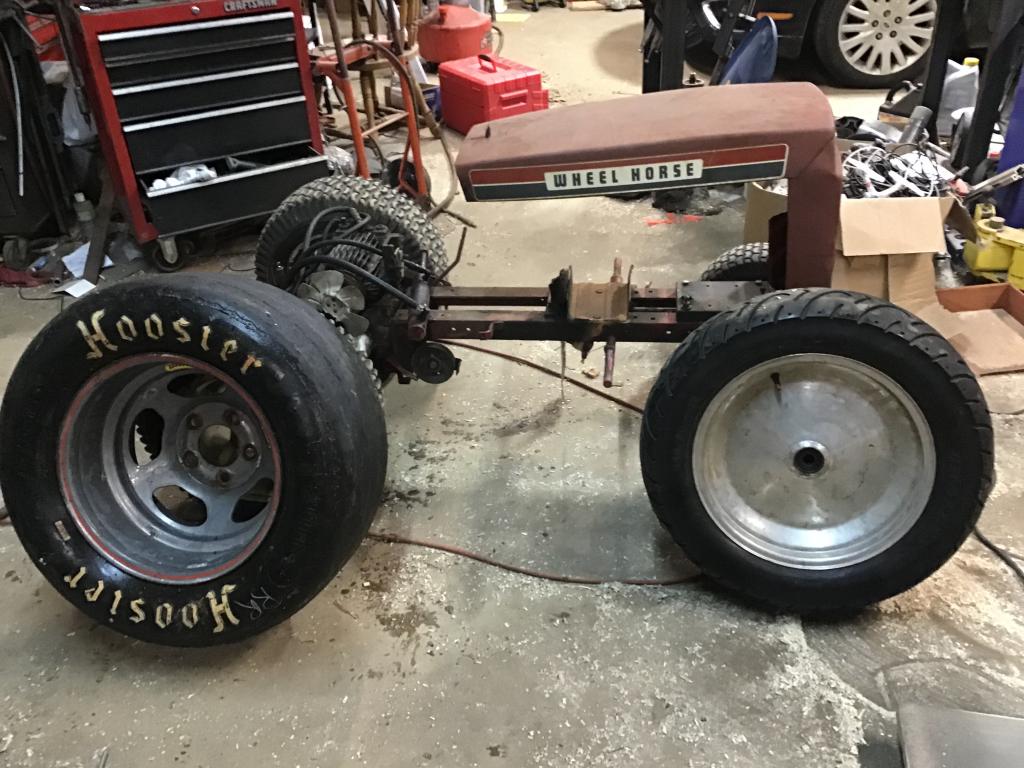

wallfish 20,618 #79 Posted January 9, 2020 Basic idea 1 1 Share this post Link to post Share on other sites

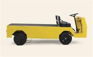

wallfish 20,618 #80 Posted January 9, 2020 You can use a snow blade in front of the front tires an make a seat, floor and short console and sit over the front tires. Search Cushman images if you're looking for old school or UTV for more modern looking syle. 1 Share this post Link to post Share on other sites

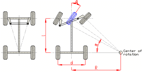

Pullstart 71,259 #82 Posted January 10, 2020 (edited) I’ve been reading more into Ackerman steering. It’s funny, Mr. Ackerman didn’t come up with the idea, he was a lawyer that stole and patented it! I wonder if anyone’s ever checked a Wheel Horse for Ackerman in stock form, how close it might be? Regardless, my plan is to customize the spindles’ steering arms for the stretch and try to get it closer than just using stock spindles and calling it good. Edited January 10, 2020 by pullstart Photo 1 Share this post Link to post Share on other sites

wallfish 20,618 #84 Posted January 11, 2020 22 hours ago, pullstart said: I wonder if anyone’s ever checked a Wheel Horse for Ackerman in stock form, how close it might be? Never measured it but you can easily observe the difference in the angle of the tires when turned all the way. I'm not so sure it needs to be deadly accurate but it does make a difference to have each wheel tracking close to the correct radius. Otherwise, they are skidding to make up the difference which my guess would be mostly on the inside tire since the outside would probably have more traction from the weight transfer during the turn. 3 Share this post Link to post Share on other sites

wallfish 20,618 #89 Posted January 12, 2020 I've built stretched tractors and noticed the difference immediately for the better when the angles were corrected for the longer wheel base. It would drift in the front and the turning radius was ridiculous. Seemed like it needed a football field to turn around. The angle doesn't need to be 100% accurate going that slow like it would going fast. Does it need to be done, without a doubt no, but it will definitely track better and make a difference if it is done. Correcting the angle made mine steer noticeably better, then I ground off the stops so it could get an even tighter turn. Do the front angles last and try it out first without changing them, If you're not happy then correct them to match the wheel base and see if it makes any difference. 2 1 1 Share this post Link to post Share on other sites
Lee1977 7,779 #90 Posted January 12, 2020 (edited) If you make a longer set of tie rods and go to the back of the steering triangle the inside wheel will turn sharper.l Edited January 12, 2020 by Lee1977 2 1 Share this post Link to post Share on other sites
8ntruck 9,304 #91 Posted January 12, 2020 Kevin - you trying to start a Pro Street trend on garden tractors with those big tires? Ackerman will help turn a long wheel base tractor. Ackerman is not desire able on a dirt track car, 'cause you are turning right to go left. 1 Share this post Link to post Share on other sites
Pullstart 71,259 #92 Posted January 12, 2020 Bill, I don’t plan on going that fast... but if my girls get behind the wheel.... that’s another story. 4 Share this post Link to post Share on other sites
ebinmaine 80,743 #93 Posted January 12, 2020 8 hours ago, Lee1977 said: If you make a longer set of tie rods and go to the back of the steering triangle the inside wheel will turn sharper.l @pullstart this'll help too. I've done it as well. At slow speed the inside tire should grip enough to grab into the turn a little. Share this post Link to post Share on other sites

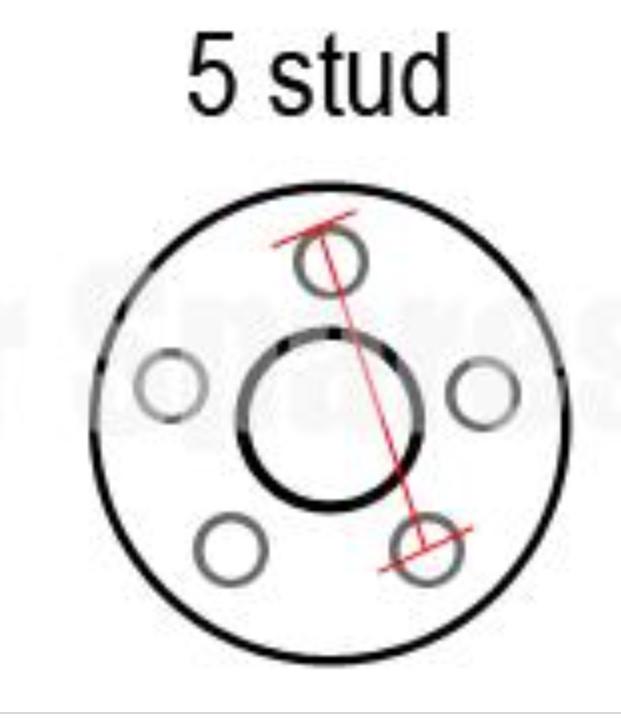

Pullstart 71,259 #94 Posted January 15, 2020 Quick question for anyone with CAD skills, or more time on their hands than I do. I am looking for the centerpoint bolt radius for the following bolt patterns: 5 on 4-1/4 5 on 4-1/2 5 on 4-3/4 there’s a rotary table here for the Bridgeport Mill. I thought it would be fun to make some wheel adapters for myself. If I can pick up the center of the piece, I’ll be able to drill and tap what is needed where needed. I just don’t know an easy way to find my radius. Share this post Link to post Share on other sites

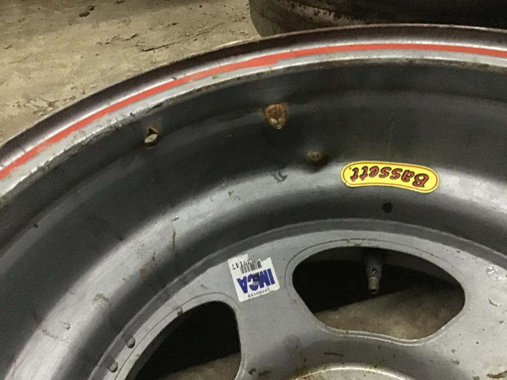

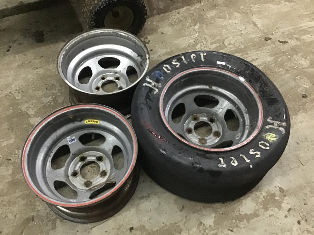

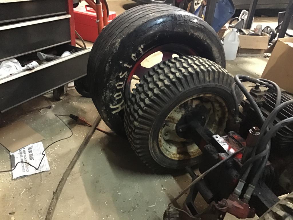

Pullstart 71,259 #95 Posted January 15, 2020 I found three wheels in the “junk” pile that I believe are the same. They’re 5 on 4-3/4 according to this drawing. One of the two with red pinstripe have fallen victim to friendly fire. They were in an old pickup that was used to sight in a new .223 that my buddy picked up last fall. I believe the other one is a match that has been painted over at one time. Share this post Link to post Share on other sites

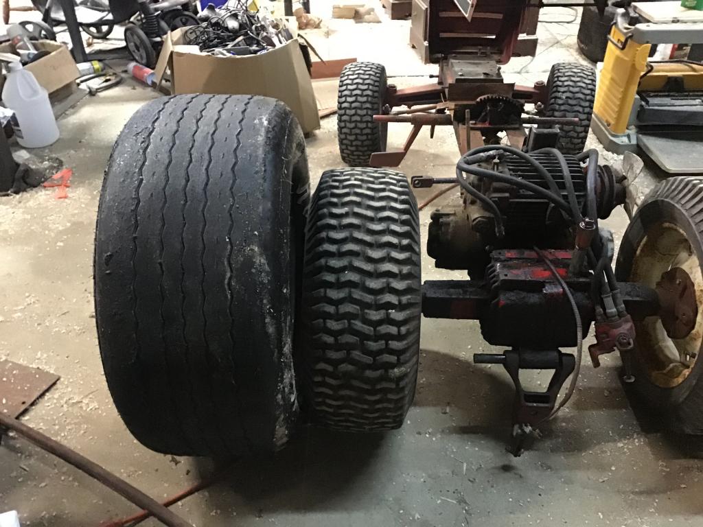

Pullstart 71,259 #96 Posted January 15, 2020 Yep, these’ll do. They are 27x8-15’s measuring just about 26-1/2” tall... overall width about 11-3/8”. For comparison, the GT tires are 22.5x7.5-12. 1 1 Share this post Link to post Share on other sites

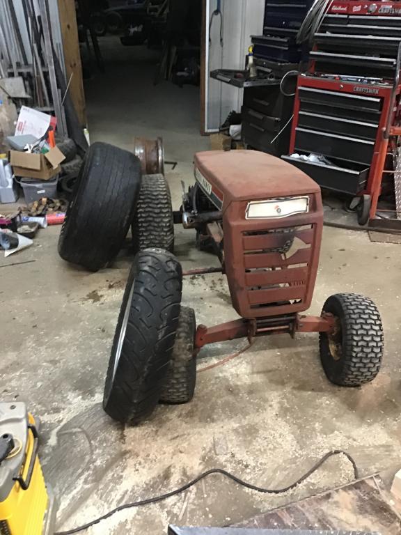

Pullstart 71,259 #97 Posted January 15, 2020 Fronts... if I decide to go this big, I’m seeing a custom set of spindles in the future... if not the VW donors that the wheels came from. 3 Share this post Link to post Share on other sites

8ntruck 9,304 #99 Posted January 16, 2020 On 1/14/2020 at 8:18 PM, pullstart said: Quick question for anyone with CAD skills, or more time on their hands than I do. I am looking for the centerpoint bolt radius for the following bolt patterns: 5 on 4-1/4 5 on 4-1/2 5 on 4-3/4 there’s a rotary table here for the Bridgeport Mill. I thought it would be fun to make some wheel adapters for myself. If I can pick up the center of the piece, I’ll be able to drill and tap what is needed where needed. I just don’t know an easy way to find my radius. I did some trig. and came up with the following bolt center to bolt center distances per your sketch: 5 on 4 1/4 is 4.042 5 on 4 1/2 is 4.279 5 on 4 3/4 is 4.518 The above distances will help you determine the bolt circle on an existing wheel. If you want a radius from the center of the wheel to the bolt center, you divide the bolt circle diameter by 2: 5 on 4 1/4 is 2.125 radius 5 on 4 1/2 is 2.25 radius 5 on 4 3/4 is 2.375 radius The angle you need to turn your rotary table between bolt holes is 72 degrees (360/5). I worked in the OEM wheel industry for 40 years. This is easy peasy stuff. Hope it helps. 1 1 1 1 Share this post Link to post Share on other sites
Pullstart 71,259 #100 Posted January 16, 2020 6 hours ago, 8ntruck said: I did some trig. and came up with the following bolt center to bolt center distances per your sketch: 5 on 4 1/4 is 4.042 5 on 4 1/2 is 4.279 5 on 4 3/4 is 4.518 The above distances will help you determine the bolt circle on an existing wheel. If you want a radius from the center of the wheel to the bolt center, you divide the bolt circle diameter by 2: 5 on 4 1/4 is 2.125 radius 5 on 4 1/2 is 2.25 radius 5 on 4 3/4 is 2.375 radius The angle you need to turn your rotary table between bolt holes is 72 degrees (360/5). I worked in the OEM wheel industry for 40 years. This is easy peasy stuff. Hope it helps. Bill, that is awesome! Thanks a ton! I’ll definitely be using these numbers, and have a feeling they’ll be useful for years to come! 1 Share this post Link to post Share on other sites
