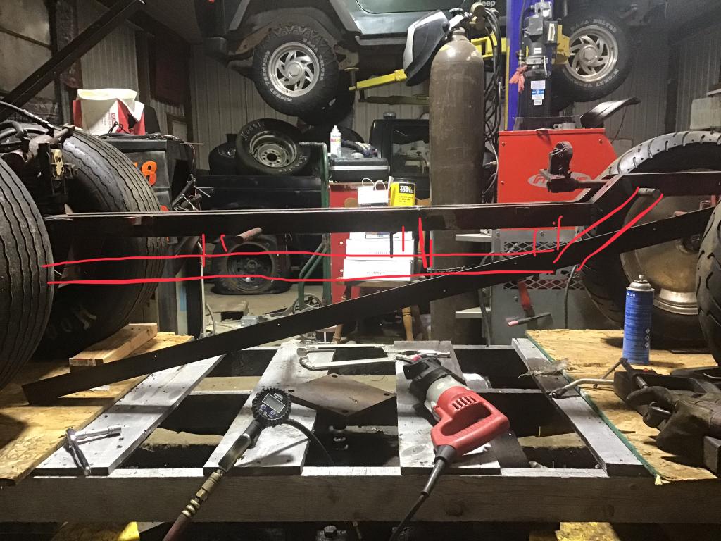

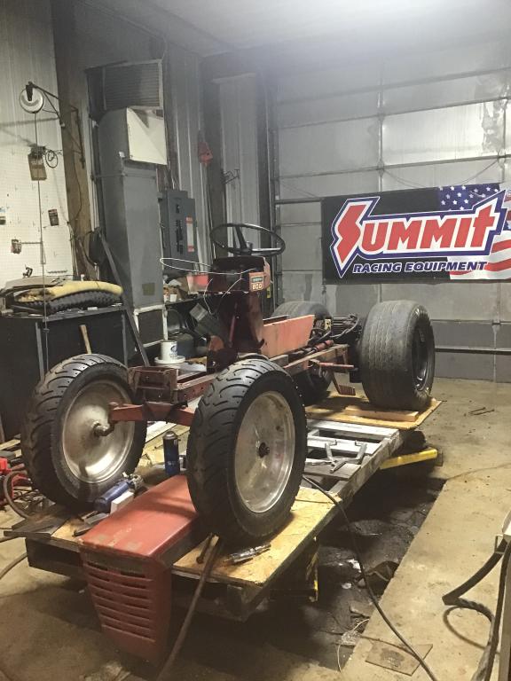

Pullstart 71,259 #351 Posted February 17, 2020 I put together a table top out of some scrap OSB and a 12’ skid cut down to 8’ or so. Hopefully the next time this machine moves off the lift, it’s under it’s own power. The front of the frame was cleaned up and the hood mount is tacked on. 3 Share this post Link to post Share on other sites

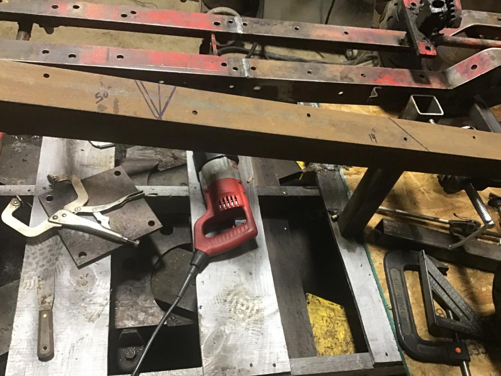

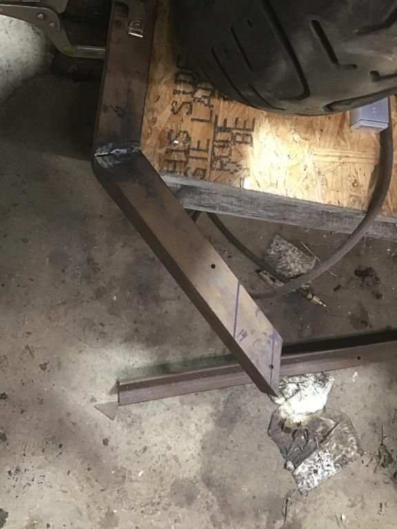

Pullstart 71,259 #357 Posted February 17, 2020 I dug this 2” x 3/16” angle iron out of my scrap/spares pile. It’ll be great for stiffening this project up. 3 Share this post Link to post Share on other sites

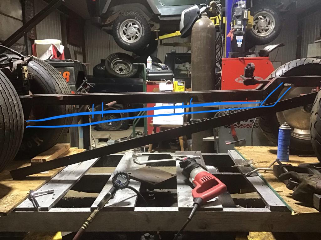

Pullstart 71,259 #358 Posted February 17, 2020 Calling all bridge builders, engineers and backyard wrenches, not necessarily in that order! I plan to use this angle iron to rigid up this machine. It’ll be upside down, as to resemble C channel from the inside. The front will double up the 45 degree section. It’ll be notched so that the two horizontal pieces will meet to be welded. Blue pill or red pill? Does it not matter for this caliber build? If the bottom piece was parallel to the top, I have some 3” wide flat stock that I could fill the whole length, actually creating that C channel. 1 Share this post Link to post Share on other sites
ebinmaine 80,748 #359 Posted February 17, 2020 Overkill is in the eye of the beholder. Or something like that.... I'd lean towards red pill if that has an extra cross member. 1 1 1 Share this post Link to post Share on other sites
Stormin 9,988 #360 Posted February 17, 2020 Another vote for RED from me. 1 1 Share this post Link to post Share on other sites
Pullstart 71,259 #361 Posted February 17, 2020 25 minutes ago, ebinmaine said: Overkill is in the eye of the beholder. Or something like that.... I'd lean towards red pill if that has an extra cross member. I could just as easily add another crossmember in the blue sketch, I just figured they were touching at the front bend... no real need to add one. I have a bunch of this 3/16” angle... Share this post Link to post Share on other sites
ebinmaine 80,748 #362 Posted February 17, 2020 1 minute ago, pullstart said: I could just as easily add another crossmember in the blue sketch, I just figured they were touching at the front bend... no real need to add one. I have a bunch of this 3/16” angle... okay so that being the case, what would be the difference between the red and the blue? Just the angle? Share this post Link to post Share on other sites
Pullstart 71,259 #363 Posted February 17, 2020 7 minutes ago, ebinmaine said: okay so that being the case, what would be the difference between the red and the blue? Just the angle? Yep. Triangulation or not... Share this post Link to post Share on other sites
ebinmaine 80,748 #364 Posted February 17, 2020 I'm still voting for red but I'm changing my reasons a little bit. in consideration of the fact that you can add a cross brace to either one of the designs I don't know which one, if either, would be stronger. For the sake of aesthetics and future modification possibilities I would stick with a parallel frame rail system. Since you have flatstock to add to it I would vote for that as well. Changing that whole arrangement to a large c channel wood eliminate 99% of the possibilities of Dynamic Loading even being so much as a concern. 2 1 Share this post Link to post Share on other sites
Pullstart 71,259 #365 Posted February 17, 2020 I’m there with you on the aesthetics idea EB. It’s not like I’ll have a lot of ground clearance issue with the front being so high! 1 1 Share this post Link to post Share on other sites
Tractorhead 9,217 #366 Posted February 17, 2020 I‘m more on the blue pill... why? Now, it looks for me more as a Dragsterframe or a Pullerframe, than a simply Dump truck. i simply and really like that Shape. And some memories come in mind - goood memories i had and i like to remember..👍 but how eric meant it‘s in the eye of the beholder. The stiffness shall be imho a little bit more in blue shape, but thats secondary in that design, except you plan an V6 as Engine... maybe .... once upon a time😎 1 Share this post Link to post Share on other sites
Pullstart 71,259 #367 Posted February 17, 2020 31 minutes ago, Tractorhead said: I‘m more on the blue pill... why? Now, it looks for me more as a Dragsterframe or a Pullerframe, than a simply Dump truck. i simply and really like that Shape. And some memories come in mind - goood memories i had and i like to remember..👍 but how eric meant it‘s in the eye of the beholder. The stiffness shall be imho a little bit more in blue shape, but thats secondary in that design, except you plan an V6 as Engine... maybe .... once upon a time😎 No V6 power here Stefan, this big guy will only have 6.5 horse powers. I like the look of the triangulated frame, but it’s so long and narrow I’m afraid the 3” separation or 7” overall height at the transmission plate aren’t enough to make a difference. Share this post Link to post Share on other sites
Pullstart 71,259 #368 Posted February 17, 2020 Thinking out loud, and sometimes talking out loud to myself... the parallel beam would be much easier to fabricate. I already know the kick up is a 45 degree angle. I have proven that I can cut the angle iron to bend that way. Anything I build will be stronger than what is there currently. I think I’ll stick with what I know on this portion. 1 1 Share this post Link to post Share on other sites

SylvanLakeWH 32,555 #371 Posted February 17, 2020 Blue lookin good! Share this post Link to post Share on other sites

953 nut 69,379 #374 Posted February 19, 2020 On 2/17/2020 at 10:44 AM, pullstart said: On 2/17/2020 at 12:08 PM, pullstart said: I have some 3” wide flat stock that I could fill the whole length, actually creating that C channel Boxed channel gets my vote. curb feelers? You have curbs at your place? 2 Share this post Link to post Share on other sites
8ntruck 9,305 #375 Posted February 19, 2020 I'm thinking you need a couple of cross members. Those, along with the additional stringers you are adding will help increase the torsional rigidity - better cornering performance, ya know. 2 Share this post Link to post Share on other sites
