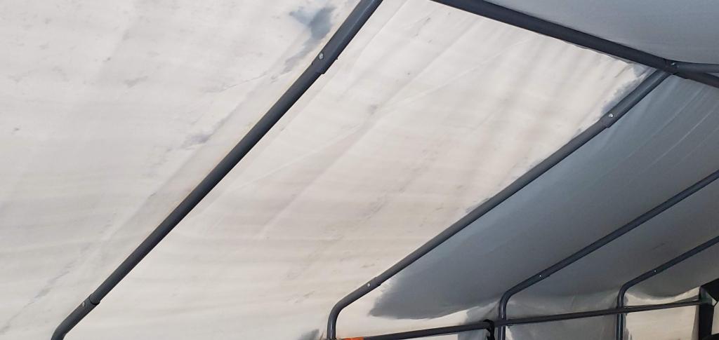

ebinmaine 81,003 #3 Posted January 6, 2020 I bought one to put our tractors in a few months ago. Like many things, you get what you pay for. I didn't want to go quite as low budget as HF but I didn't want to spend $800 or more for a ShelterLogic brand. The one I ordered was around 10 ft by 20 ft. Got it off of Amazon for something like $400. Some advice that I learned while researching and buying and building: Put a vapor barrier of plastic or thin rubber under the shed or you have great possibility to create your own weather system inside it. There is a way to greatly strengthen the overhead structure using ratchet straps in between all the rafters. It ties everything together nicely and also makes it so the roof does not sag as much. Very important - if you want the unit to last more than your first winter you NEED TO CLEAN THE SNOW off the top after EVERY SINGLE SNOWFALL. Sunshine is probably going to be the worst of your enemies. You can reduce damage to the tarp covering of the unit itself by putting a secondary tarp over the top. 1 Share this post Link to post Share on other sites

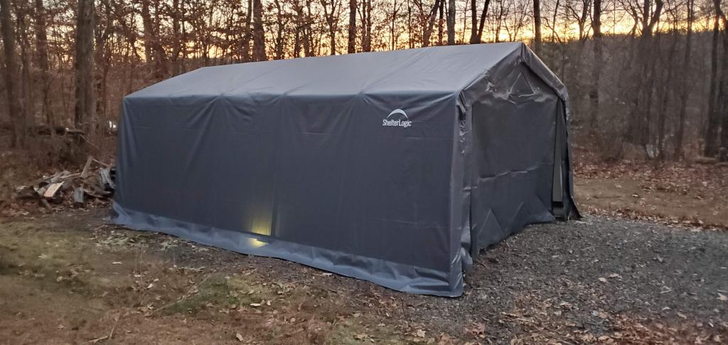

Alex175 785 #6 Posted January 6, 2020 Earlier this year I purchased a 10x20 shed from Shelter Logic through Northern Tool. It was on sale at the time for around $330, and so far I love it. Now keep a few things in mind, as previous posters have mentioned you must clean the snow off during every storm. It is amazing how much an inch or two of snow can cause the roof to sag. The other thing is I went into this purchase viewing this tent as a temporary solution. Under good care these can last a while, however your best option is always wooden, or even metal structure. For me this fit my budget for now and I will be putting aside money over the next 2-3 years to build something. 3 Share this post Link to post Share on other sites

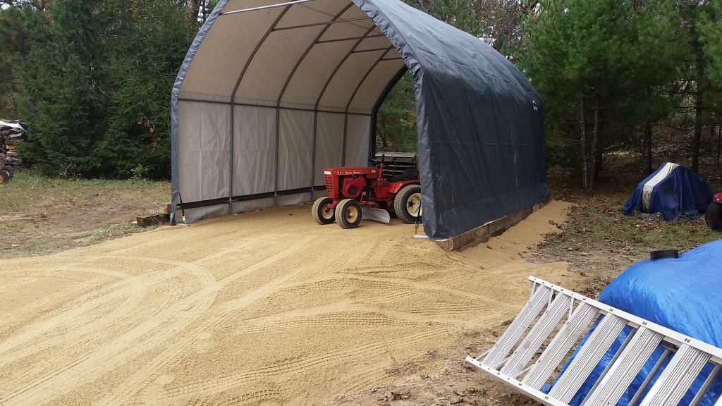

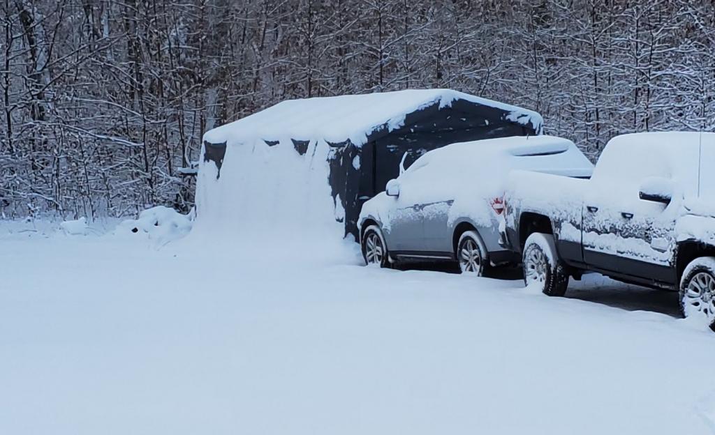

WHX?? 58,308 #8 Posted January 6, 2020 This one came from NT as well. Around 4-500. It does not let snow sit on it I get three years on it I'll be happy and by that time ready to put up something more permanent. Share this post Link to post Share on other sites
WHX?? 58,308 #9 Posted January 6, 2020 (edited) Didn't have the gables on yet for drive through grading. https://www.northerntool.com/shop/tools/category_tarps-canopies-shelters+instant-garages-instant-shelters+alpine-style-instant-garages-shelters Edited January 6, 2020 by WHX24 3 Share this post Link to post Share on other sites
Cvans 1,009 #10 Posted January 6, 2020 I would think the snow would be less of an issue with that type of roof. 1 1 Share this post Link to post Share on other sites
WHX?? 58,308 #11 Posted January 9, 2020 It is ..snow slides right off like a 12/12 roof but does pile up at the sides. Worst thing, and we have discussed this many times, is the moisture can build up in these types of horse storage can be be off the hook. I leave the door open and that helps alot .. not only that allows the cats to get in and keep the mice at bay. 1 Share this post Link to post Share on other sites
