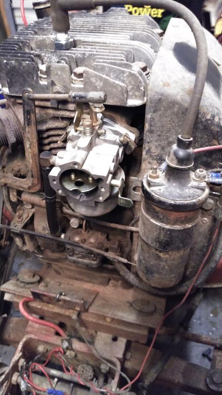

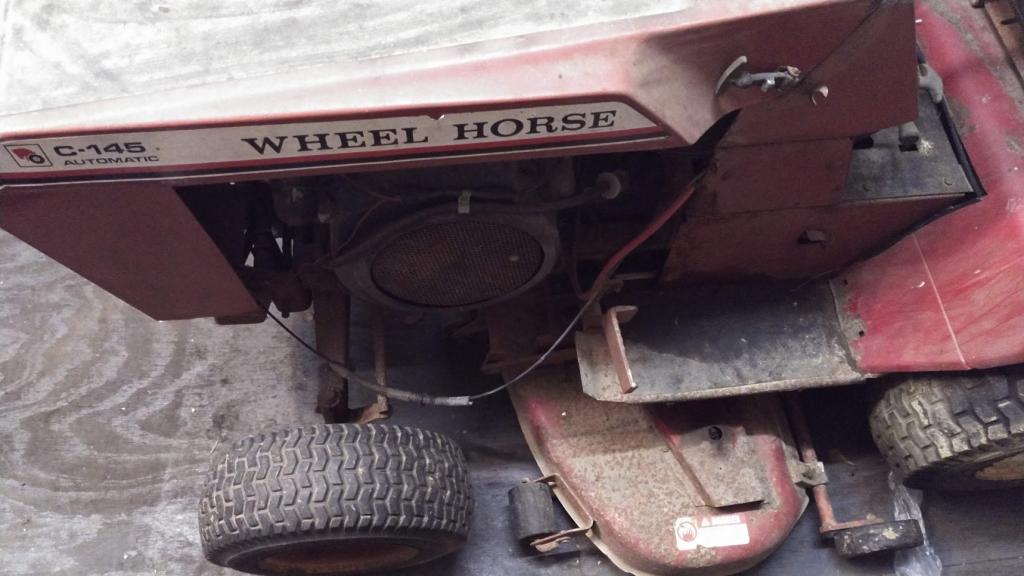

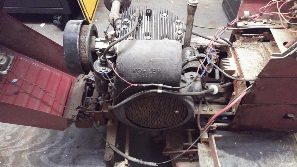

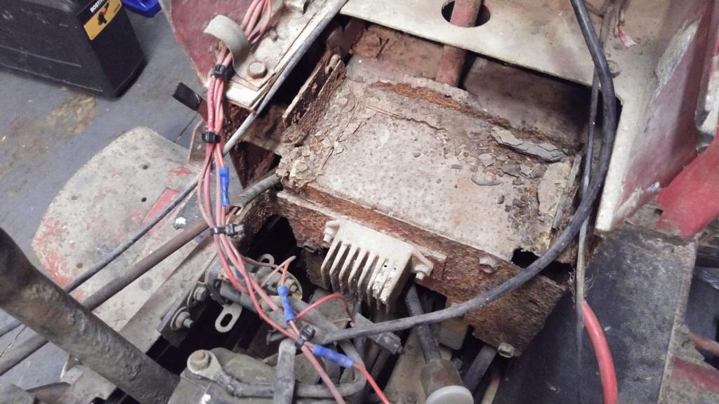

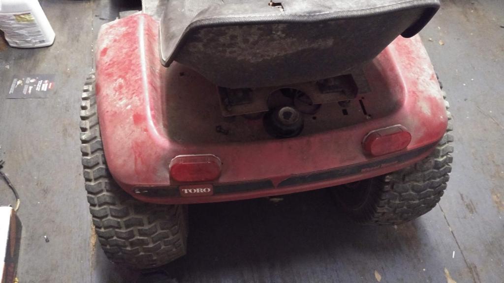

I just bought a used C-165 01-16KE01-17658. Its is odd because the rear says Toro but I don't think they bought them until '86, and the hood decals say C-145 but the serial points to a C-165, no identification on the engine at all. I'd like to find a service manual for the tractor itself and maybe a parts manual, I have a Kohler manual.  It has quite a few issues but going to start working on it in my spare time. It runs very well and idles smooth. Hydro pulls good  and deck lift works. I have no idea where the choke cable is supposed to mount on it. Hydro fluid is milky so i have a few filters ordered to change it a few times I just am not sure what to put in it. It also isn't charging the battery but going to Ohm out the stator per the manual, but does anyone know how to test the regulator? Also, I need to deal with the rust in the battery box area.
WVHillbilly520H
To help with the TORO on the metal fender pan is because that tractor originally came with a fiberglass fender pan that usually ended up broken and hence was replaced... Someone else will be along to help with the rest... BTW :text-welcomeconfetti: to :rs:.

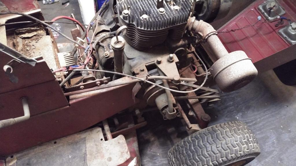

Definitely a 16hp Kohler. Most likely a C165 if it has the Eaton transmission.

I’m seeing 10 head bolts on the motor so it is a 16hp. Like was mentioned above the rear fender was originally plastic and they were easily busted, someone swapped it to a metal fender.

With all the rust and corrosion you have on the rectifier first thing I would do is take that off clean all the mating surfaces and connections. You will NOT charge if you do not have a perfect ground to this unit.
Ctlucas93
Thanks guys for all the help. All the manuals will be a big help for sure. Sounds like I lucked out on the rear fenders being swapped. I didn't know the regulator needed a clean ground to charge, I have ordered a clean used mounting plate for it and a battery tray off ebay to swap them out. I plan on making a wiring harness per the schematic and wrapping it for a cleaner look. I love how smoothly she runs and the hydro will spin the tires. Hopefully tomorrow Ill get around to changing the fluid in it. I picked up a few extra filters to change it a few times with it being slightly milky. Only other gray area I have are the choke cable mounting provisions. The service manual doesn't say anything on it. My plans are to clean it up and maybe do a partial restore down the road.
