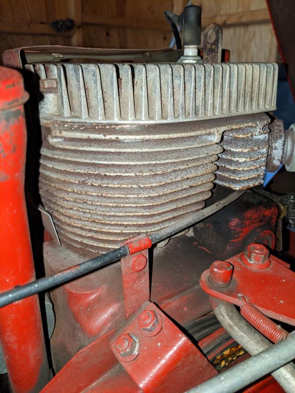

ebinmaine 79,124 #1 Posted January 1, 2020 Here's a couple pics of the K341 engine that's in Cinnamon Horse. I believe I see 13 fins... So... Heavy duty block? 1 Share this post Link to post Share on other sites
The Tuul Crib 7,354 #2 Posted January 1, 2020 (edited) Yep thats 13! What a beast! Edited January 1, 2020 by The Tool Crib 2 Share this post Link to post Share on other sites
Pullstart 70,102 #3 Posted January 1, 2020 Know what that tells me? That’s one more than 12 fins. 1 2 Share this post Link to post Share on other sites
CCW 1,505 #4 Posted January 1, 2020 Yup. I see 13. 1 Share this post Link to post Share on other sites
Herder 2,356 #5 Posted January 2, 2020 You might be on to something. looks like 13 to me. 3 Share this post Link to post Share on other sites

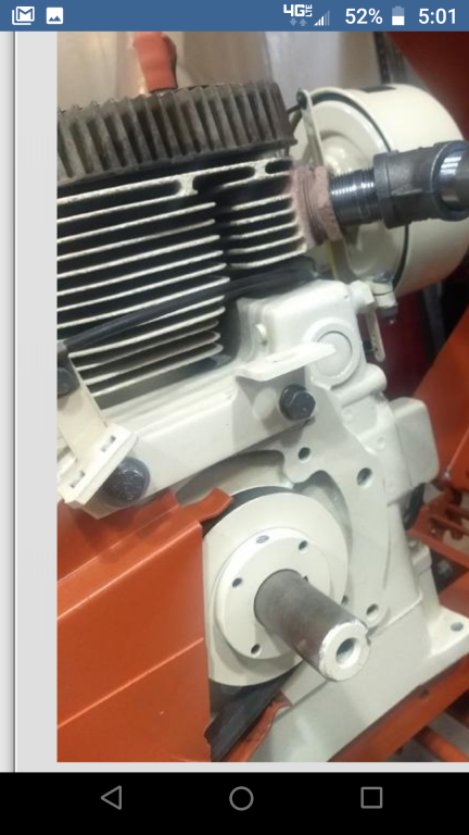

Crickets 4 #12 Posted January 2, 2020 How do you count your fins? From where to where, full or partial and split or whole? How do you come up with 13 here? Share this post Link to post Share on other sites
ebinmaine 79,124 #13 Posted January 2, 2020 5 minutes ago, Crickets said: How do you count your fins? From where to where, full or partial and split or whole? How do you come up with 13 here? Look at the second picture where the engine is painted off-white. Easier to see that one. Count the white horizontal fins that you can see straight up from the crankshaft. Share this post Link to post Share on other sites
Crickets 4 #14 Posted January 2, 2020 Thanks Got it. Share this post Link to post Share on other sites

ebinmaine 79,124 #17 Posted January 2, 2020 1 minute ago, Stepney said: I know the E16 has a 13 fin too. I've heard the term but have no idea what the difference is. From what I've gathered the 13 fin 16 horse block can be bored to a larger size so it is more desirable for pulling. If you are not pulling it would be more desirable because it is heavier duty with a thicker cylinder wall. Share this post Link to post Share on other sites
WildmanC120 613 #18 Posted January 4, 2020 Well this thread inspired me to go out and check my C-160. I think I got the jackpot as I have a 13 fin also. 1 Share this post Link to post Share on other sites
oldredrider 2,553 #19 Posted January 4, 2020 Most, if not all, C-160's came with the 13 fin block. Not really a rare find but because of the pullers desiring them, they're getting hard to find, unless it's in a tractor. 1 1 Share this post Link to post Share on other sites
pfrederi 20,657 #20 Posted January 4, 2020 Unless you are planning on a big over bore i do not see any advantage over a 12 fin block. 3 Share this post Link to post Share on other sites
WildmanC120 613 #21 Posted January 4, 2020 55 minutes ago, pfrederi said: Unless you are planning on a big over bore i do not see any advantage over a 12 fin block. Gloating doesn't count??? 2 Share this post Link to post Share on other sites
ebinmaine 79,124 #22 Posted January 4, 2020 1 hour ago, pfrederi said: Unless you are planning on a big over bore i do not see any advantage over a 12 fin block. That would be it.... But at least I know that if I wanted to create 1/8 of a DZ302 or LT/1 I have the bore capacity to do so. 1 Share this post Link to post Share on other sites
formariz 12,359 #23 Posted January 4, 2020 Differences Between the 12 fin and 13 fin 16hp OEM Kohler blocks, and the (Kohler-Replicated 16hp) Aftermarket Blocks - The 12 fin 16hp Kohler K341 K-series and M16 Magnum engine blocks have a curved indentation in the cooling fins (clearance for a straight oil fill/dipstick tube) and a threaded hole at the bottom of the cylinder. Count the number of fins from the PTO end of the block. These blocks have a thinner cylinder wall than the 13 fin block. These blocks are most commonly used for light duty lawn and garden equipment applications, and when used for a competition pulling application, can be safely bored up to a 3.937" piston without danger of seriously weakening the support of the cylinder wall. A cylinder restraint strap is highly recommended, especially when burning methanol fuel. But the 13 fin 16hp Kohler K341 K-series engine block have a thicker cylinder wall. Count the number of fins from the PTO end of the block. This block is somewhat rare, and used mainly for heavy duty industrial applications, and when used for a competition pulling application, can be safely bored up to a 4.000" piston without danger of seriously weakening the support of the cylinder wall. A cylinder restraint strap is highly recommended too, especially when burning methanol fuel. Both the 12 fin and 13 fin blocks originally have a STD cylinder bore of 3.750". If a bigger piston is needed to be used than mentioned above, it's advised to use an aftermarket block, such as Eburg, J2 or Jones. All of these blocks are made of high quality material, and one is not better than the other (quoted by Donnie Sample, of Lakota Racing). These blocks have a much thicker cylinder wall than a 13 fin block and can be safely bored for up to a 4.500" piston. And JE high quality aftermarket high performance pistons, billet connecting rods, etc., can be purchased from Lakota Racing (http://www.lakotaracing.com). 1 1 Share this post Link to post Share on other sites
