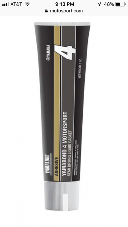

dclarke 4,270 #2 Posted December 28, 2019 I used a new gasket and sealed both sides of it with Yamabond 4. 2 Share this post Link to post Share on other sites

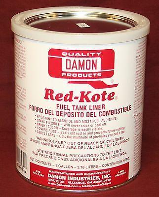

Racinbob 13,043 #4 Posted December 28, 2019 This stuff works wonders. I sacrificed a cheapo nylon fitting screwed into the hole to protect it and just a quarter cup will do the job. I let it run around the joining area by kinda rolling the tank until it wouldn't run anymore. It's important to have the tank clean and dry first. 1 Share this post Link to post Share on other sites
ZXT 2,402 #5 Posted December 28, 2019 35 minutes ago, Racinbob said: This stuff works wonders. I sacrificed a cheapo nylon fitting screwed into the hole to protect it and just a quarter cup will do the job. I let it run around the joining area by kinda rolling the tank until it wouldn't run anymore. It's important to have the tank clean and dry first. I've used it in a few car/truck gas tanks and it worked well. I like that there's little waste with it. When you get done sloshing it around in the tank, the excess can be poured back in the container for later use. 1 Share this post Link to post Share on other sites
Pullstart 70,717 #6 Posted December 28, 2019 Jonah that is an attribute that is not advertised with KBS product. It’s a one time use, active when it hits the air. 1 Share this post Link to post Share on other sites
