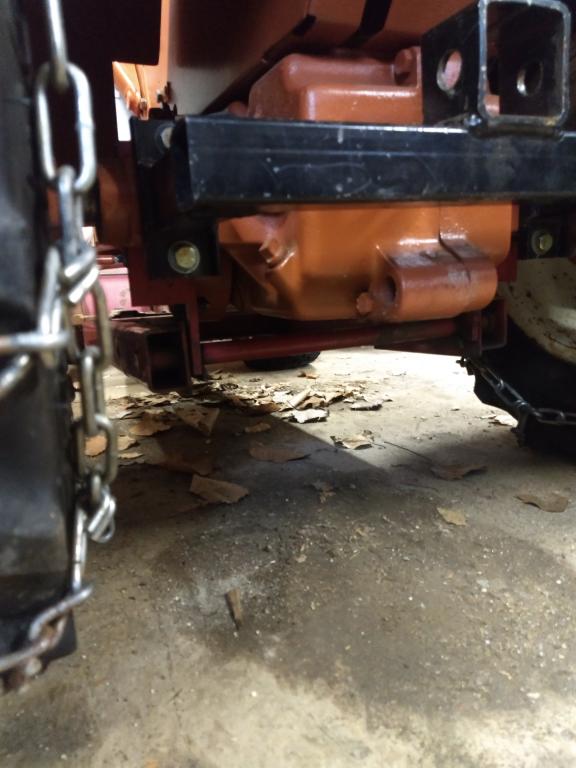

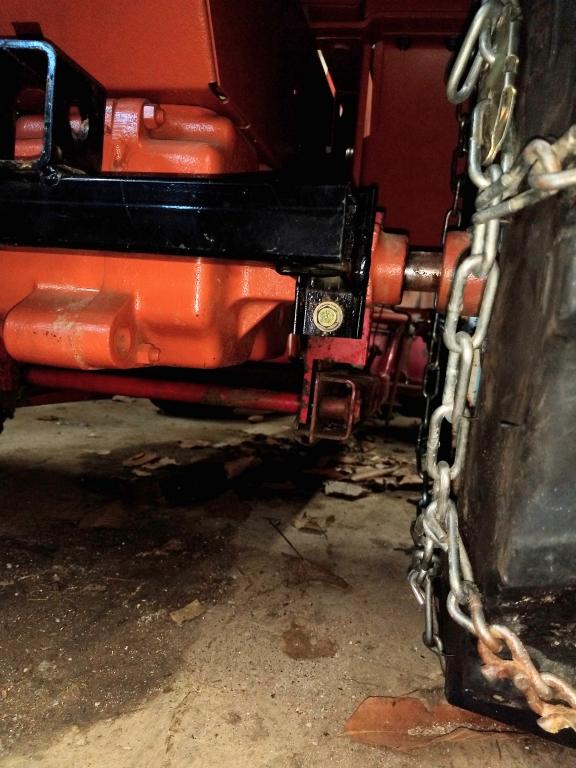

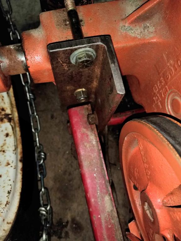

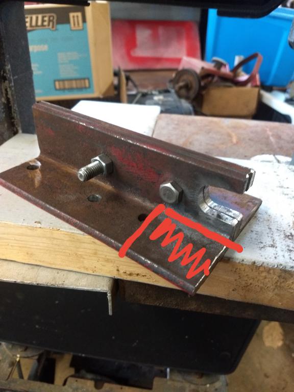

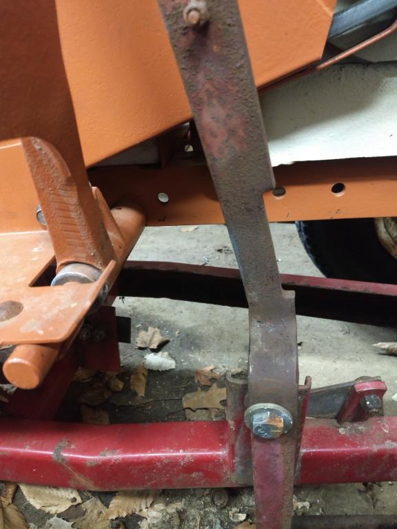

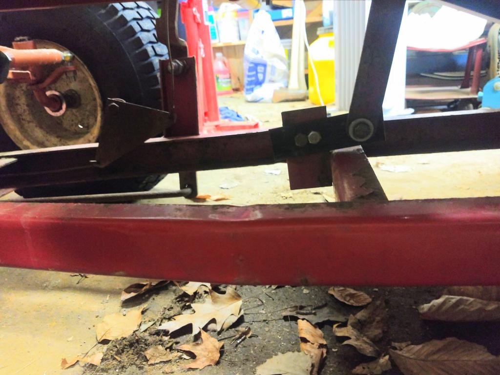

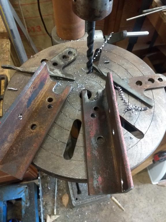

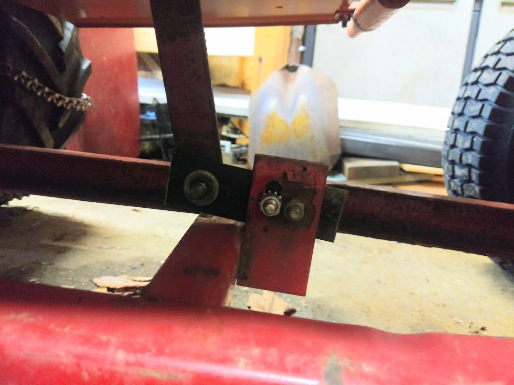

ebinmaine 80,312 #1 Posted December 22, 2019 The trailer hitch I have for the Cinnamon Horse is one that bolts to the front and back of the axle. (eBay find). Because of this I haven't been able to have the hitch on at the same time as the plow bracket. For the last couple seasons I've been swapping from a plow bracket to a trailer hitch. Yesterday I would have really liked to bring the splitter down into the forest and didn't want to take the time to unbolt the plow. Also, the side angle lever for the plow hits my brake pedal when it's in the up/back position. No brakes .. I've been making sure to have the plow lever centered to avoid this. Not anymore..... I went online looking for ideas to fix this hitch or just buy another one and on the site of the seller where I purchased this hitch I noticed that they have an option to buy a hitch that has plow brackets. Because of the fact that the brackets are in a fore-and-aft mounting position it moves the whole frame of the plow forward about 2 inches. PERFECT!!!! Well that was the impetus I needed to finally get around to getting the band saw up and running. I took a 7" section from an old badly worn long frame. Got some measurements and set about to fabricate myself some brackets. Here I am part way through the process. They're bolted together so I can get the closest mirror image possible. Remember this is all guesswork and hand grinding until it fits. I forgot to take a picture of the finished product. This drawing represents the piece that I had to cut out to make room for the back of the plow frame where the rod crosses through. Here's a shot from inside the seat pan on the right hand side of the tractor. Same side from the back on the ground. Here's a close-up so you can see the notch I cut out. Because of the fact that I moved the whole plow frame forward 2-1/2" I had to make a spacer to move the lift lever back because it contacted the steering pillow block. Here's the amount of clearance I was left with from brake pedal to plow angle lever. 4 14 Share this post Link to post Share on other sites
MikMacMike 494 #2 Posted December 22, 2019 1 hour ago, ebinmaine said: The trailer hitch I have for the Cinnamon Horse is one that bolts to the front and back of the axle. (eBay find). Because of this I haven't been able to have the hitch on at the same time as the plow bracket. For the last couple seasons I've been swapping from a plow bracket to a trailer hitch. Yesterday I would have really liked to bring the splitter down into the forest and didn't want to take the time to unbolt the plow. Also, the side angle lever for the plow hits my brake pedal when it's in the up/back position. No brakes .. I've been making sure to have the plow lever centered to avoid this. Not anymore..... I went online looking for ideas to fix this hitch or just buy another one and on the site of the seller where I purchased this hitch I noticed that they have an option to buy a hitch that has plow brackets. Because of the fact that the brackets are in a fore-and-aft mounting position it moves the whole frame of the plow forward about 2 inches. PERFECT!!!! Well that was the impetus I needed to finally get around to getting the band saw up and running. I took a 7" section from an old badly worn long frame. Got some measurements and set about to fabricate myself some brackets. Here I am part way through the process. They're bolted together so I can get the closest mirror image possible. Remember this is all guesswork and hand grinding until it fits. I forgot to take a picture of the finished product. This drawing represents the piece that I had to cut out to make room for the back of the plow frame where the rod crosses through. Here's a shot from inside the seat pan on the right hand side of the tractor. Same side from the back on the ground. Here's a close-up so you can see the notch I cut out. Because of the fact that I moved the whole plow frame forward 2-1/2" I had to make a spacer to move the lift lever back because it contacted the steering pillow block. Here's the amount of clearance I was left with from brake pedal to plow angle lever. Thats absolutely excellent Ebinmaine. The engineers at work could take a good lesson from you. And beleieve you me we try to get there heads out of the clouds........SIGH! Thats top shelf. in fact that deserves a cheers! 2 3 Share this post Link to post Share on other sites

ebinmaine 80,312 #5 Posted December 22, 2019 6 minutes ago, Digger 66 said: You're pretty deft with a grinder amigo ! Combo platter of bandsaw, grinder, Dremel, sandpaper.. and patience. 2 Share this post Link to post Share on other sites

CCW 1,519 #23 Posted December 23, 2019 EB, if only you could have added a weld the process would have been better than perfect. Good job! 1 Share this post Link to post Share on other sites

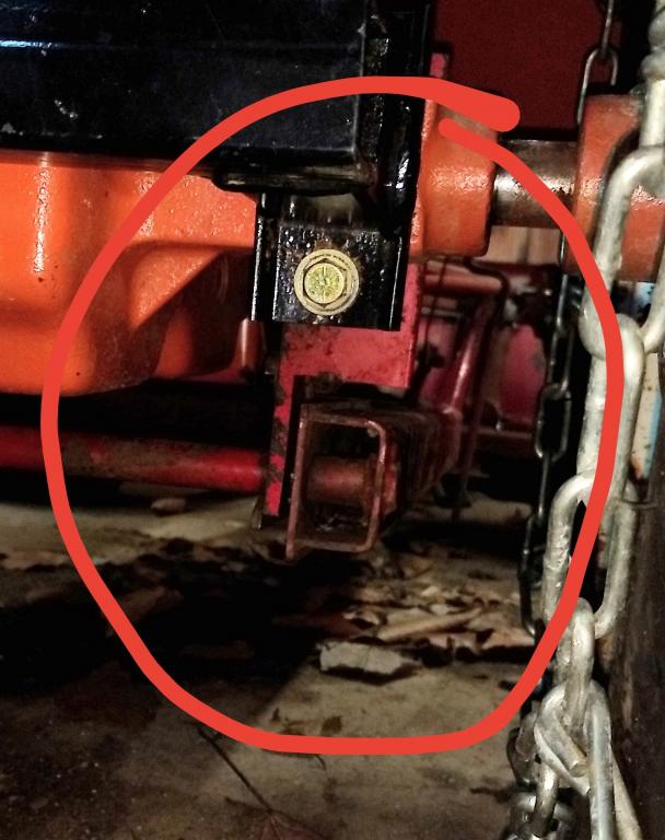

Lee1977 7,750 #24 Posted December 23, 2019 13 hours ago, Burnerman said: That’s great Eric! I’ve been trying to figure out how to fix the “no brakes” with the plow up and angled! I’m going to have to get to fabbing! If the plow frame is hitting the brake band causing no brakes. There was a post a couple months back about a spacer that went under the axle to lower the plow bracket. It was a 1" thick spacer it could also be made with thinner steel stacked. That is if you have the later model plow bracket. Share this post Link to post Share on other sites
ebinmaine 80,312 #25 Posted December 23, 2019 1 minute ago, Lee1977 said: If the plow frame is hitting the brake band causing no brakes. There was a post a couple months back about a spacer that went under the axle to lower the plow bracket. It was a 1" thick spacer it could also be made with thinner steel stacked. That is if you have the later model plow bracket. Not the brake band. The lever in front of the brake pedal. 1 Share this post Link to post Share on other sites
