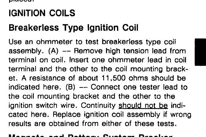

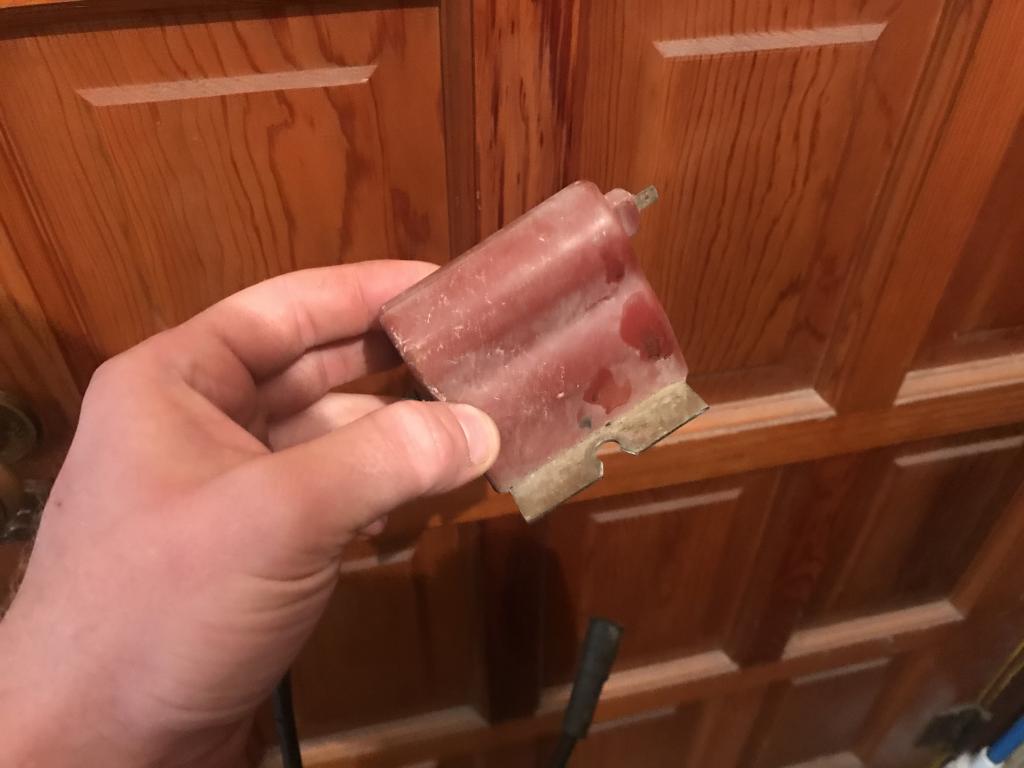

ZXT 2,402 #44 Posted December 22, 2019 (edited) 31 minutes ago, ebinmaine said: I do. And that's why I have 2 sets of feeler gauges. Extra tape measures... Etc..... Well that was easier than I thought! It was exactly where it was supposed to be. This look like what you need? I'll look up the test values and take my DVOM to it to see if it has any life left in it! EDIT: If anyone knows the resistance values for these coils, let me know! I've been googling but I keep only coming up with Onan results. Edited December 22, 2019 by ZXT 1 Share this post Link to post Share on other sites
Kenneth R Cluley 687 #45 Posted December 22, 2019 I may have coil and trigger also, let me know if other doesn't work out. 1 Share this post Link to post Share on other sites
ebinmaine 79,595 #46 Posted December 22, 2019 7 minutes ago, ZXT said: Well that was easier than I thought! It was exactly where it was supposed to be. This look like what you need? I'll look up the test values and take my DVOM to it to see if it has any life left in it! Sure does! If it turns out to be a good one... How do you attach a plug wire? Same as any other coil? Share this post Link to post Share on other sites
ZXT 2,402 #47 Posted December 22, 2019 1 minute ago, ebinmaine said: Sure does! If it turns out to be a good one... How do you attach a plug wire? Same as any other coil? Yep! The coil tower is covered up by my hand in the picture but it's just a typical coil wire. Have you tested any of the components on yours or are you just assuming its bad? 1 Share this post Link to post Share on other sites
Stepney 2,356 #48 Posted December 22, 2019 7 minutes ago, ZXT said: Yep! The coil tower is covered up by my hand in the picture but it's just a typical coil wire. Have you tested any of the components on yours or are you just assuming its bad? I'd tested the trigger by the Kohler book with a meter and it still seemed to be working, as was the stator coil under the flywheel. I think ice got to the external coil and that's what ended all that. Didn't have a spare coil on hand to try. 2 Share this post Link to post Share on other sites

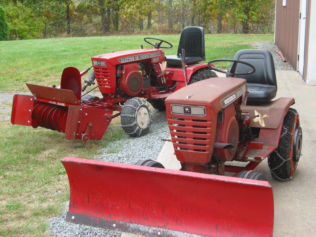

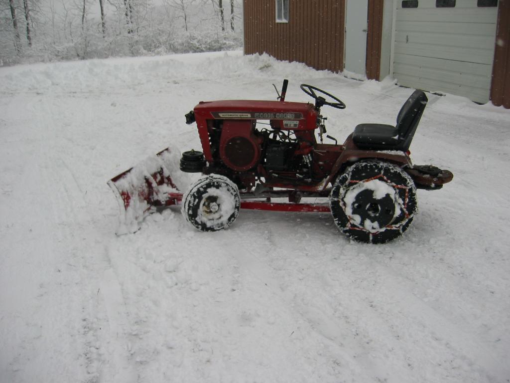

pfrederi 20,837 #50 Posted December 22, 2019 (edited) Coil test specs. if yours doesn't test out I have a couple that do and Eric can just have one. Working breakerless is much better than battery points especially in the snow. No moisture on the points no need to adjust clean either. Once you plow with a hydro you will never go back to gear jamming. 7 mph forward 3.5 reverse much faster and much quicker going from forward to reverse. And you Charger will have the 10 pinion limited slip differential. (Lowell has the spring if you rs is bad.) All my snow horses are Charger/Electros . With weights and chains they move a heck of a lot of snow fast!!!! Edited December 22, 2019 by pfrederi 4 2 Share this post Link to post Share on other sites
