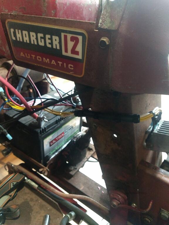

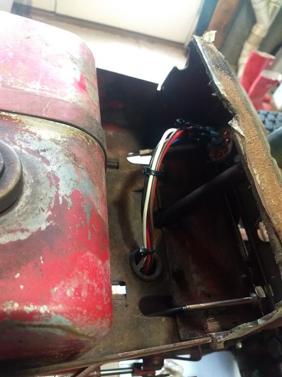

ebinmaine 78,126 #235 Posted January 3, 2021 (edited) Been messing with the idler linkage and I need to disassemble it a little to install a bushing or 2. I ha removed the voltage regulator to experiment with the location of the plow up/down control. Today I put that back on and made a changeto the wiring harness. I had used a wire that was a tad too short. Couldn't leave it there. Removed all the zip ties and reset the harness. It's no @JCM Jim plumbing job but it'll do. Edited January 3, 2021 by ebinmaine 1 Share this post Link to post Share on other sites
JCM 11,075 #236 Posted January 3, 2021 Wiring is not my specialty for sure, looks tidy from here Eric. Glad to see you have had a little extra time to make some headway with that hydro. You will not be disappointed once you figure out what to do with your extra foot. 1 Share this post Link to post Share on other sites

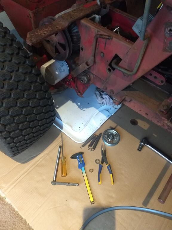

ebinmaine 78,126 #237 Posted January 3, 2021 54 minutes ago, JCM said: Wiring is not my specialty for sure, looks tidy from here Eric. Glad to see you have had a little extra time to make some headway with that hydro. You will not be disappointed once you figure out what to do with your extra foot. Got Trina's 867 out of the basement workshop and back to work. Still needs some lights installed and more weight but it's a LOT better. Now I can put some time in to this one. Hoping to see the new hoses within the week. I forget who but someone suggested to adjust the governor. Did that. It was a little off. Maybe that'll help... I also took out the belt idler shaft and took some measurements. Need to find some bushings. Share this post Link to post Share on other sites

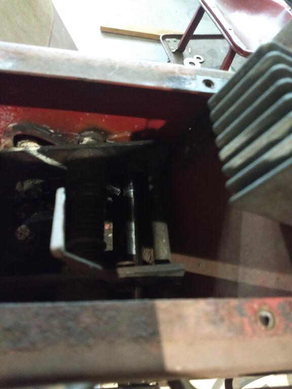

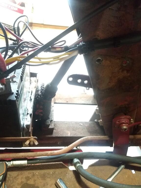

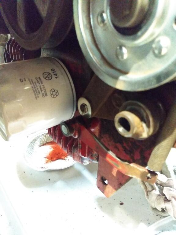

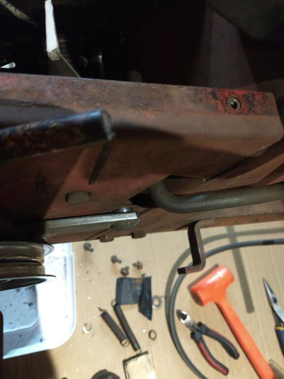

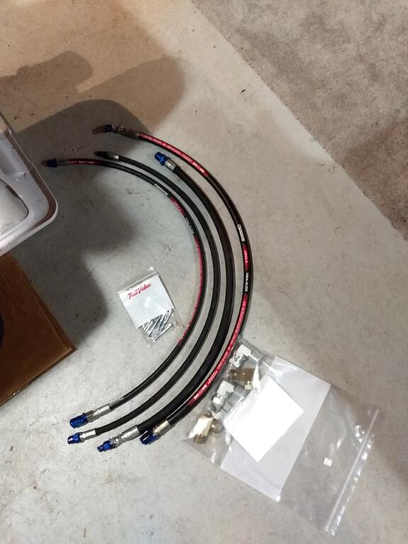

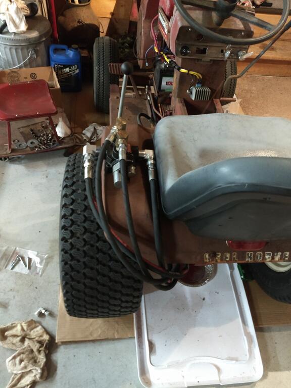

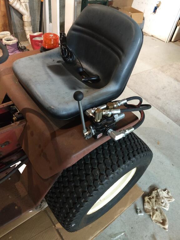

ebinmaine 78,126 #249 Posted January 7, 2021 I popped a couple bushings in around the idler support shaft. Made a huge difference. They'll get held in better later. JB Weld? Also took the park brake handle off and stuck some appropriate sized washers on the pivot pin. MUCH better. Pics are at a tough angle but maybe you can zoom in. Also took a few minutes and mocked up the hose setting. I'll adjust the position of the valve/handle then bolt it to the seat pan. Got the hoses and adapters from a great place in Gorham Maine. He deals with folks all over and if he needs pics or info I can be a middle man if needed. crsmaine.com Component Repair and Supply.. 1 3 Share this post Link to post Share on other sites
