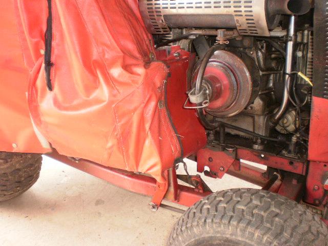

Ed Kennell 47,750 #10 Posted December 18, 2019 Here's the heat collector Jim @WHX24 mentioned. The belt guard is vented and the cab stays 30F above outside temp. Like stated above, keep the fins clean and the oil filter/tin seal in place and with the opened belt guard, the rear cylinder should not overheat. When you take the tins off to clean the fins, look for an oil leak under the oil filter mounting bracket. It is fastened to the block with two bolts and has a very narrow sealing gasket. If this drips oil, it is blown across the fins and makes a sticky mess that collects grass clippings clogging the fins. Enjoy the 520....she is a snorting monster. 2 2 Share this post Link to post Share on other sites

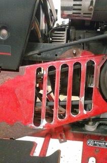

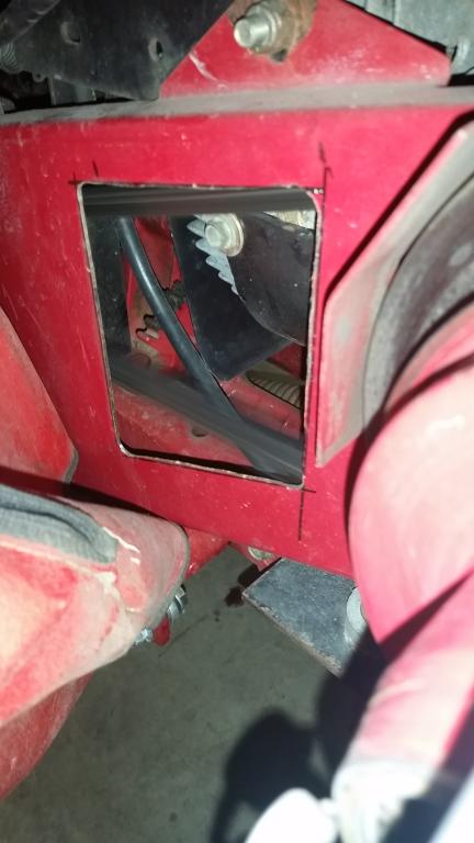

tom2p 2,396 #14 Posted December 19, 2019 (edited) some RS members did these cool mods: Edited December 19, 2019 by tom2p 1 Share this post Link to post Share on other sites

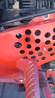

Lee1977 7,807 #15 Posted December 19, 2019 I went a little further as you don't need the belt guard on a hydro like you do on an 8 speed. It's required to help stop the belt on an 8 speed for changing gears. 1 Share this post Link to post Share on other sites
