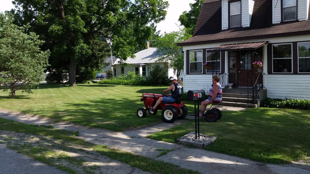

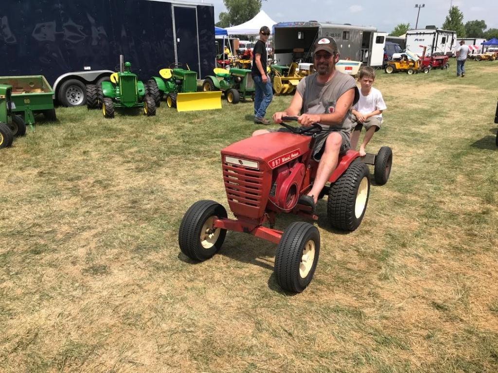

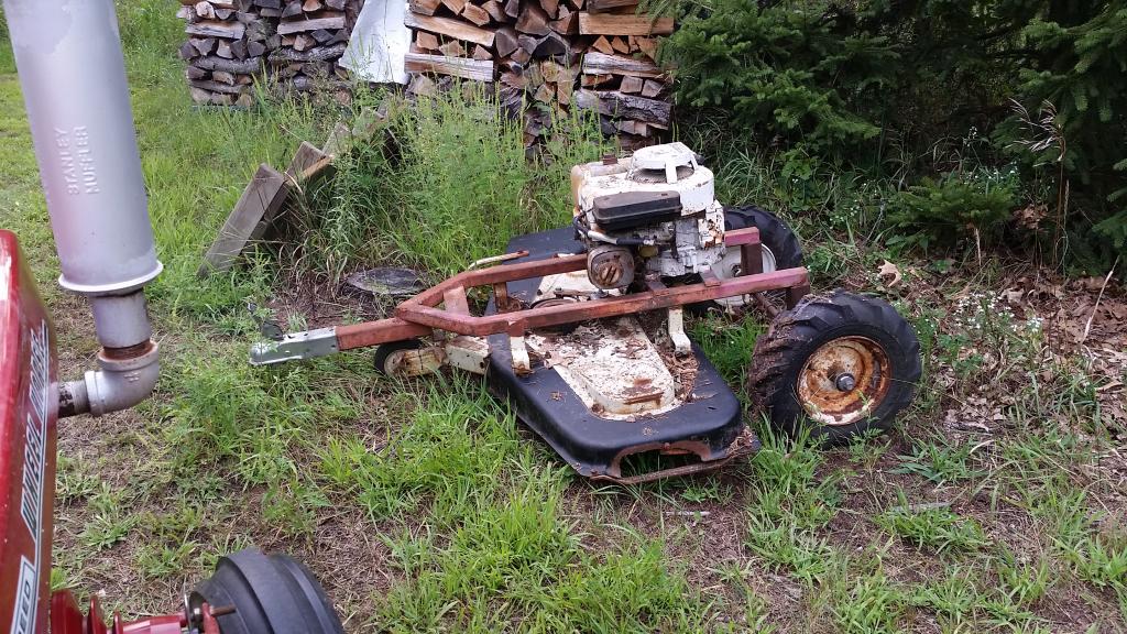

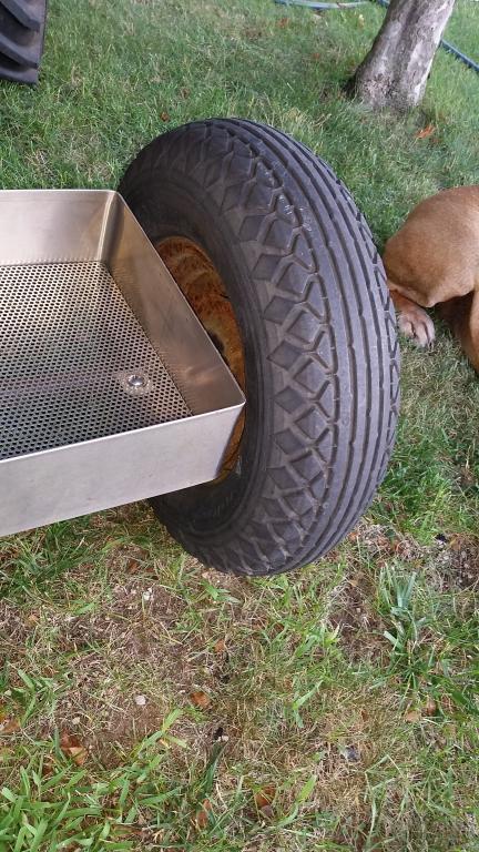

WHX?? 56,853 #3 Posted December 12, 2019 (edited) Chiming in to follow Jimmy and some ideas for ya. Plan to make one myself someday cept a two seater... We use them a lot at shows. This one used to be what we think to be off an old Gravely b-hind. Dan @Achto found it for dirt cheap. He added the basket for small stuff. Last pic is an old homemade brush hog I am going to try and convert to one. What would be cooler than a sulky with ags! Edited December 12, 2019 by WHX24 8 1 Share this post Link to post Share on other sites

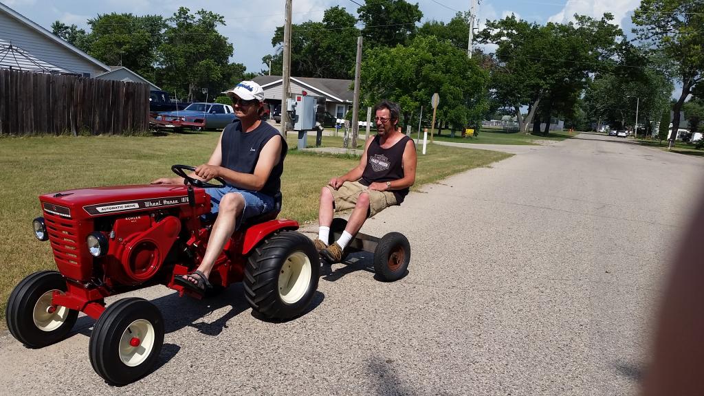

JimmyJam 542 #5 Posted December 12, 2019 15 minutes ago, ebinmaine said: Jimmy did you have anything in particular in mind to use for a seat? Axles? Footsteps? Stuff like that... Axles will be just a straight rod with footrests. Something similar to pic, but shorter with obviously different hitch setup. 2 Share this post Link to post Share on other sites
WHX?? 56,853 #6 Posted December 12, 2019 Looks alot like the one I'm on.... same foot rests. Just a drawbar hitch. After we got it we saw the same ones crop up at show flea markets so they must have been a popular Gravely option. Maybe old WH floor boards, some trailer fenders, little storage box under the seat??? A grab handle for the missus is a must for those sharp turns! Cat's meow would be some sort of suspension or what I was thinking a old skool sprung buckboard style seat??? 1 1 Share this post Link to post Share on other sites

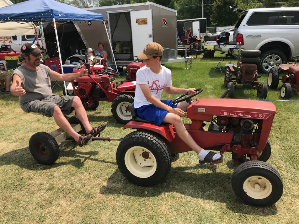

Stepney 2,357 #10 Posted December 12, 2019 I've had three. Two were built on Gravely frames and had wooden boxes on the rear, looked identical. The third was a 'modified' 867. 6 1 Share this post Link to post Share on other sites

Stepney 2,357 #12 Posted December 12, 2019 They were the only photos I could find. The frame was about 1.5" steel pipe with a T at the back for the axle. The seat was suspended off a Z shaped wide tractor seat spring type of arrangement. 1 Share this post Link to post Share on other sites
JimmyJam 542 #13 Posted December 12, 2019 @Stepney I kinda thought it was a flat bar steel in a Z formation. What about this spring type? 1 Share this post Link to post Share on other sites
Stepney 2,357 #14 Posted December 12, 2019 9 minutes ago, JimmyJam said: @Stepney I kinda thought it was a flat bar steel in a Z formation. What about this spring type? Now it's been a lot of years butr maybe it actually was C shaped like that. That looks identical to what mine started as. I added the boxes. Share this post Link to post Share on other sites

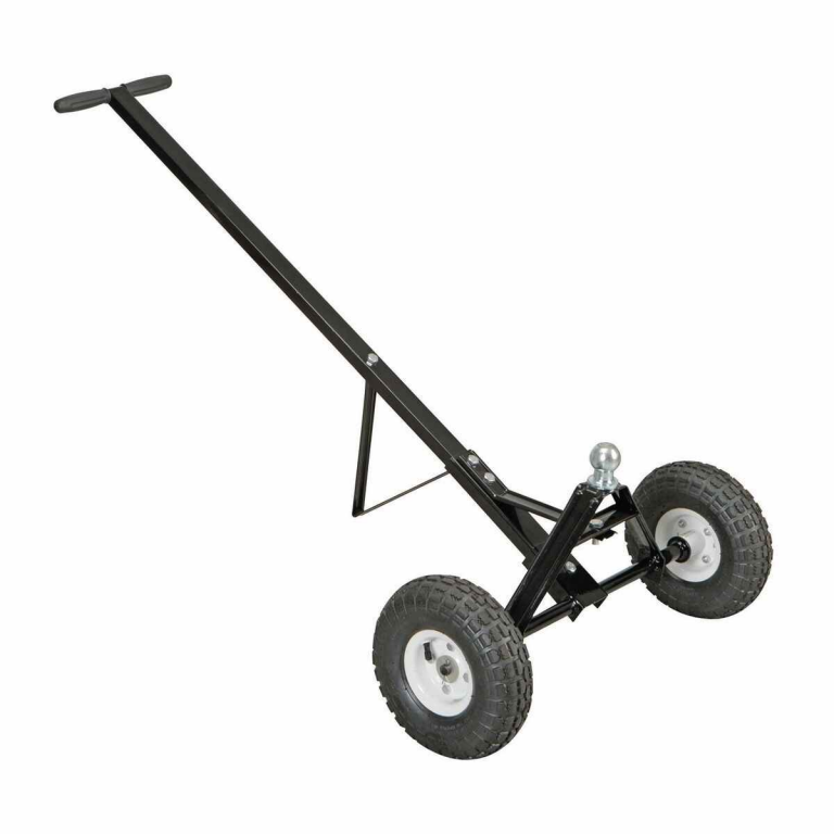

pacer 3,180 #17 Posted December 12, 2019 Cant be much simpler to adapt this trailer dolly from HF.... 2 1 Share this post Link to post Share on other sites
Stepney 2,357 #18 Posted December 12, 2019 I agree. I think I paid 25 bucks for each of mine and they are very simple. I had way more in the tires then I did the units.. A few pieces of steel and black iron pipe, and you'd have one pretty cheap. I think I sold mine for 75 each all done over and they were hard to sell. I had more in the tires again.. 1 Share this post Link to post Share on other sites
SylvanLakeWH 31,557 #19 Posted December 12, 2019 32 minutes ago, pacer said: Cant be much simpler to adapt this trailer dolly from HF.... That’s not much of a seat... But seriously, could also use a cheap hand cart as well... 2 Share this post Link to post Share on other sites

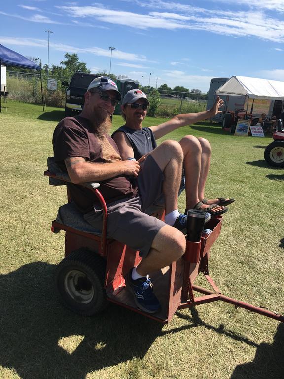

Achto 31,913 #20 Posted December 12, 2019 2 hours ago, WHX24 said: I think we paid like 40 bucks! That's exactly how much we paid for that one. Just added a hitch that would work better on a tractor & the box. Had the box on hand & the hitch was made from scraps that I had laying around so total out of pocket $40. I think we saw some of those sulky's for sale at tractor shows for around 50 to 75 bucks. One thing to consider @JimmyJam, a two seater sulky will not take up much more room that a single seater. Here is a pic of one of the two seaters that my dad built. Complete with cup holders and under seat storage, I want to build another 2 seater this winter, maybe with a built in cooler under the seat. Still working on the plans. 3 1 Share this post Link to post Share on other sites
