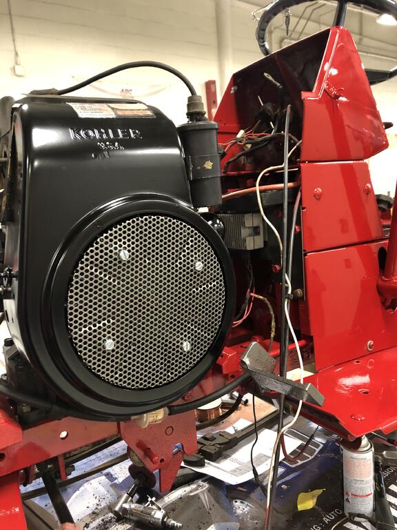

BHunter 1,702 #77 Posted April 9, 2021 On 3/31/2021 at 2:29 PM, pullstart said: Is the engine a class project too Bob? The engine is in. It’s no longer a C105. It’s a C145 now. The 14hp is bolted straight to the frame. No rubber mounts anymore. We want to feel the Kohler shake . The carb is almost ready to assemble. Hopefully we’ll smell some exhaust fumes soon. 3 9 1 Share this post Link to post Share on other sites

BHunter 1,702 #81 Posted April 13, 2021 On 4/9/2021 at 7:14 PM, 953 nut said: The students found out what success smells like. It’s alive. Fired right up. No smoke ! We mounted a gravity fuel tank on top of the motor for now. The gas tank grommet was leaking. It also has the throttle cable rigged up on the wrong side of the motor because we don’t have the correct linkage parts that attach to the flywheel cover. I need to order a brake lining for it and paint the wheels , then IMG_5543.MOV we can take it for a test drive. 2 4 Share this post Link to post Share on other sites

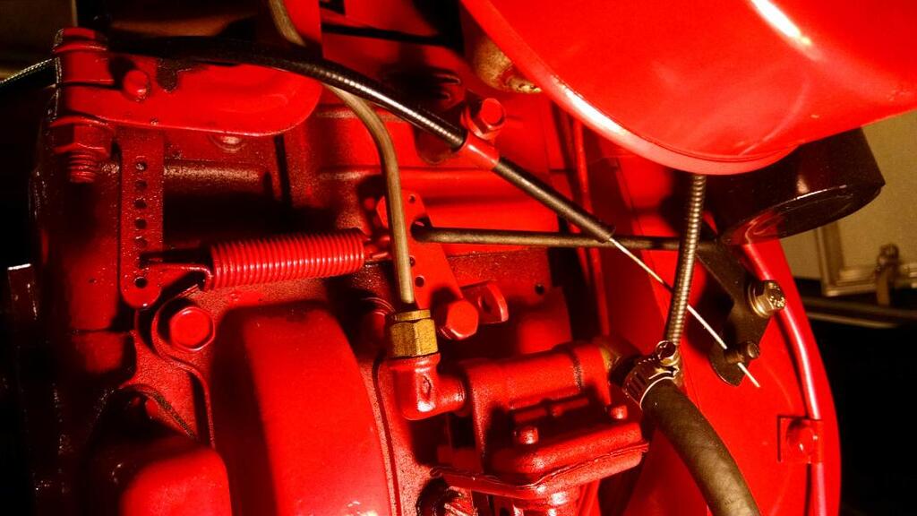

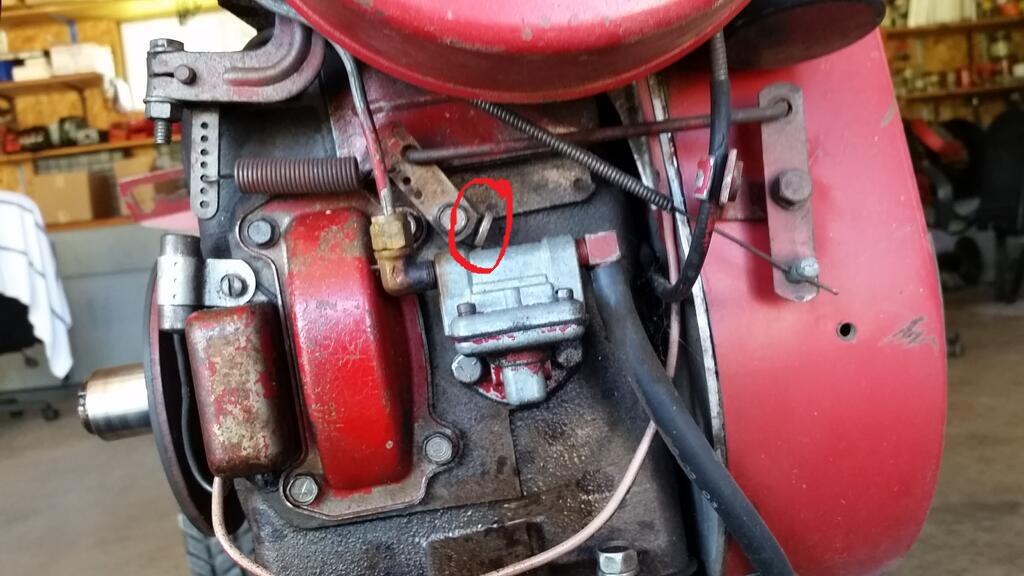

WHX?? 58,341 #82 Posted April 13, 2021 if that linkage is like this Bob and you need I may have a parts motor and wouldn't be out of my way to look. 2 1 Share this post Link to post Share on other sites
BHunter 1,702 #83 Posted April 13, 2021 1 hour ago, WHX24 said: if that linkage is like this Bob and you need I may have a parts motor and wouldn't be out of my way to look. Hi Jim, I see the parts in your picture. The parts we need are the pivot piece on the flywheel cover that the cable attaches to, the center bolt , the rod at the top of that pivot bracket and the anchor for the throttle cable located in the center of the block breather vent. We also need the bracket that mounts to the block that holds the cable . It’s located near the starter. Let me know if you have them and how much you want . I can send you the money or meet up with you at the Big Show if you are going this year. thanks, Bob 1 Share this post Link to post Share on other sites

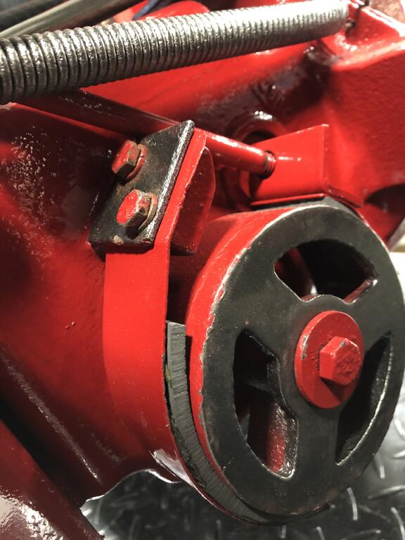

BHunter 1,702 #86 Posted April 21, 2021 Today we installed the brake lining that I received in the mail yesterday from @rmaynard. Our brake band has rivets and the lining has relief spots to allow for a great fit. Nice product Bob! The eBay purchase was easy and had fast shipping. We are almost ready to take on a test drive. Just have to finish the rear fender and mount the seat. 4 3 1 1 Share this post Link to post Share on other sites

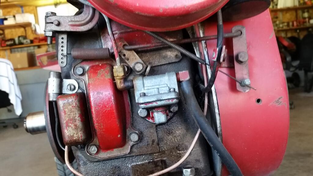

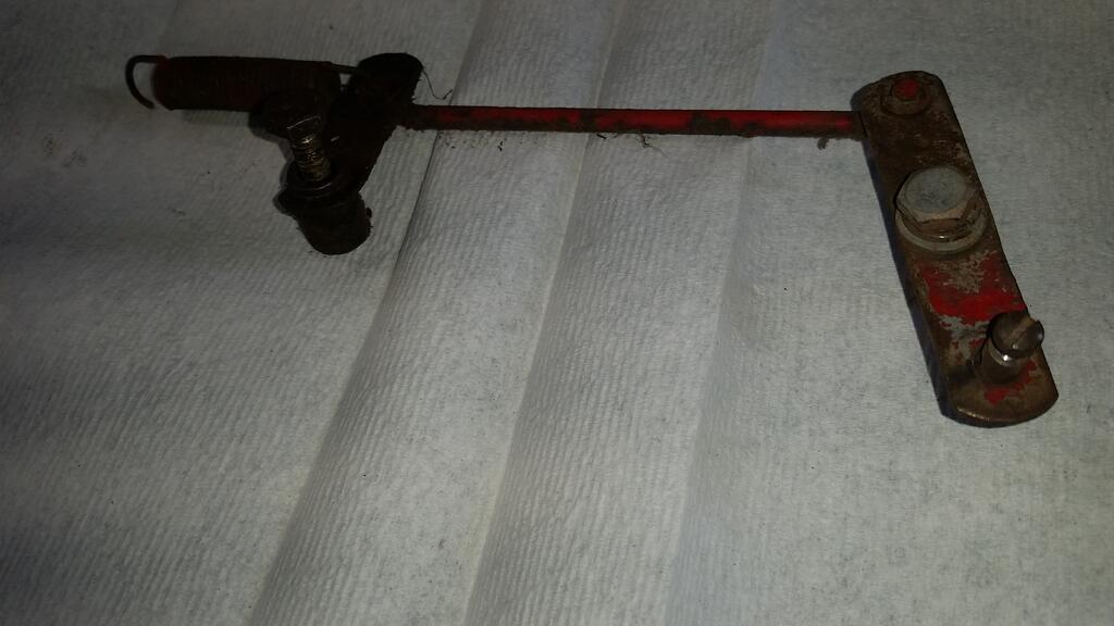

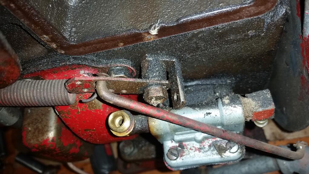

WHX?? 58,341 #89 Posted April 21, 2021 (edited) Here's what I have Bob if you still need it. This came off a K241 that @pullstart was supposed to get but he'll get over it. The anchor for the cable is just a nut to hold the breather cover on with a 1/4-20 threaded rod coupler and a p clamp. Should have that at a hardware store. Only thing i don't have is this little do dad... it's the throttle stop that sets the engine at 3600 max. Should be easy to make one. Edited April 21, 2021 by WHX24 1 1 Share this post Link to post Share on other sites
BHunter 1,702 #90 Posted April 21, 2021 1 hour ago, WHX24 said: Sorry for not getting back sooner Bob, have an elderly dad to deal with.. All is good now tho. I 'm sure I have those parts and will dig them out. Be warned tho I'll take no money for them as long as you keep doing what you are doing. Dan @Achto and I were both blessed to have teachers like you in HS shop classes and I would not be able to build motors to this day if it were not for that. Quick story here senior year I was in a trade math class. We called the teacher Mr. Cricket 'cause he looked like the cartoon character. Well if it weren't for him I wouldn't even know what a micrometer or vernier calipers was much less how to use one! Whats worse back then I was a stupid kid in why to I have to know this this is dumb.. Mr Cricket knew! Mr. Cricket did know. Im glad your dad is doing better. Those are the parts we need. Thank you. 1 Share this post Link to post Share on other sites

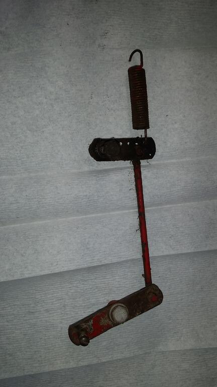

WHX?? 58,341 #92 Posted April 22, 2021 Better pic of the do dad and cable grabber setup if needed. 1 Share this post Link to post Share on other sites
BHunter 1,702 #93 Posted April 24, 2021 On 4/22/2021 at 9:09 AM, WHX24 said: Better pic of the do dad and cable grabber setup if needed. That’s a great picture. Thanks 1 Share this post Link to post Share on other sites

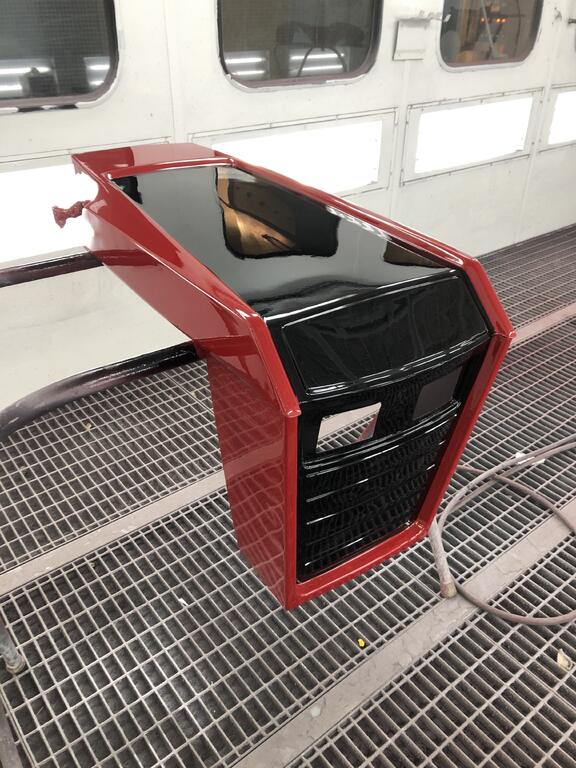

BHunter 1,702 #94 Posted May 3, 2021 Getting closer . Just have the rear fender pan left to paint. 1 13 2 Share this post Link to post Share on other sites
Tractorhead 9,218 #95 Posted May 3, 2021 Whow - that looks great. For my opinion a perfect finish 👍 1 Share this post Link to post Share on other sites
BHunter 1,702 #96 Posted May 3, 2021 1 hour ago, Tractorhead said: Whow - that looks great. For my opinion a perfect finish 👍 Thank you. The kids did a nice job on it. 1 Share this post Link to post Share on other sites
rjg854 13,418 #97 Posted May 4, 2021 The kids did a beautiful job. 2 Share this post Link to post Share on other sites
