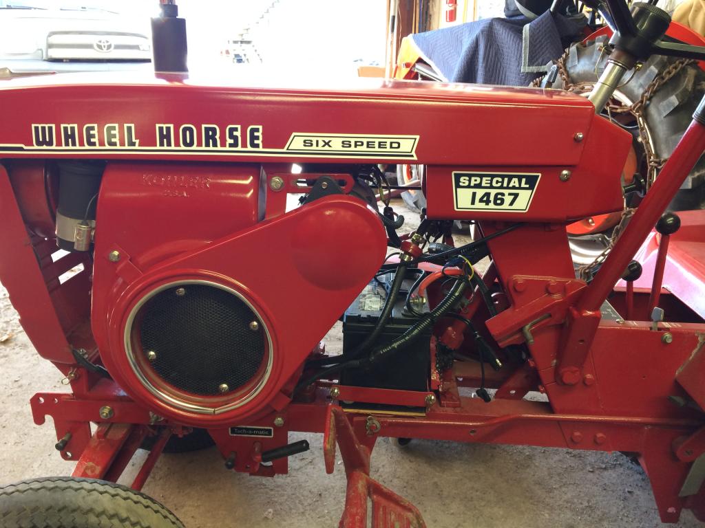

squonk 46,096 #7 Posted December 4, 2019 (edited) I put a newer 14 HP engine out of a blackhood on my 1267 and kept the starter /genny. I used the original engine shroud by removing the stator and the flywheel ring gear . Edited December 4, 2019 by squonk 2 Share this post Link to post Share on other sites
Herder 2,355 #8 Posted December 5, 2019 2 hours ago, squonk said: I put a newer 14 HP engine out of a blackhood on my 1267 and kept the starter /genny. I used the original engine shroud by removing the stator and the flywheel ring gear . I upgraded this one with a newer 12HP My intention was to have custom decals made, like you did. (1253) just haven't got around to it. Good looking tractor by the way. 2 1 Share this post Link to post Share on other sites
