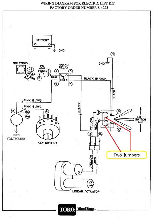

snowhound 106 #9 Posted December 27, 2019 I think I found what killed the lift. The switch stuck in the raise position and with the tractor running I didn't hear the clicking so I'm assuming the clutch has burned out. Does anyone know where I can get a new switch? I haven't had time to remove the actuator yet to many projects that have to be completed first. Luckily I have a 416-8 that is stepping in to take the 418-8s place. Share this post Link to post Share on other sites
gwest_ca-(File Mod) 12,454 #10 Posted December 28, 2019 Any momentary DP DT toggle switch should work as long as it is heavy duty enough to carry the amperage. DP = double pole DT = double throw It will have 6 terminals This one is too light duty https://www.princessauto.com/en/detail/on-off-on-momentary-toggle-switch/A-p8161713e This is a good one with only 4 terminals because it includes the crossed jumpers. You can do the same to a 6-terminal switch by adding your own jumpers. https://www.princessauto.com/en/detail/12v-dc-polarity-reversing-momentary-toggle-switch/A-p8467193e Garry 1 Share this post Link to post Share on other sites
