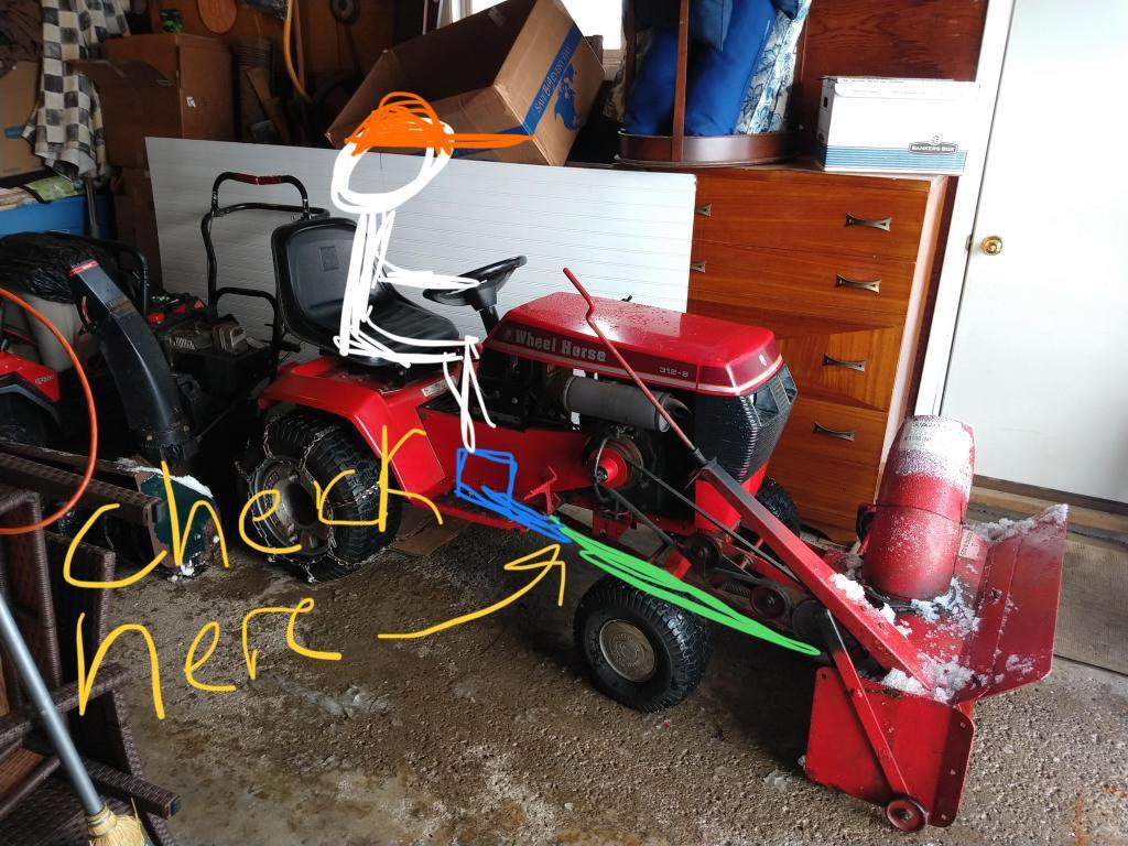

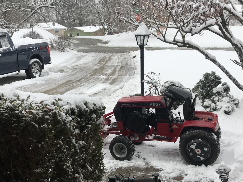

balconio 606 #79 Posted December 5, 2019 I got a chance to use my newly acquired 312-8 today to clear about 4" of very wet and heavy snow from my 75' double-wide driveway. she did admirably- but was screaming through the entire thing unless i crept along in 2-Low. i thought it was the belt but turns out the PTO clutch was pretty loose... I absolutely love how adjusting that was completely tool-free and took me all of 30 seconds to turn in the adjuster 2 full turns. in the background you can see my POS 9hp Craftsman walk behind. just for shites-and-gigs i tried it out, and no joke it was completely clogged within 3 feet of trying to throw this wet snow. i think i might have made a good move on the wheelhorse here! One question i have for folks is- i didn't find that the blower was getting all the way down to the asphalt without adjusting the wheels all the way down to their lowest setting and then pushing my foot downwards against the lift lever while moving. is this common to have to give it down-pressure like that to get down to the asphalt? 3 6 Share this post Link to post Share on other sites
Pullstart 71,522 #80 Posted December 5, 2019 @balconio That flag link on the blower should slide on and off of the long piece. It can receive a shim or two for more lift I believe. Maybe there are some in that you can remove? Or is there an adjustment knob on that machine limiting the throw of the lift lever? 1 1 Share this post Link to post Share on other sites
953 nut 70,354 #81 Posted December 5, 2019 27 minutes ago, balconio said: i didn't find that the blower was getting all the way down to the asphalt There is an adjustment that will limit the lift from being able to go all the way down. See if that might be holding your blower up. 1 Share this post Link to post Share on other sites

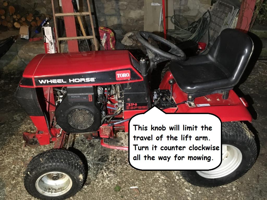

Pullstart 71,522 #82 Posted December 5, 2019 Here’s an illustration of what I mean. Safety orange! It’s hunting season! 4 Share this post Link to post Share on other sites

balconio 606 #86 Posted December 5, 2019 2 hours ago, pullstart said: Here’s an illustration of what I mean. Safety orange! It’s hunting season! I guess she's too old for the adjustment knob- I don't have one of those. i crawled under and didn't see any shims- but maybe the spring tension is giving me too much assist? it does seem to let down pretty nice and easy- i don't drop the lever of course but it's not wanting to slam down to the ground when i release it. i also see maybe i can move the pin on the lever that connects it all to the lift arm. when i have my foot on the lift lever (must look pretty funny) i can feel it wanting to push up when i go over wheel ruts. maybe my problem is i need to snowblow before tire tracks pack down the virgin snow making it all uneven? I also like how trim i look in your sketch- stick figure drawings take off at least 75lbs LOL! 2 Share this post Link to post Share on other sites
Pullstart 71,522 #87 Posted December 5, 2019 I’m at a loss for the assist spring, I’m not fortunate enough to have actually ever plowed or snow blowed on a Wheel Horse. My plow rig is a 2500HD with a 9.2 V plow and 16’ swing wing back blade. I’d say go ahead and loosen the tension on the spring a bit and see how it rides on dry pavement. Maybe set the front tires on a 2x4 and set the blower to allow some droop even? 1 1 Share this post Link to post Share on other sites

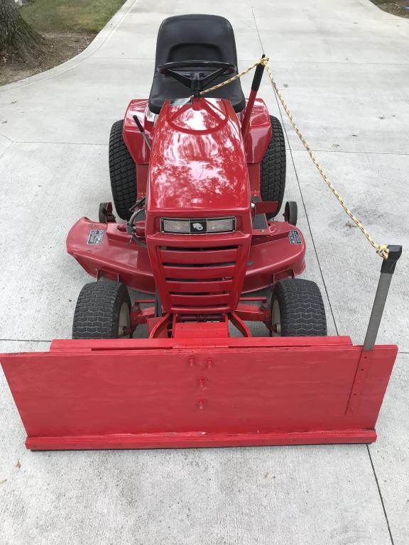

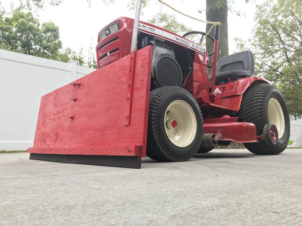

Al C. 1,480 #88 Posted December 7, 2019 (edited) Added weight of the raised mower deck gives solid traction. Blade does not ride on the surface so there is no weight resistance, and since it is fixed to the frame, it does not ride up on the snow. Works great! Edited December 7, 2019 by Al C. 2 5 Share this post Link to post Share on other sites

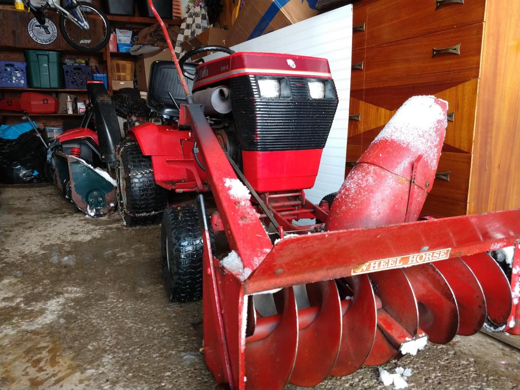

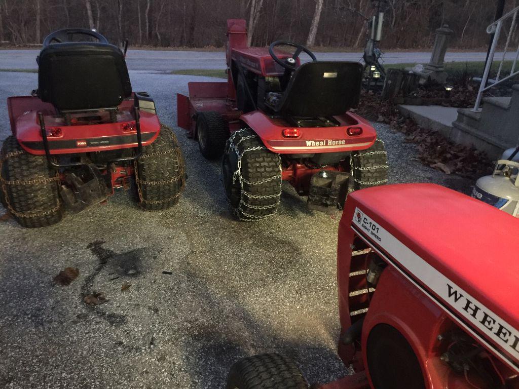

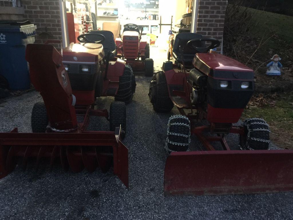

Lagersolut 806 #91 Posted December 15, 2019 (edited) I'm a little late to this thread but here it is - 416-8 I picked up in September is ready for snow . Hunted down set of 50 pound each wheel weights, went over wiring , new oils , flushed tank , fixed hood stand , new bushings , headlight bezels , points , plug , condenser, head gasket , coil ...the works . This year I'm tackling it with the 416 and a 315-8 . Hoping for some seat time with this 416 and the blower . Edited December 15, 2019 by Lagersolut 6 5 Share this post Link to post Share on other sites

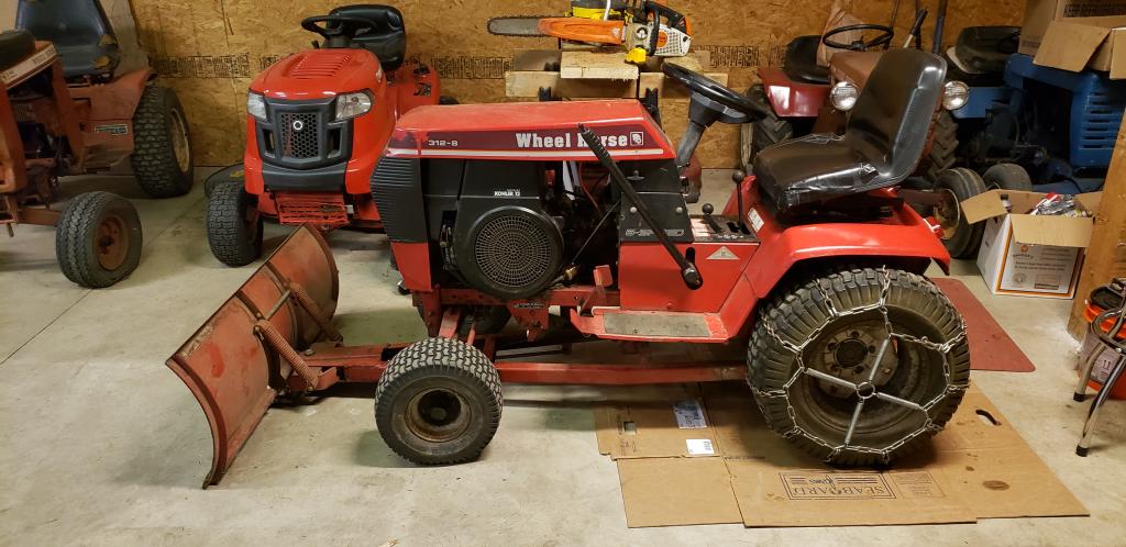

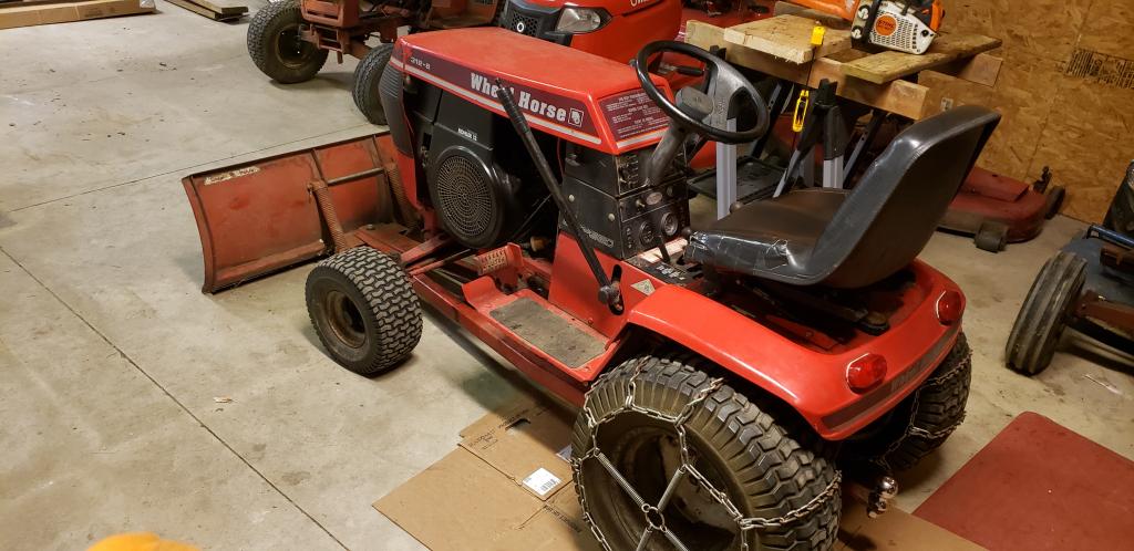

Gordyhogg 150 #93 Posted December 16, 2019 Just finished putting the transmission together and back in my 89 312-8 this will be the first winter i get to plow with this one. I can't wait! 6 2 Share this post Link to post Share on other sites

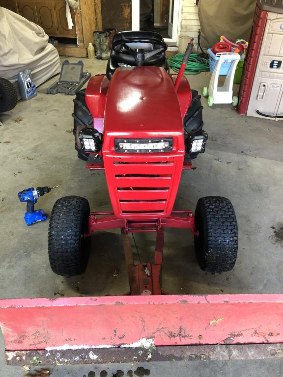

Sarthurs01 1,089 #95 Posted December 16, 2019 Got the c81 all ready to go and yet to have any snow to push lol 6 3 Share this post Link to post Share on other sites

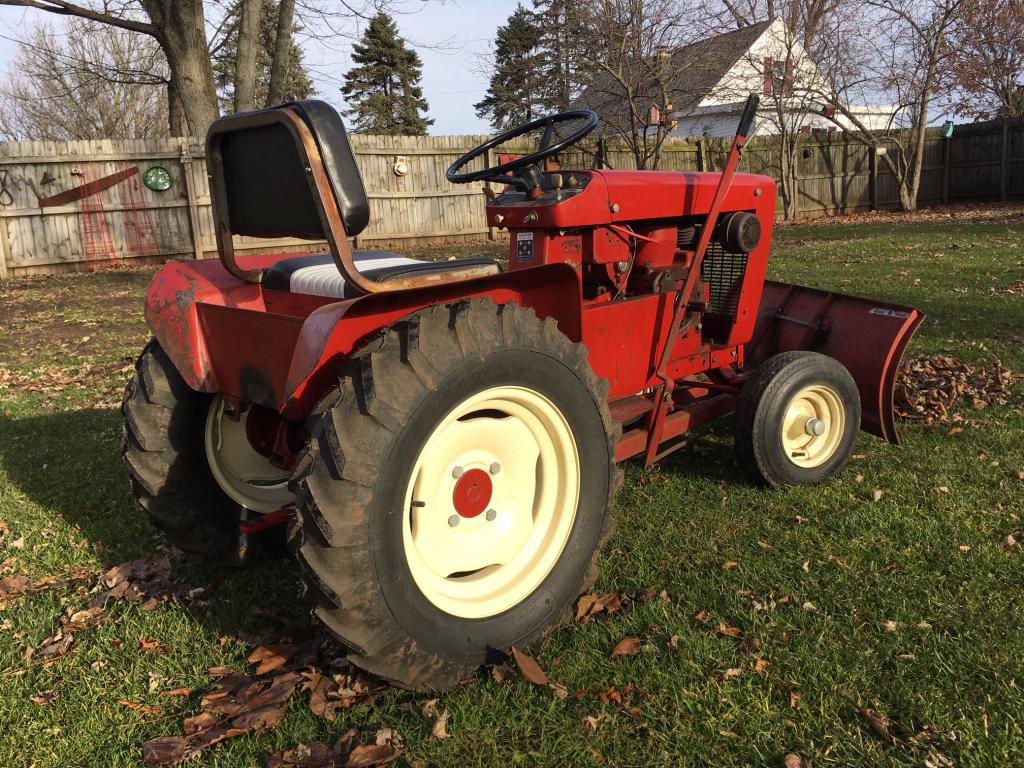

AHS 1,703 #96 Posted December 16, 2019 On 12/1/2019 at 4:29 PM, ebinmaine said: Got the bracket changed out from the tow hitch and mounted the plow today. Should be ready for the upcoming blast-o-winter. @ebinmaine is this cinnamon? It looks tough! And clean!👍💪 2 1 Share this post Link to post Share on other sites
ebinmaine 81,156 #97 Posted December 16, 2019 2 minutes ago, AHS said: @ebinmaine is this cinnamon? It looks tough! And clean!👍💪 Yeah man that's the Cinnamon. Definitely a rugged tractor. The paint color is actually a satin and part of the reason we went with a non gloss is because the sheet metal of the hood and seat pan are pretty rough. It isn't exactly spotless but Trina and I try to keep our stuff in decent condition all the time. This is one of two tractors that she and I have done a full frame off restoration on. 2 Share this post Link to post Share on other sites
AHS 1,703 #98 Posted December 16, 2019 @ebinmaine is that the kohler 16? Nice, you did a complete, and the horn!!😄 good job!! 👍 I know the feeling, I did a 85% restore on my 70 Raider 12. 1 Share this post Link to post Share on other sites
ebinmaine 81,156 #99 Posted December 16, 2019 3 minutes ago, AHS said: and the horn Gotta havva horn... At least when you're bringing it out in public like to Owls Head and stuff 1 Share this post Link to post Share on other sites
