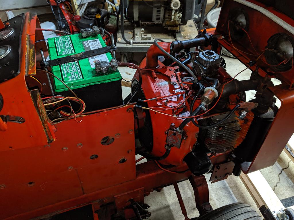

Choomanfoo 0 #1 Posted November 19, 2019 My fuel pump is filling my crank case full of gas. I can not seen to find a replacement that matches. Can I switch it to an electronic fuel pump? Share this post Link to post Share on other sites
lynnmor 9,073 #2 Posted November 20, 2019 You can find universal vacuum fuel pumps or install an electric one. If you could describe the engine you have or a wider photo might help. Someone on here might be able to give you a source of repair parts for the current pump. One like this might work. What ever you do, change the oil immediately and don't run it till the pump problem is solved. Share this post Link to post Share on other sites
953 nut 70,313 #3 Posted November 20, 2019 Many of us have switched to electric fuel pumps, easy starting and no gas going into the crank case. Ant low pressure electric fuel pump will be fine. Attach the electrical feed to the "A" terminal on your ignition switch. 2 Share this post Link to post Share on other sites
