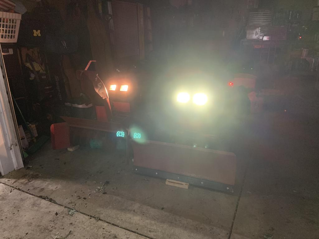

lynnmor 9,042 #1 Posted November 19, 2019 I bought 12 watt PAR 36 lights from here. I was surprised that the stock halogens were much brighter straight ahead, but the LEDs put out a soft, full coverage light. The photos tell the story. 1 Share this post Link to post Share on other sites
bds1984 1,519 #2 Posted November 19, 2019 Perhaps the stock headlights are more of a spotlight pattern where the new LEDs are a flood light patter with a wider angle of light dispersion. I bought a very similar set of LEDs a couple months ago for my 315-8 and experienced the same result before I realized I should have purchased spot lights instead of flood lights. They'll stay in my 315-8 for now only because they were cheaper than the regular halogens that are on the shelves around me. 1 Share this post Link to post Share on other sites
roadapples 6,987 #3 Posted November 19, 2019 Be interesting to see one spot and one flood on the same tractor... Share this post Link to post Share on other sites
lynnmor 9,042 #4 Posted November 20, 2019 56 minutes ago, roadapples said: Be interesting to see one spot and one flood on the same tractor... Might be the ticket. I was hoping that the much higher lumens of the LEDs would compensate for the 160 degree angle. Seeing to the side is important when twisting and turning while doing snow removal. While the look of the headlight bezels is nice, they waste some light. 120 degree lamps are available and should be better, and there are some specialty PAR 36 lamps that are crazy high priced that have a spot beam in the center. Maybe I'll put one halogen back in and give that a try. 1 Share this post Link to post Share on other sites
peter lena 10,076 #5 Posted November 20, 2019 its the Chinese manufacturing mentality, it barely works, and is saposed to replace something that lasted for decades. everything made in china is made in small batches , to see how it sells, mainly sold thru Alibaba marketing site, to them there is no standard , very little quality , and the most glaring point is that these people do not use anything they sell, none of it make any sense ( whats that ) ? you will end up finding your answer in some related lighting site, at some point these times will be the good old days . 2019, pete Share this post Link to post Share on other sites
lynnmor 9,042 #6 Posted November 20, 2019 To be fair, the lamps are marketed as landscape lighting and I knew that going in. They do put out more light but it is blanketed over a larger area. When you look at the OEM halogen lighting pattern, it too leaves a lot to be desired since most of the light is straight ahead and little to the sides. 1 Share this post Link to post Share on other sites
pfrederi 21,172 #7 Posted November 20, 2019 Be like me...do not plow at night I did it once just to try out some LEDs i put on my principal plow tractor. Very nice light (but sort of ugly) haven't used them since.... Share this post Link to post Share on other sites
Sparky-(Admin) 26,389 #8 Posted November 20, 2019 Greater light output wasn't my goal when I put similar LED's in the 310-8 I gave to my son. His has the weak charging system (3a I think). A reduced electrical load and a longer lifespan (time will tell) was my main goal on his machine. The factory bulbs shine out plenty far for what we do on these tractors, not like we are whizzing down a dark highway at midnight doing 70MPH. 1 Share this post Link to post Share on other sites

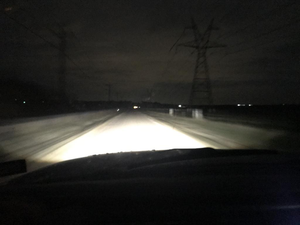

ZXT 2,402 #11 Posted December 14, 2019 (edited) I've been dealing with trying to find new, better headlights for my 95 Ram 2500. Couldn't see 30 feet in front of the truck on back roads. I've been doing quite a bit of research on what performs well and what doesn't, and that might still be somewhat relevant here. I've found that LED bulbs are BRIGHT. That said, there is no focus to them; they just flood in a halogen housing. For car headlights, they are just now starting to come out with aftermarket LEDs that are safe (wont blind oncoming traffic) and legal. The big key with them is that they have a projector lens that focuses the light straight ahead, instead of directing it back and utilizing the reflective headlight housing. Reading through this got me wondering if such a thing existed for 1156 bulbs. I found what is essentially a extremely simplified version of what I used in my truck on eBay. Not sure how well they perform, but they might be something to try since they're fairly cheap. I wound up building "retrofit" lights for my truck. I used a set of projectors that use HID bulbs, and they are very focused and provide excellent light pattern. Without the projectors, they would flood and blind everyone. A fairly complex setup but worth it. The housings are factory but they are essentially unused - I could've painted the reflecting black if I had wanted to but I left it alone. Edited December 14, 2019 by ZXT Share this post Link to post Share on other sites
pfrederi 21,172 #12 Posted December 14, 2019 Looking at the projector lens I would think you would have to figure out how to move the sockets from the bottom of the headlight bucket (where they are now) to the back of the bucket so it would shine out ahead of you not at the top of the bucket. Share this post Link to post Share on other sites
ZXT 2,402 #13 Posted December 14, 2019 26 minutes ago, pfrederi said: Looking at the projector lens I would think you would have to figure out how to move the sockets from the bottom of the headlight bucket (where they are now) to the back of the bucket so it would shine out ahead of you not at the top of the bucket. You're absolutely correct. It's been quite a while since I've had my lens off and I completely forgot how they went in! Share this post Link to post Share on other sites

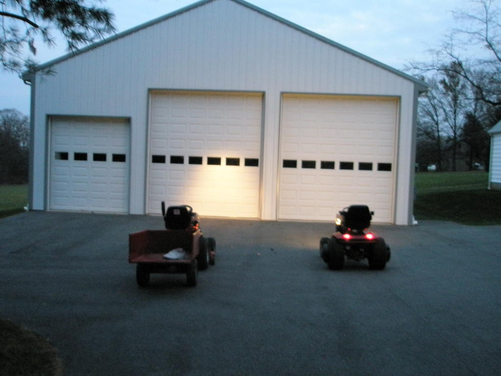

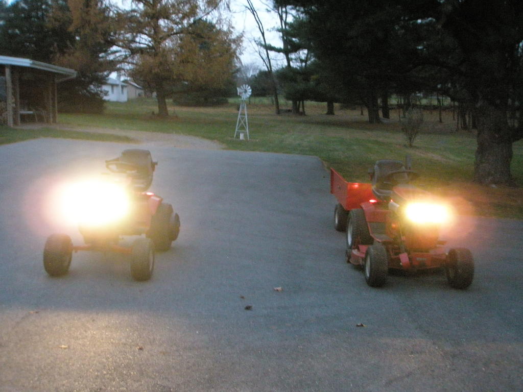

Andy N. 2,822 #14 Posted December 14, 2019 I have these LED headlights installed in my 416-A. Here is a side by side comparison with my stock halogen 520-H. 1 Share this post Link to post Share on other sites
