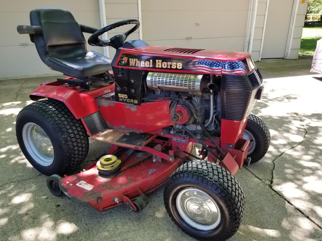

Rich16 44 #42 Posted November 8, 2020 This post made me feel sane again - I just had the exact same problem and have the answer others have suggested - and beware about oil filter cross-references or what you think you're ordering (or getting). Always get the main ones recommended by others here. Ebay offered up a 400hr 520h with a 60" deck for the steal price of $650 - and just 3.5 hours away - how could I refuse? There was excess oil caked around the usual 'loose' oil drain pipe and beyond in the tins - more than made sense - but it ran fine getting it on the trailer and home though it wasn't well cared for and needed a lot of cleaning. Lifted the engine up and tightened the drain with teflon tape - carefully by hand - and also ordered aluminum (light) replacements from McMaster-Carr for $28 incl. shipping to replace and try. Know some don't like teflon tape. The engine oil was black & hadn't been changed in a long while so I changed - but forgot to change the filter. And here's where it started. The exact same problem where this thread began. Oil filter felt like it was going on fine but impossible to really see. Hand turning with another 1/3 turn with the wrench - typical. Cranked it up and - shocked - oil poured out the bottom with the oil light flickering. Huh? Like all of it. Some choice words as it was on the driveway and the pan wasn't situated right. Stopped it immediately. A few bolts were missing where the back shroud meets the front & I didn't think much about it - but seemed someone was there before maybe with the same issue? Lots of excess oil caking. Repeated everything, tight, did it all again - and all the oil poured out on the driveway - twice now. Why? Didn't do it the day before so what's going on? So I pulled the engine today to figure this out and clean everything up - my friend from the Tuul crib in Nashville sold me a spare engine a few years ago that runs fine so why not just replace for now? Was prepared for the worst and read of possible nasty rear leak causes here - but was having trouble getting the PTO completely off to transpose and decided to investigate the problem & just fix if possible. Lots of oil soaked grass in the shrouds and along the back of the engine but nothing's loose & it's not coming from the crank area. Whatever is leaking was obviously coming from the oil filter area & spraying around it long before I owned it. It WAS the oil filter - I'd gotten a case of 'em (supposedly the NN1043 compatible) from a reputable seller who sent the Stens 120-345 - scrolling way down it has the Onan p220 listed but it's not a good fit (and is the NN10147). I swear I ordered the Toro 10143 'compatible' - maybe someone saw the Onan listed and thought it'd be OK? I wasn't paying attention. Screwing the filter in looking right at it and it'd screw on two different ways - a wrong way and a right way but both 'felt' OK. Male engine threads looked fine & not cross threaded - weird. Filter threads look fine. No doubt though - the filter threaded opening had just enough slop to go on wrong and feel like it was tightening normally - but wasn't and missed seating the gasket by 1/4". Problem solved. With the filter lifted up a bit it'd screw in properly and seat OK (and probably work OK). The excess oil everywhere had to be due to others not tightening or putting it in correctly and leaking. Oh, well - it needed a thorough cleaning anyway and I learned about the shroud over the oil filter neither of mine have - going to fix! And comments about oiling the rubber seal - yes! A wise old school mechanic some 50 years ago told me to prevent seizing the next time you take it off always rub some oil on it first - always have and never had any issues getting one off. Share this post Link to post Share on other sites

Rich16 44 #46 Posted November 9, 2020 20 hours ago, lynnmor said: As long as you have the Teflon the aluminum threads will not gall. If you want to do an upgrade, install a drain valve with a short piece of tubing. Lynnmor - really appreciate your and Cleat's help - always spot on & thanks for responding. I've used my trusty 416-8 Kohler bought new in '85 without incident (as have many). Thought getting a 48" deck was a major upgrade. My first Onan experience was only two years ago thinking the hydraulics would be easier with my bad arthritis & I'd read the pros and cons here. - but absolutely love it and when I get on my 416 it now feels pretty rough. The main (520 lethal) forum issue over and over (aside extra maintenance) is the rear valve seat/rear cylinder overheating and I almost didn't get one because of it - and I'm always paranoid about it. I'd joined the forum to find out more about this before purchasing & made the seller of my first one play a video to listen to it and be sure it sounded OK before even considering buying it. Despite this latest glitch I'm a 520 major fan - I mowed 20 acres on our farm post bushhogging with my 48" deck - the guy who bushhogged said it was too thick to finish mow and thought I was nuts using my 'lawn tractor' - loved the look on his face a week later when he saw the place & he wanted a closer look at the 520. Took about 4 half days to do. Many compliments. So the rear cylinder issues - I took the belt guard off this latest acquisition to assess rear cylinder being clean & saw the oil caked issues - started it up and was astounded at the air velocity coming off the rear cylinder. I know others have posted about cutting slots and such but this is THE cause of all of this and the belt guard must be modified & should never be put on stock if you're going to use it for work - I'll never run my first one ever again with the stock one on. Amazing I haven't already screwed it up. Has this been brought up more and I missed it? Have ordered two extra guards from AZ tractor and intend to cut rectangular slots where the rear cylinder it - and cover inside with wire mesh. Saw the slots post for cooling but it still would block significant air flow. Seems there's more about fixing problems posted on the site than fixing why they occur? Just wanted your opinion. It wouldn't surprise me if many of the other Onan 'problems' with valve adjustments, etc. etc. aren't related to chronic overheating that's too easy to fix? When I took the rear head off was surprised it's way better than expected with 400+ hrs. of abuse. Know there are other old non-Wheel Horse Onan machines with the engine mounted transversely with drive shaft forward - maybe because of the cooling issues? I suspect doing this will cure 90+% of the more serious Onan engine related problems - what do you think? Share this post Link to post Share on other sites
