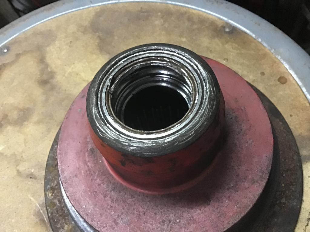

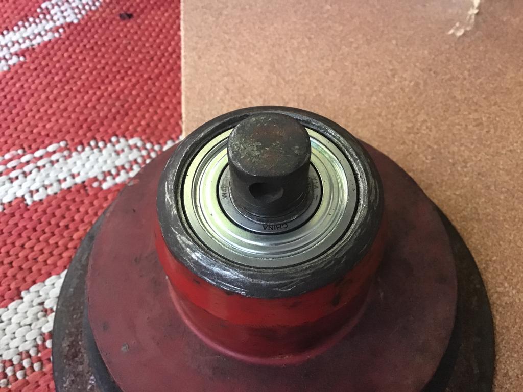

PMason 3 #17 Posted November 16, 2019 Took the clutch bell off. Straight forward process. Now to get the remnant of the bearing out of it. As most of you noted, needle bearings seem fine. Just need some fresh grease. Once I get it out then down to NAPA. Share this post Link to post Share on other sites
lynnmor 8,904 #18 Posted November 16, 2019 I've seen a number of bells where people allowed the end to be carved away right back to the snap ring. I guess you have no snap ring or groove and a new bell is in order. Share this post Link to post Share on other sites
PMason 3 #19 Posted November 16, 2019 15 minutes ago, lynnmor said: I've seen a number of bells where people allowed the end to be carved away right back to the snap ring. I guess you have no snap ring or groove and a new bell is in order. I was wondering about that. No outer snap to be found. Assuming I can get the outer bearing track out could I in theory replace it and run without a snap ring? I used this tractor for snow blowing only. Share this post Link to post Share on other sites
Lee1977 7,709 #20 Posted November 16, 2019 You can give it a try most of the pressure on the bearing is in holding the clutch disk tight. I would adjust the PTO brake out 1/8" or more out from the bell to take the pressure off the bearing when released. My guess is the roll pin holding the bracket on the PTO loop is bent or the bracket is coming off one side of roll pin or the holes in the bracket are worn. This is letting the head of the lock pin rub against the end of the bell. 1 Share this post Link to post Share on other sites
PMason 3 #21 Posted November 16, 2019 Going to give it a shot. At this point I would just be out the bearing. Share this post Link to post Share on other sites
