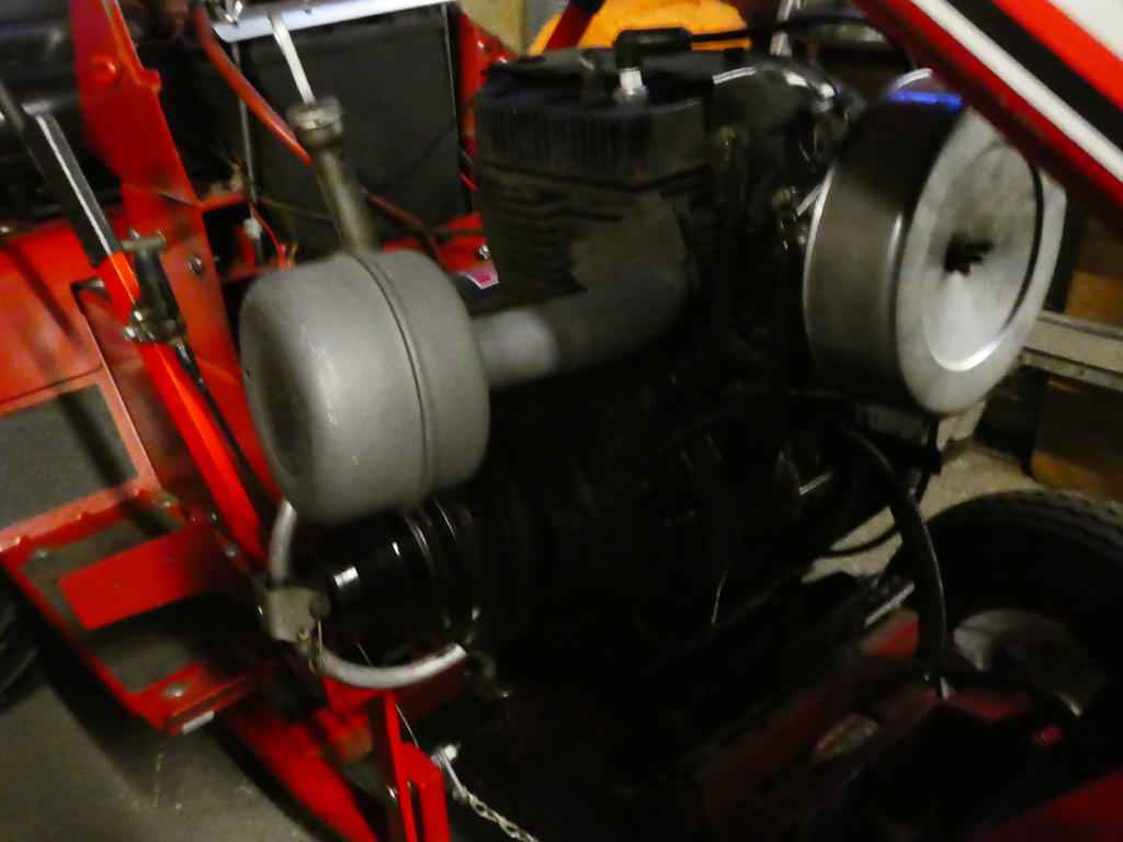

Mickwhitt 5,259 #1 Posted November 11, 2019 Hi all, I am just wondering about modifying the exhaust on my C125. Currently its mounted on a flange to the side of the cylinder head. The exhaust firing down to the right hand side of the engine. I am looking at having a stainless silencer made and wondered if there are any thoughts on moving the silencer away from the side of the engine. Maybe using flexible hose or having a custom pipe run made so that the silencer is under the chassis and out of the way. I dont have a cutting deck so there should be room to site a silencer box. Or would I be better leaving it, or putting a vertical stack on? So many options Mick 2 Share this post Link to post Share on other sites

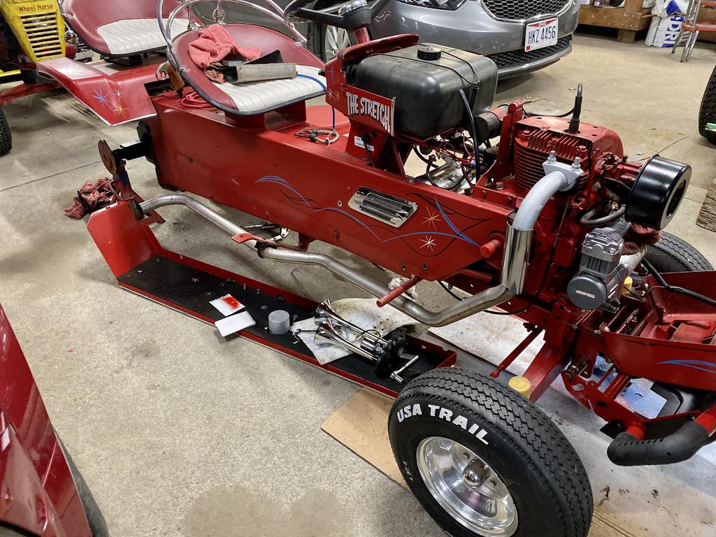

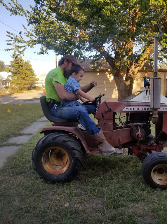

Achto 32,892 #2 Posted November 11, 2019 Maybe @Bear G can post some pics of "The Stretch". The exhaust on his custom machine runs under the tractor and it sounds soooo cool. I have stacks on some of my tractors and like the look & sound. Just have to remember to watch out for low tree limps that will try to tear the stack of when you drive under them. 1 Share this post Link to post Share on other sites
ebinmaine 81,048 #3 Posted November 11, 2019 In a general manner of speaking I am a fan of stacks for the most part. Definitely have to watch out for low hanging items but I don't have any on my property. Our forest gets trimmed whenever we have one that comes even so much as close. If you're going for QUIET, get a 10 horse Cub muffler from the late 70s. That can actually be turned into a stack. 1 Share this post Link to post Share on other sites

Bear G 690 #6 Posted November 11, 2019 3 hours ago, Achto said: Maybe @Bear G can post some pics of "The Stretch". The exhaust on his custom machine runs under the tractor and it sounds soooo cool. I have stacks on some of my tractors and like the look & sound. Just have to remember to watch out for low tree limps that will try to tear the stack of when you drive under them. Exhaust runs under the running board which is off right now. Most many muffler shop will bend and retrofit the pipe about any way you want it. hope this helps. 1 3 Share this post Link to post Share on other sites
Stormin 9,988 #7 Posted November 11, 2019 (edited) I had a verticle stack on my C-125. Bit of a bind when mowing under a weeping willow by the pond. I've now fitted a Briggs & Stratton pepper pot one. Nothing fancy but functional. Original paint burnt off pretty quick. Repainted with BBQ paint. Edited November 11, 2019 by Stormin 4 Share this post Link to post Share on other sites
Mickwhitt 5,259 #8 Posted November 12, 2019 If I copy the silencer barrel in stainless and get it piped up down low I think it could look good. But the vertical stack sounds good if I'm using her in snow or flood lol I will give it some thought and chat to the local exhaust company. Mick 2 Share this post Link to post Share on other sites
ClassicTractorProfessor 5,455 #9 Posted November 15, 2019 I love the stack I put on my C125, but as others have said you have to really watch for low hanging branches. 1 Share this post Link to post Share on other sites

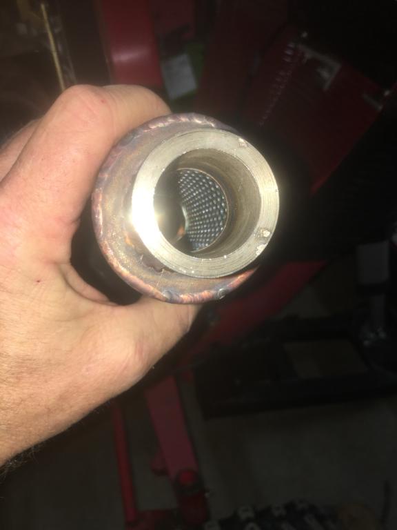

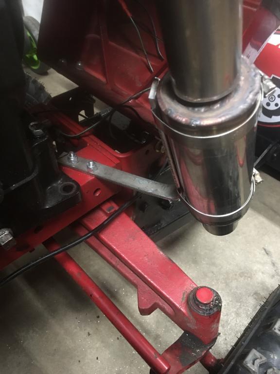

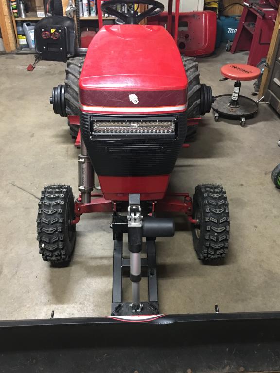

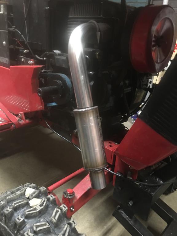

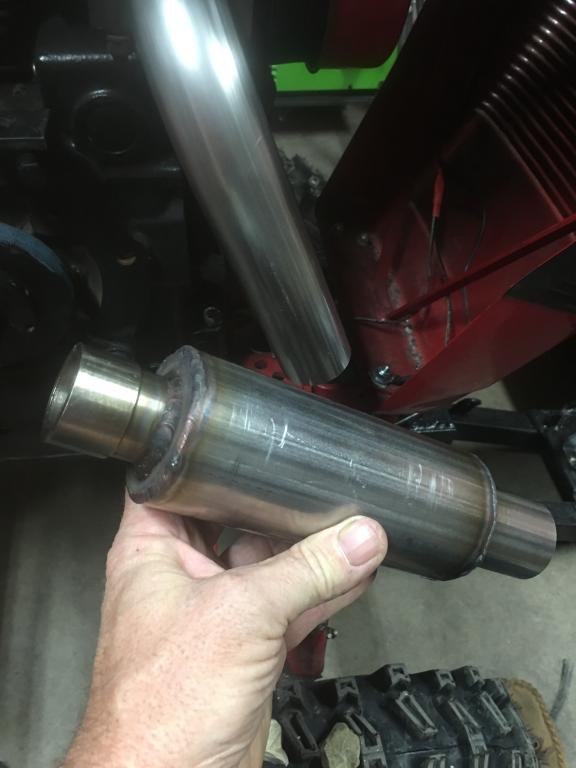

KrazeyOlDave 860 #11 Posted November 28, 2019 (edited) I bought the 2.5” baffle, 1.625 elbow, 2.5” straight pipe on amazon, 2 stainless washers I made on a lathe. Took some 1/4” x 1” stainless flat stock and bent it up in a vice until I obtained my shape. All down hill from there. Tires don’t hit it and more importantly, keeps the heat away from my engine. I’m still building the tractor, it’s purpose will be light duty bucket tractor. Edited November 28, 2019 by KrazeyOlDave 1 Share this post Link to post Share on other sites
