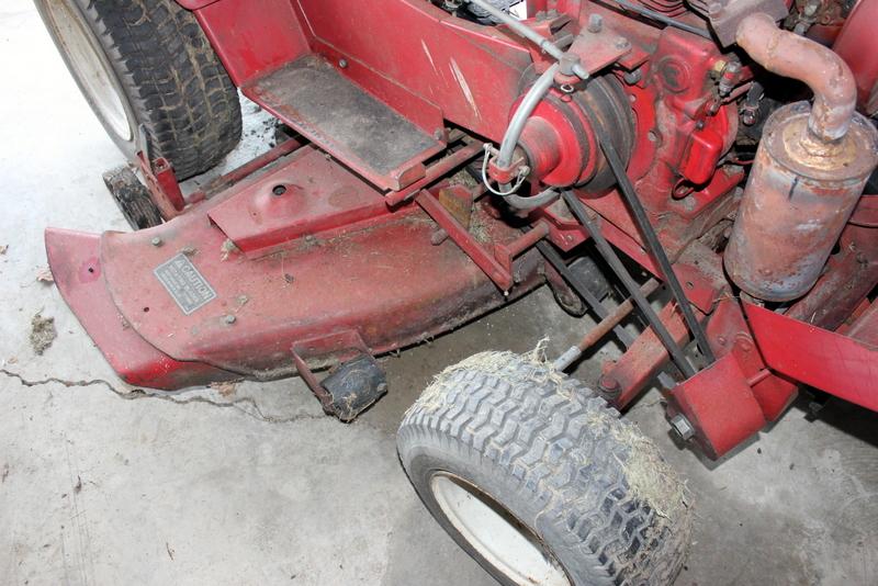

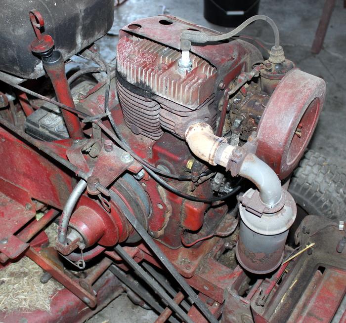

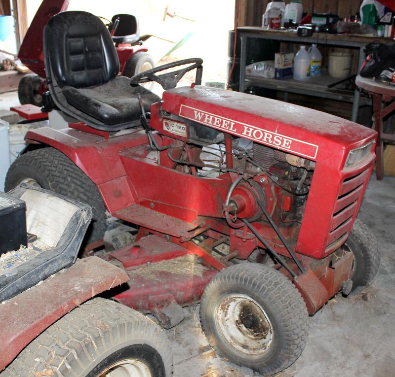

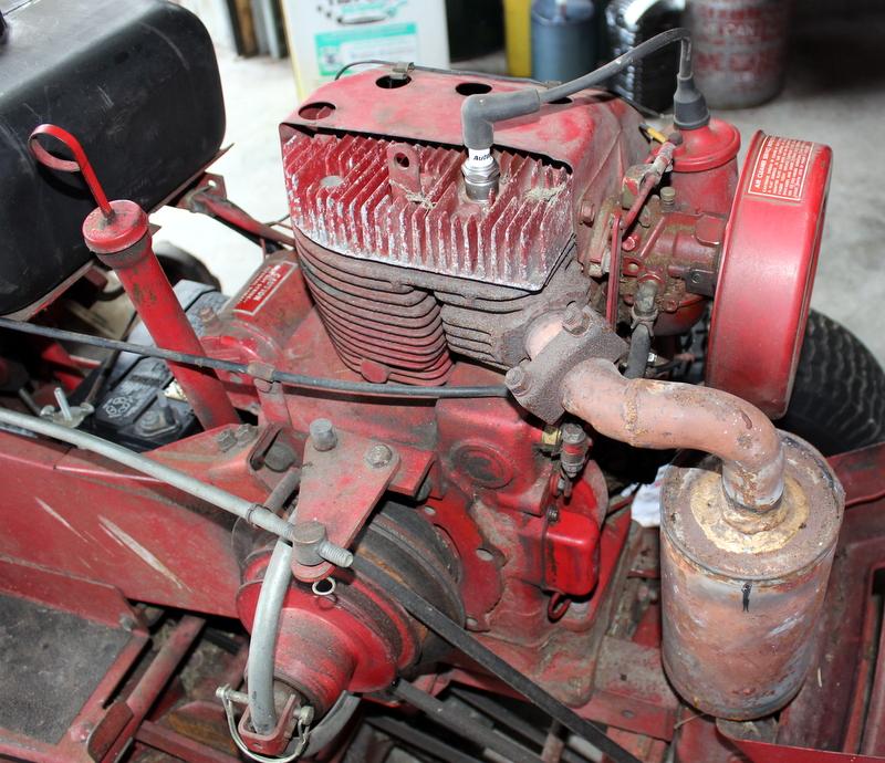

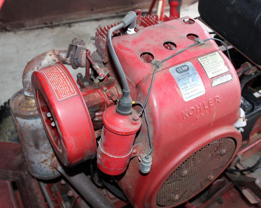

Mr Magoo 226 #65 Posted December 11, 2019 I also got some pictures of the #2 C-120. It is in much rougher condition than the first that I am messing with now. I think it has been sitting much longer unused. All of the soft components like rubber and wiring are much more deteriorated and there is more corrosion on other parts than the #1 machine. 4 1 Share this post Link to post Share on other sites

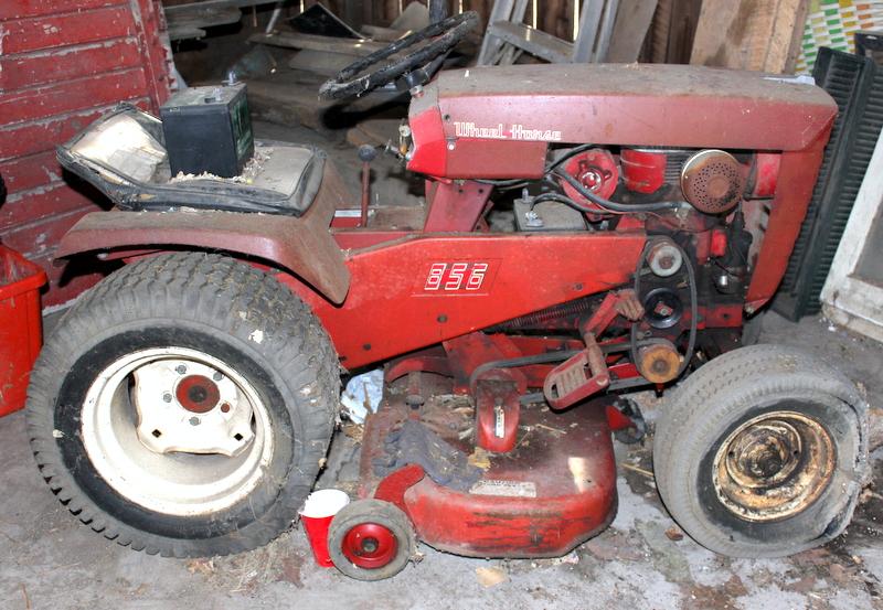

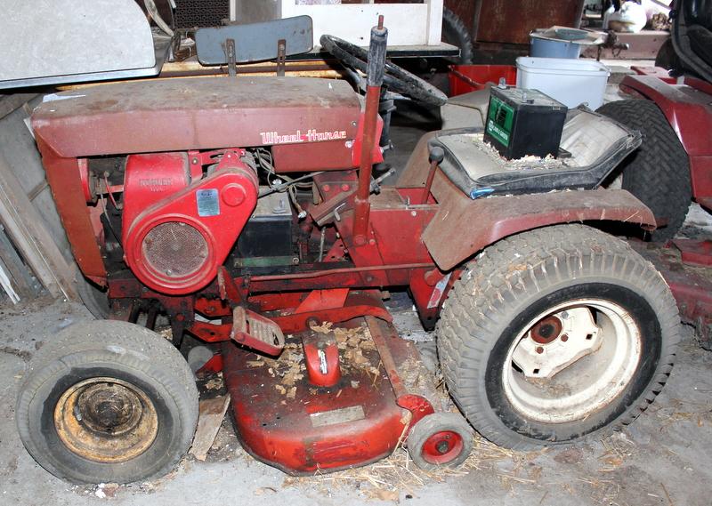

Mr Magoo 226 #66 Posted December 11, 2019 I was able to finally dig out the 856 and get some pictures. 5 3 Share this post Link to post Share on other sites
ebinmaine 81,156 #67 Posted December 11, 2019 Very nice! Thanks for the pictures!! FWIW... Your "rough" C120 is in FAR better condition than my Cinnamon Horse was when we shredded that for restoration. So.... Safety switches. Yes. Now it's time to run a jumper past them (for test purposes ONLY) to find the fault or issue. You can do a continuity/operation test on each one individually to ensure its own operation and possibly find a bad terminal, connection etc... 1 Share this post Link to post Share on other sites
Mr Magoo 226 #68 Posted December 11, 2019 55 minutes ago, ebinmaine said: Very nice! Thanks for the pictures!! FWIW... Your "rough" C120 is in FAR better condition than my Cinnamon Horse was when we shredded that for restoration. So.... Safety switches. Yes. Now it's time to run a jumper past them (for test purposes ONLY) to find the fault or issue. You can do a continuity/operation test on each one individually to ensure its own operation and possibly find a bad terminal, connection etc... Thanks Eric. I could really use some help from all of you experienced folks who have been doing this for a while. I need to come up with some sort of value for each as they sit so I can have some sort of an idea where to start with the owner to try and buy one or more of them. I am still pretty much a novice with all things WH. I want to be extremely fair with the owner and myself too. I think he may let go of the second C-120, but not sure about the 856. The 856 may hold some sentimental value for the family. I have done a lot of searching on the net trying to find similar ones for sale. It find that in a non-running condition that maybe $150.00 seems to be a common price and that running, "turn key", cutting grass in good condition can be anywhere from $500.00-$600.00. I really am not sure about the value of the 856. The problem I have is that I'm already over $100.00 deep into the first one so I'm going to have to pull back monetarily until I figure the values out. By the time tires and a new battery go into it, it will not be far from the max value. That is all based on hoping that the deck is in good shape. If the spindles, blades, pulleys, or belts need replacing we are definitely maxing out or surpassing top dollar for the condition that they are in I think or am I way off base? I hope several of you can help me get this all into context. Share this post Link to post Share on other sites
Retired Wrencher 7,037 #69 Posted December 11, 2019 Mr Magoo I must missed your post sleep at the wheel. As I can see the 856 = had many of these would be the easiest to work on. I see it would need axel seals and it looks like an easy fix because of the leaking. They should come off some what easy. the engine needs a good cleaning so you will no where you are at with this engine when you get it running. Good easy - powerful - work on tractors. The wiring probably needs cleaning I you wire brushes on a small drill for this. Take it from there . As you can see already you have a lot of help here. Enjoy the project. 1 Share this post Link to post Share on other sites
ebinmaine 81,156 #70 Posted December 11, 2019 You'll find all the help you need here so don't sweat that even for half a second. Just keep asking questions or search for what you're looking for and you'll come up with it. Value... I can't give you a great basis for the value because I live in a different area but I think $150 is a very conservative price considering the transmission alone can often get that much. When giving consideration to maximum volume you should look at what the new box store temporary tractors are selling for. I would rather put $2,500 into an old tractor every 5 or 7 years then to go by a new one at any point. The value that you have in mind of around $600 is probably fairly close for your area. But don't consider that to be a maximum. Share this post Link to post Share on other sites
