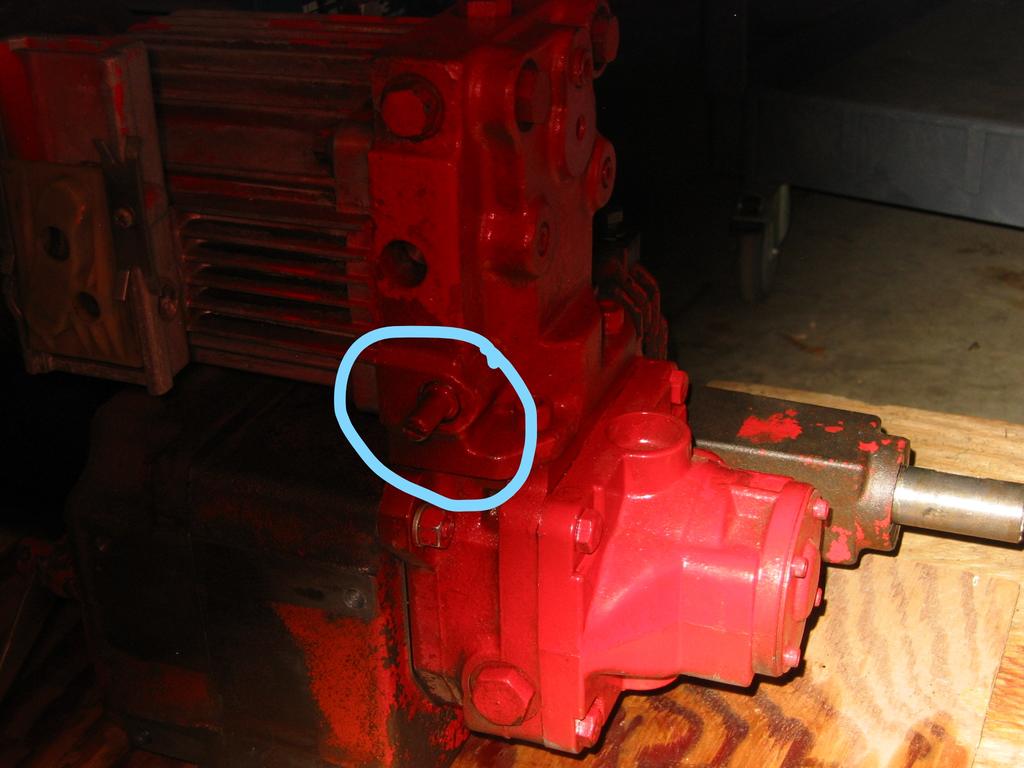

Mr Magoo 226 #17 Posted November 11, 2019 One thing I need to figure out is how to disengage the hydro so it can free wheel to move it. I am trying to get through the manual that I downloaded. I would love to find an original manual, but I imagine that may be hard to come by. 1 Share this post Link to post Share on other sites
pfrederi 21,145 #18 Posted November 11, 2019 Tow valve is on the left front of the hydro pump turn counter clockwise 1 turn should do it. 4 Share this post Link to post Share on other sites

oliver2-44 11,734 #22 Posted November 11, 2019 Since the tow valve hasn’t moved in quite a few years start soaking it with your favorite penetrant. Try to use a large blade screw drive that fills the slot. I like to us a long one with a square shank. That way I can put pressure to hold the blade in the slot and turn the screwdriver with a wrench or crescent on the square shank 3 1 1 Share this post Link to post Share on other sites
