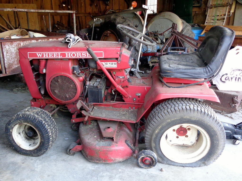

Mr Magoo 226 #28 Posted November 17, 2019 Okay here is the one good shot I could get of the first 120 I'm working with. 1 7 Share this post Link to post Share on other sites
Pullstart 71,211 #29 Posted November 17, 2019 Looks pretty much all there! That’s a start! 4 Share this post Link to post Share on other sites
ebinmaine 80,635 #30 Posted November 17, 2019 With a little cleaning up that will be a nice machine 2 Share this post Link to post Share on other sites

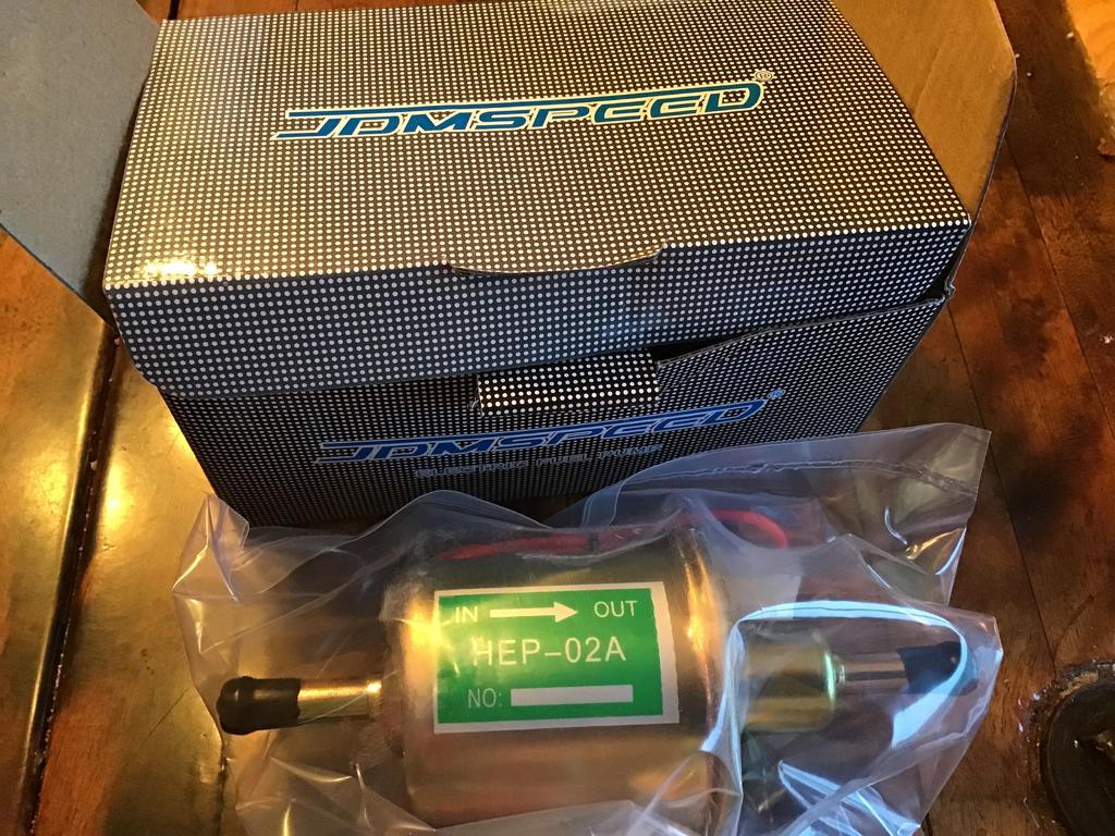

Pullstart 71,211 #46 Posted November 18, 2019 Speaking of which, lookie what came in the mail today! 2 Share this post Link to post Share on other sites
pfrederi 21,145 #47 Posted November 18, 2019 12 minutes ago, pullstart said: Speaking of which, lookie what came in the mail today! Looks just like the one I had on myC141 with front mount deck that died on the far side of the pasture (only a very few hours on it less than 10).. Better luck with yours!!! 1 1 1 Share this post Link to post Share on other sites
Pullstart 71,211 #48 Posted November 18, 2019 @pfrederi I’ve had good luck so far with it on the wood splitter, we’ll see how it works with tractors too Share this post Link to post Share on other sites
Mr Magoo 226 #49 Posted November 19, 2019 I looked at that one and it does not exactly get great reviews. Good luck. Share this post Link to post Share on other sites
WHX?? 58,064 #50 Posted November 19, 2019 (edited) 12 hours ago, Mr Magoo said: I looked at that one and it does not exactly get great reviews. Good luck. I just put that one on a z turn Briggs I repoed for a guy..... worked great. See what happens if he complains but for what I charged him to do the repower just go get another. Edited November 19, 2019 by WHX24 2 Share this post Link to post Share on other sites
