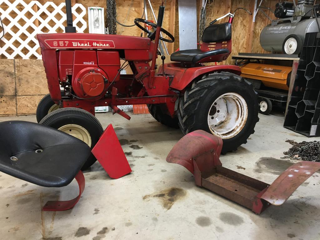

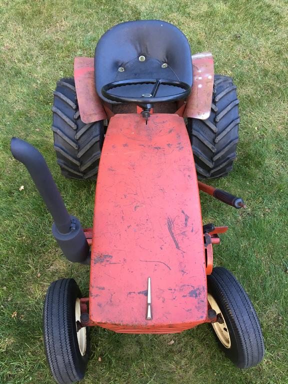

Sparky-(Admin) 25,935 #1 Posted November 3, 2019 Picked up a few parts from a couple of great members here @wallfish and @Chris T . Hmm, what should I do ? 6 1 Share this post Link to post Share on other sites

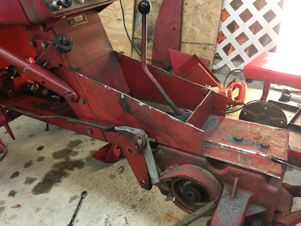

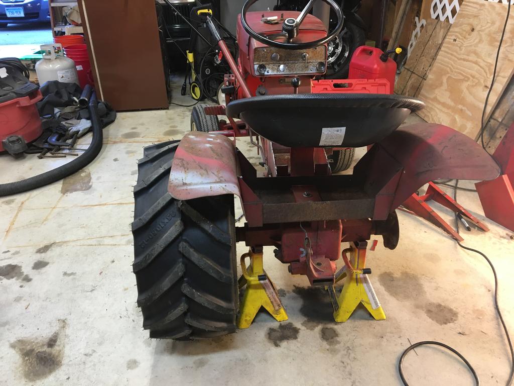

Sparky-(Admin) 25,935 #2 Posted November 3, 2019 Easy decision, time to cut some sheetmetal. 6 4 1 Share this post Link to post Share on other sites

Sparky-(Admin) 25,935 #4 Posted November 3, 2019 8 minutes ago, stevebo said: This is a first.... Have never seen you do fab work buddy... Your right, I’m not a great fabrication guy. It’s by no means a professional job. Share this post Link to post Share on other sites
wallfish 20,219 #5 Posted November 3, 2019 Look at Mike the chopper go! Looks good. If you don't have a plan for the raw edge, it can be covered with automotive door edge guard 4 1 Share this post Link to post Share on other sites

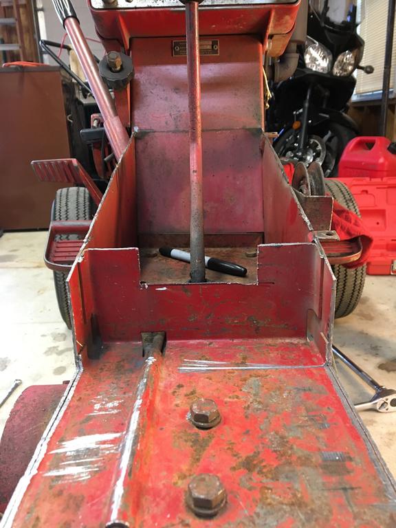

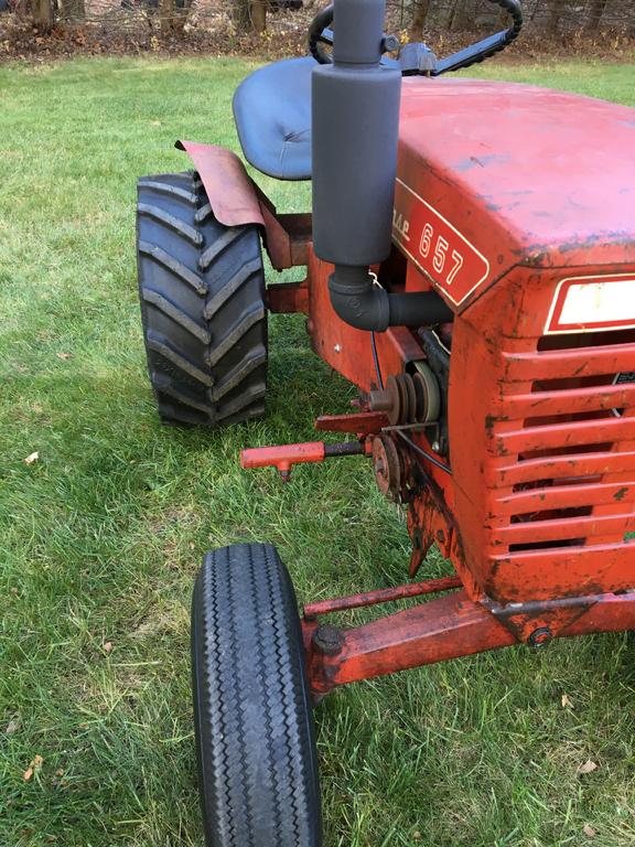

Sparky-(Admin) 25,935 #6 Posted November 3, 2019 Still needs fine tuning, remove sharp edges, clean up the overall install and what-not. But it’s back together and I buzzed around the yard a few times. It’s actually a bit more comfy for me now. I’m 6’1” and this mod gave me a bit more leg room 7 9 3 Share this post Link to post Share on other sites

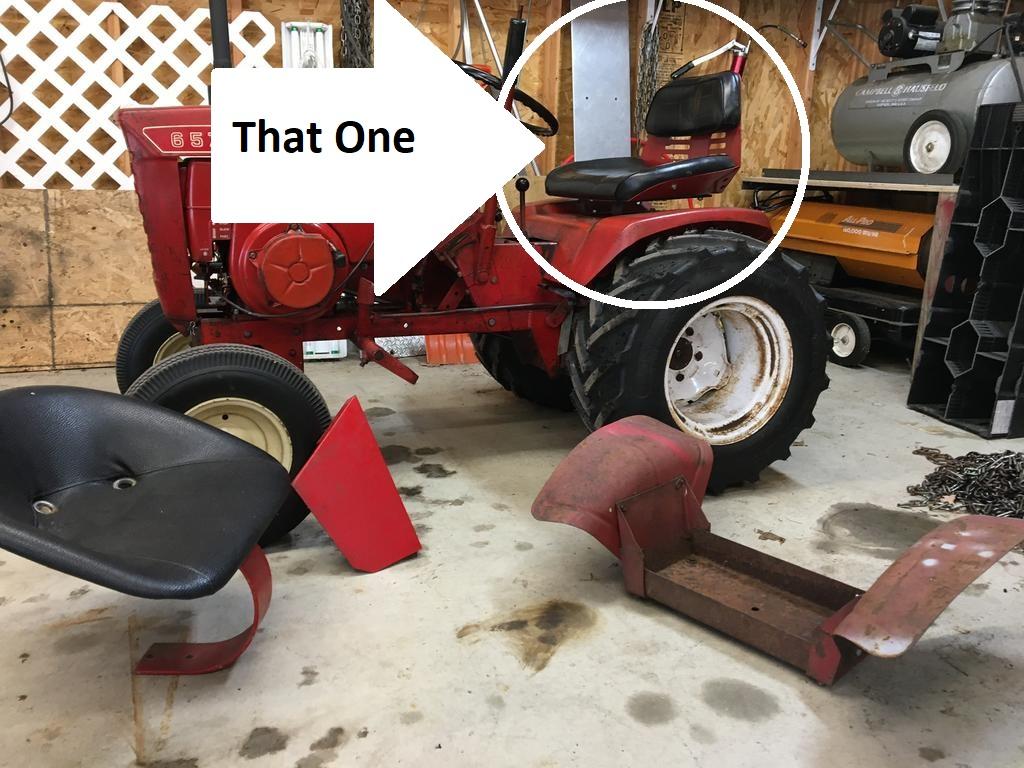

wallfish 20,219 #7 Posted November 3, 2019 I want the old seat! 1 1 Share this post Link to post Share on other sites
Sparky-(Admin) 25,935 #8 Posted November 3, 2019 6 minutes ago, wallfish said: I want the old seat! The two piece seat? Share this post Link to post Share on other sites
wallfish 20,219 #9 Posted November 3, 2019 6 minutes ago, Sparky said: The two piece seat? Let me know if don't have any plans for it. It's certainly not something I need, just like those seats. 4 3 Share this post Link to post Share on other sites
Pullstart 70,688 #10 Posted November 3, 2019 That’s totally awesome! Still the 657 belt guard too? 1 1 Share this post Link to post Share on other sites
Chris T 397 #11 Posted November 3, 2019 Such a sweet machine! Very cool to see it come together! Almost want it back in my yard again 🇺🇸 2 1 Share this post Link to post Share on other sites
Sparky-(Admin) 25,935 #12 Posted November 3, 2019 46 minutes ago, pullstart said: That’s totally awesome! Still the 657 belt guard too? Thanks for the complement! And yep, it’s the 657 belt guard. Used it as a template for the cut line. 3 3 Share this post Link to post Share on other sites

squonk 47,375 #15 Posted November 4, 2019 Those seats are comfy. Never cared for the " slap the seat on the fender pan" style. 1 1 Share this post Link to post Share on other sites
Pullstart 70,688 #16 Posted November 4, 2019 1 hour ago, Sparky said: Thanks for the complement! And yep, it’s the 657 belt guard. Used it as a template for the cut line. What about the sheet of steel that was bolted to the trans? Did you just sandwich it in place? Share this post Link to post Share on other sites
wallfish 20,219 #17 Posted November 4, 2019 1 hour ago, Sparky said: Used it as a template for the cut line. Good idea to angle that body down. Makes it transition into the round fenders nicely 1 1 Share this post Link to post Share on other sites
Sparky-(Admin) 25,935 #18 Posted November 4, 2019 1 minute ago, pullstart said: What about the sheet of steel that was bolted to the trans? Did you just sandwich it in place? I left it since it has the “tube” for the rear lift cable. My round fenders toolbox didn’t have any provisions for it so I spaced the toolbox up 1/4” to cover the lift cable passage 5 1 Share this post Link to post Share on other sites

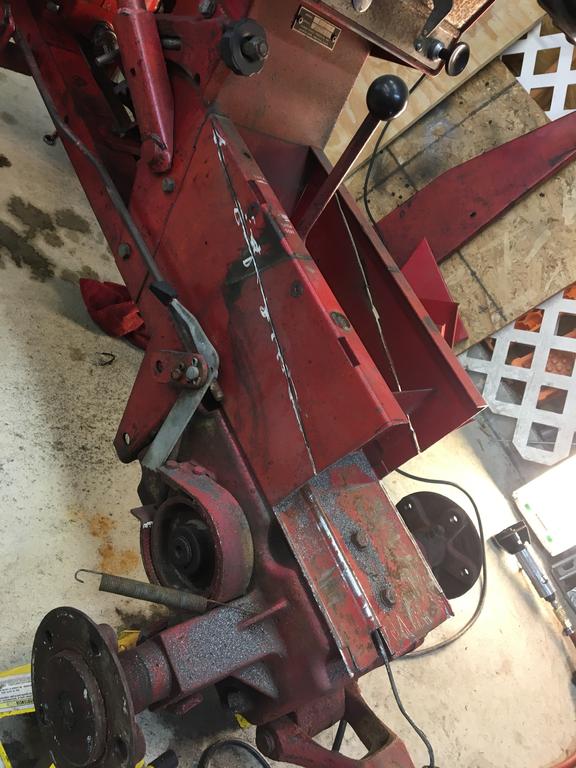

953 nut 67,385 #20 Posted November 4, 2019 13 hours ago, Sparky said: needs fine tuning, remove sharp edges, clean up the overall install If you save the lips from the cutoff pieces and turn them outward like the 1045 you could weld them on and support the belt guard and sheet metal on the other side. 7 Share this post Link to post Share on other sites
dclarke 4,270 #21 Posted November 4, 2019 Well done, Mike! Looks like the patina matches pretty good too. 1 Share this post Link to post Share on other sites
Sparky-(Admin) 25,935 #22 Posted November 4, 2019 52 minutes ago, 953 nut said: If you save the lips from the cutoff pieces and turn them outward like the 1045 you could weld them on and support the belt guard and sheet metal on the other side. I do have the pieces still. But when I cut the drive belt guard side I cut just above the mounting tabs for the belt guard. So I simply bolted it back on. No welder or welding skills here 1 Share this post Link to post Share on other sites
Lee1977 7,709 #23 Posted November 4, 2019 11 hours ago, Sparky said: I do have the pieces still. But when I cut the drive belt guard side I cut just above the mounting tabs for the belt guard. So I simply bolted it back on. No welder or welding skills here You can bolt the other side on. That raw edge looks dangerous. it would be worth it to do both sides as 953 nut said. 1 1 Share this post Link to post Share on other sites

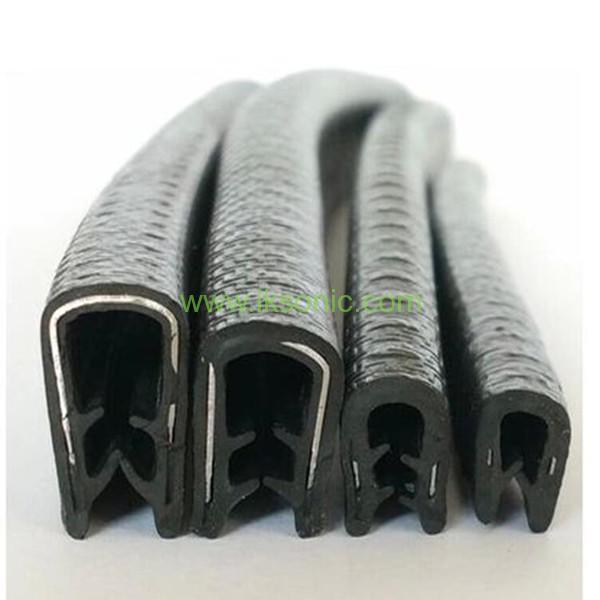

Sparky-(Admin) 25,935 #24 Posted November 5, 2019 22 hours ago, Lee1977 said: You can bolt the other side on. That raw edge looks dangerous. it would be worth it to do both sides as 953 nut said. I’m still unsure what I’ll do about the cut edges. Seriously considered installing a few strips of something like these. 3 Share this post Link to post Share on other sites
wallfish 20,219 #25 Posted November 5, 2019 If you don't like the look of covering the edges, you could hand file them fairly quickly to half round. Once they rust a little it will blend right in. 3 Share this post Link to post Share on other sites
