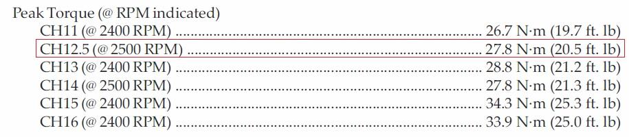

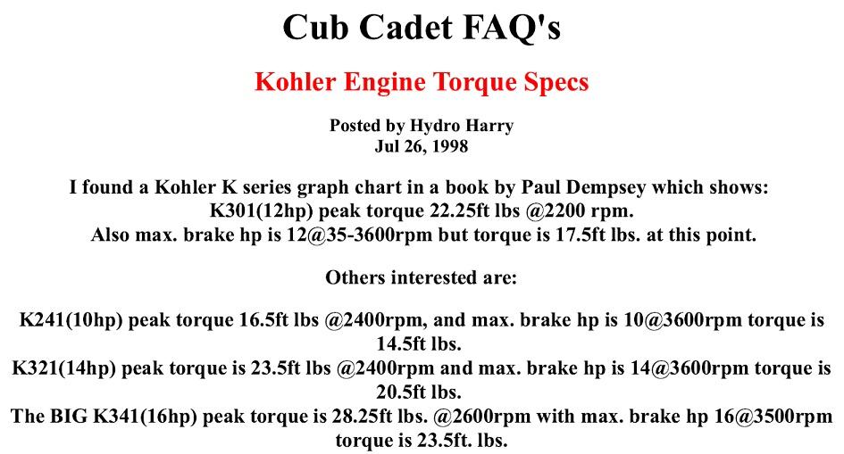

gwest_ca-(File Mod) 12,489 #4 Posted November 3, 2019 Can not find where Kohler ever published the engine torque values for the K-Series and M-Series of engines. Garry 2 1 Share this post Link to post Share on other sites
AHS 1,701 #5 Posted November 3, 2019 Ok! Pretty decent for jut a little motor. 👍 Share this post Link to post Share on other sites
953 nut 69,595 #6 Posted November 3, 2019 Torque is a function of Horse Power and RPMs. If the HP rating of both engines is honest they will have the same torque per HP at the same engine speed. Torque (lb.in) = 63,025 x Power (HP) / Speed (RPM) 2 Share this post Link to post Share on other sites

bds1984 1,519 #10 Posted November 3, 2019 I have had this same thought in my mind since I got my 315-8 a couple years ago and then stumbled across the same info above. I have a C165 and have yet to have ANY single cylinder come close to it in low-end grunt. However, I will give the nod to fuel efficiency to my 315-8 compared to my C165, that CH15 sips the fuel. Both are great engines and respectable to this day and will serve one well provided they are maintained accordingly. With the pressurized lubrication and ohv, I see no reason why the Command series wont enjoy a long run like the K-series! 3 Share this post Link to post Share on other sites
AHS 1,701 #11 Posted November 4, 2019 12 hours ago, bds1984 said: I have had this same thought in my mind since I got my 315-8 a couple years ago and then stumbled across the same info above. I have a C165 and have yet to have ANY single cylinder come close to it in low-end grunt. However, I will give the nod to fuel efficiency to my 315-8 compared to my C165, that CH15 sips the fuel. Both are great engines and respectable to this day and will serve one well provided they are maintained accordingly. With the pressurized lubrication and ohv, I see no reason why the Command series wont enjoy a long run like the K-series! You hit the nail on the head!! The 2000 312-8 with the command; with pressurized lubrication and an oil filter! @bds1984. I can’t wait to build a C-160-8! Ahem.. @ebinmaine Share this post Link to post Share on other sites
