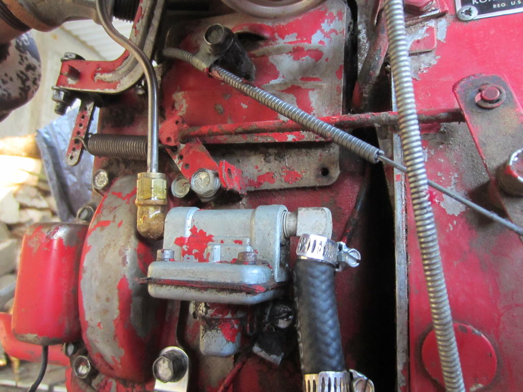

Herder 2,356 #5 Posted October 31, 2019 Here are some pics of carb and linkage on a few of my k-series. I posted them before as reference points. Hope it helps. this pic (Above) shows the throttle cable connection to the linkage. I can effect RPM 3 2 Share this post Link to post Share on other sites
FAST 87 #6 Posted October 31, 2019 Wow thanks so much for those photos. I was searching google just a few minutes ago looking for pictures of the front of the motor. Thanks so much 2 Share this post Link to post Share on other sites

stevasaurus 23,705 #12 Posted November 1, 2019 In @Herder 's 2nd, 3rd & 5th picture, you can change the length of pull or push on your lever by moving the cable through that clamp a bit...it does not take too much to change that. That can also effect the hi and low RPM's. Leave the screw that tightens the actual wire where it is when you adjust the outer sleeve in the clamp. If you find your points are set at .020, try setting them at .018 and see if that helps the tap tap. 1 Share this post Link to post Share on other sites
